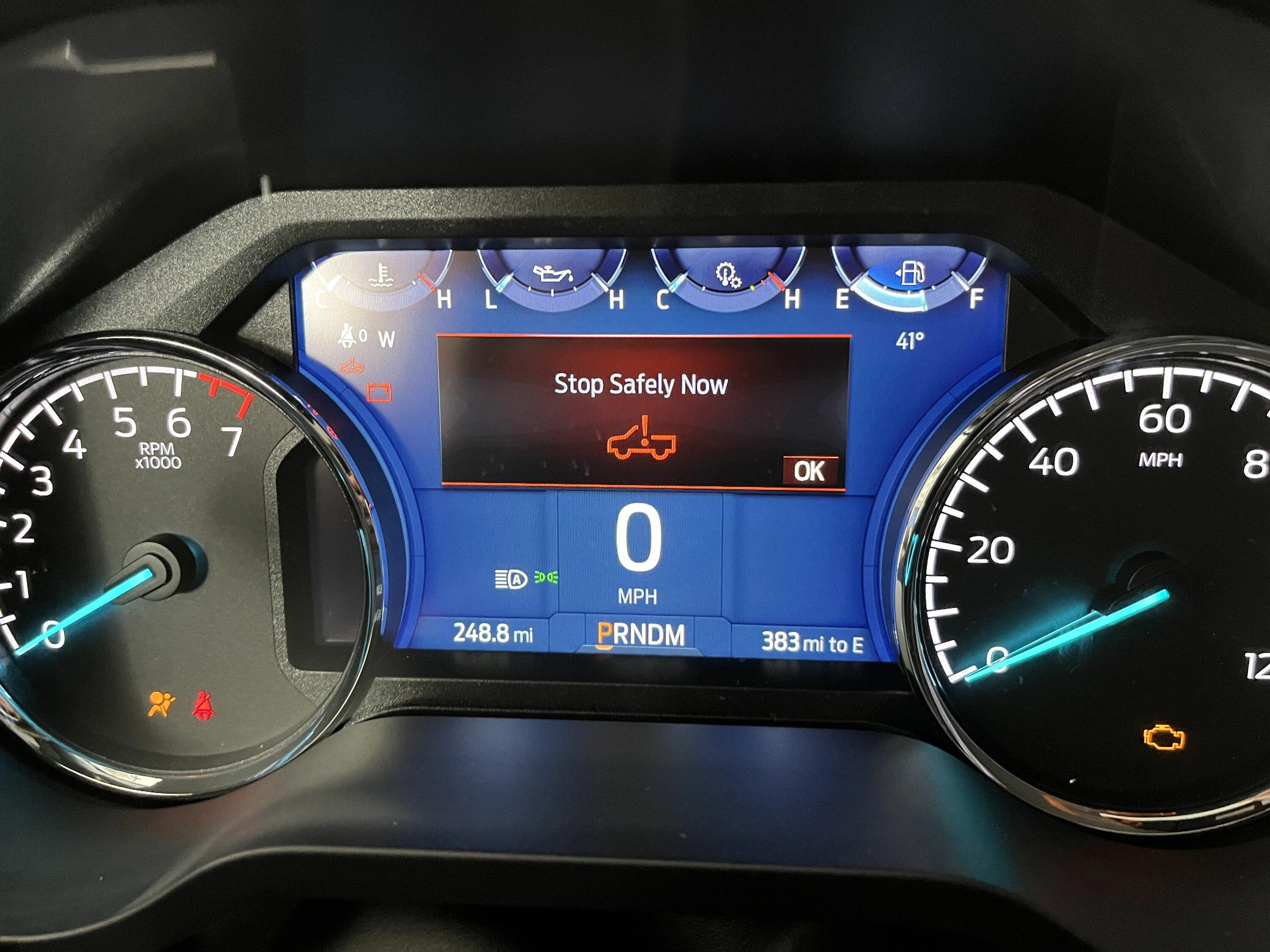

I’m getting this message this morning. 200 miles on the ODO. Ugh.

What's the voltage on your 12V battery?
no clicking. I just don’t get the “ready”.
Did you push the gas pedal? You have to push the gas pedal to start it if it says ready, or put it in drive. Try remote starting it.

Remote start wouldn’t work. Pressing pedals wouldn’t work. Disconnecting battery for 30 seconds didn’t work. Disconnecting battery for 10 minutes did work.
trying to find volt meter.

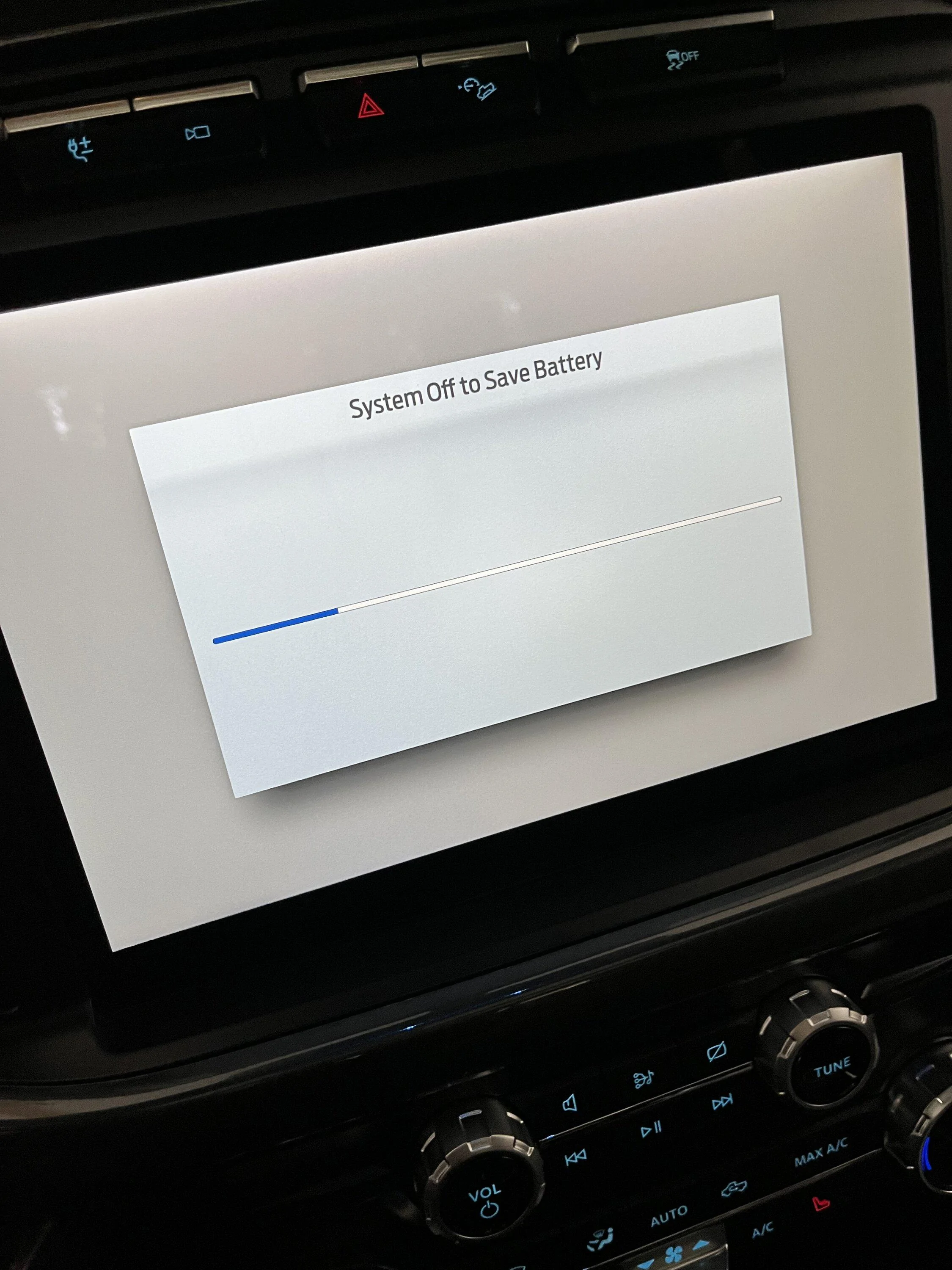

Drove for half an after after it wouldn’t start. Now when I open the door I don’t get that 75 Years welcome screen automatically and when I shut it off, I get this. I also got a message from Ford Pass saying features are disabled to preserve battery.
is one of my batteries shot?
Ford F-150 Brand new PB won’t start 36E41BC8-6007-43D6-B90F-EB26795C7AF8
No, you need to charge your batts (they're connected). My unfiltered opinion of the AGMs and their charge strategy is that it sucks balls.
charge them how? Driving? Or an actual charger? Half an hour of driving here and there won’t keep this thing charged?
im at the dealer now. Really bummed about my first Ford and under 300 miles on it.
Battery charger. Driving doesn't do much to charge them. It's why I've put the LFP aux batt in mine. Got tired of the flaws the AGM has.
