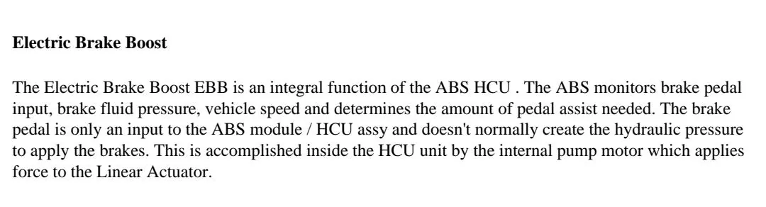

I found this regarding the Powerboost brakes. It implies that our brake pedal is brake-by-wire, similar to our throttle. In other words, our pedal doesn't actually create brake fluid pressure, but rather sends a signal to the monitoring system what our pressure/travel of the brake pedal is and then the ABS system applies the actual hydraulic pressure.
Again, I'd get your truck looked at. So your gauge cluster doesn't show any warning lights when the truck lurches and then stops again? I wonder if your truck has codes stored as a result?
