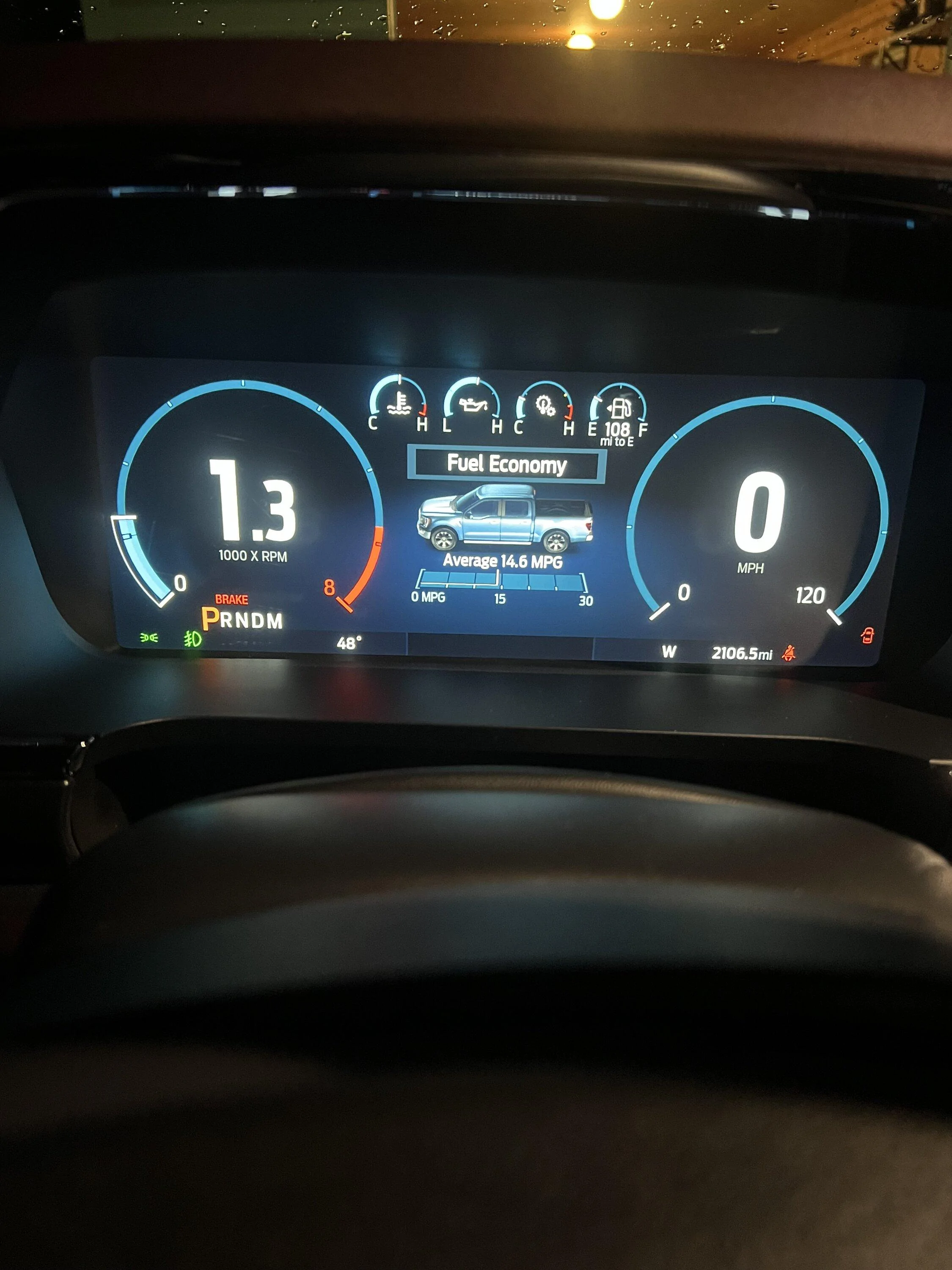

After my 10hr shift, I let it re learn. Light was on I engaged the parking brake, released it and the light shut off. And zero battery notifications from the SOC thanks for all the help fellas

I have a 2023 ford f150 with the 5.0, right at 2100 miles and my emergency brake light is on and won’t shut off. I’ve disconnected the battery and it doesn’t reset it. Engaging it and disengage still works. Just the light stays on. Then says 12 v battery state of charge low
Hello Travis! Are you still experiencing this concern? If so, I would like to look into it on my end. Please send over a private message with your VIN and the name/location of your local Ford dealer to get started.

I got it to shut off but if it happens again I’ll definitely be giving you my information
