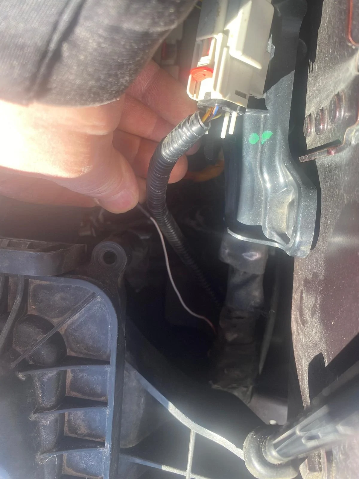

a small work around to get BRAKE lights
is to use the customer access wire under the hood, just below the air box for the air filter, its used to power the chmsl for toppers and does not change truck settings or tell truck something is different and is only powered if truck is ON or running
i found out while wiring up my topper recently and a guy on here had found the wire that is pretty obscure in literature at ford body builder website
the wire is a small gauge tucked and folded on a harness right next to the fender, near the bolts that hold the air box to the fender on drivers side

I found this wire, but can't get it to work, even with truck running I don't get anything when pressing the brake pedal.
this is strange
i am not sure which fuse powers it, as its cryptic in the body builder book
