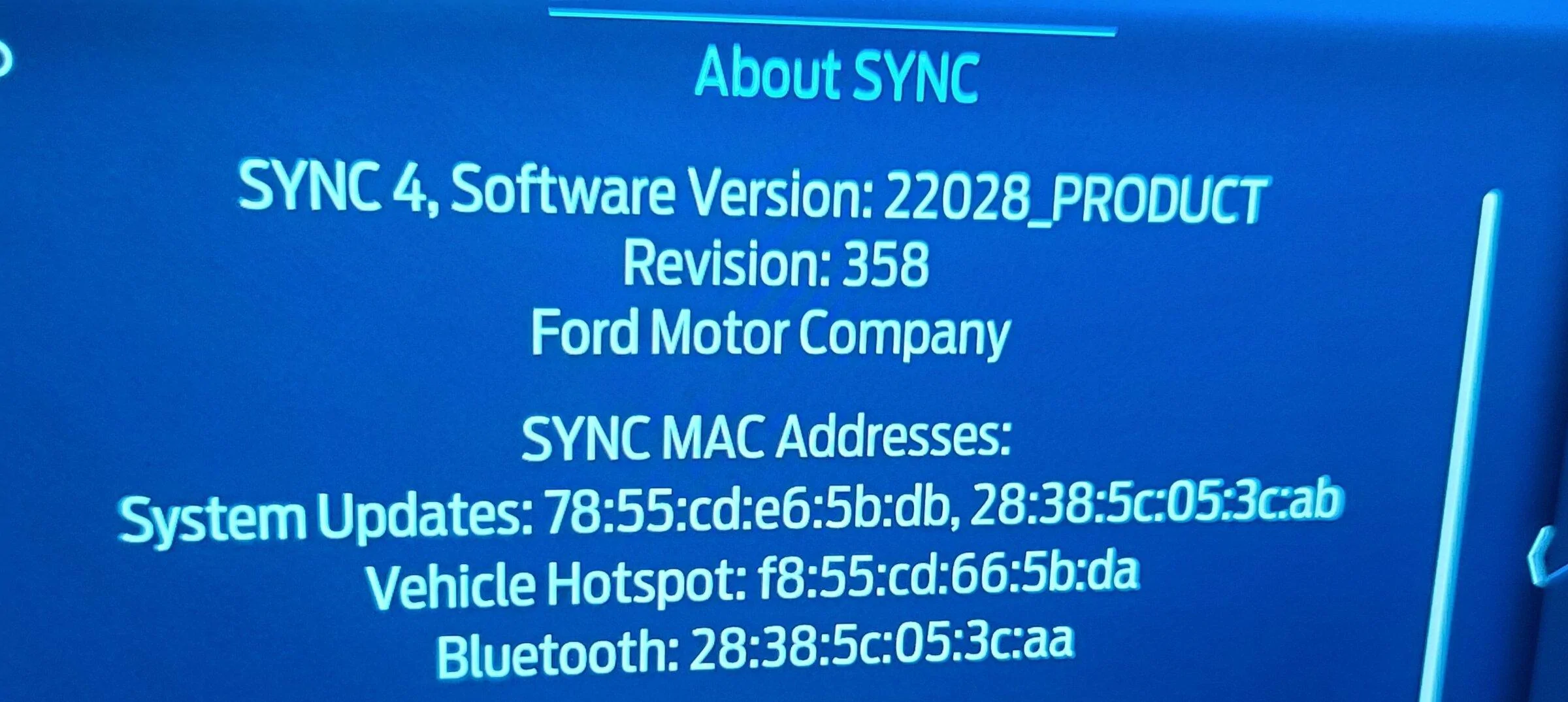

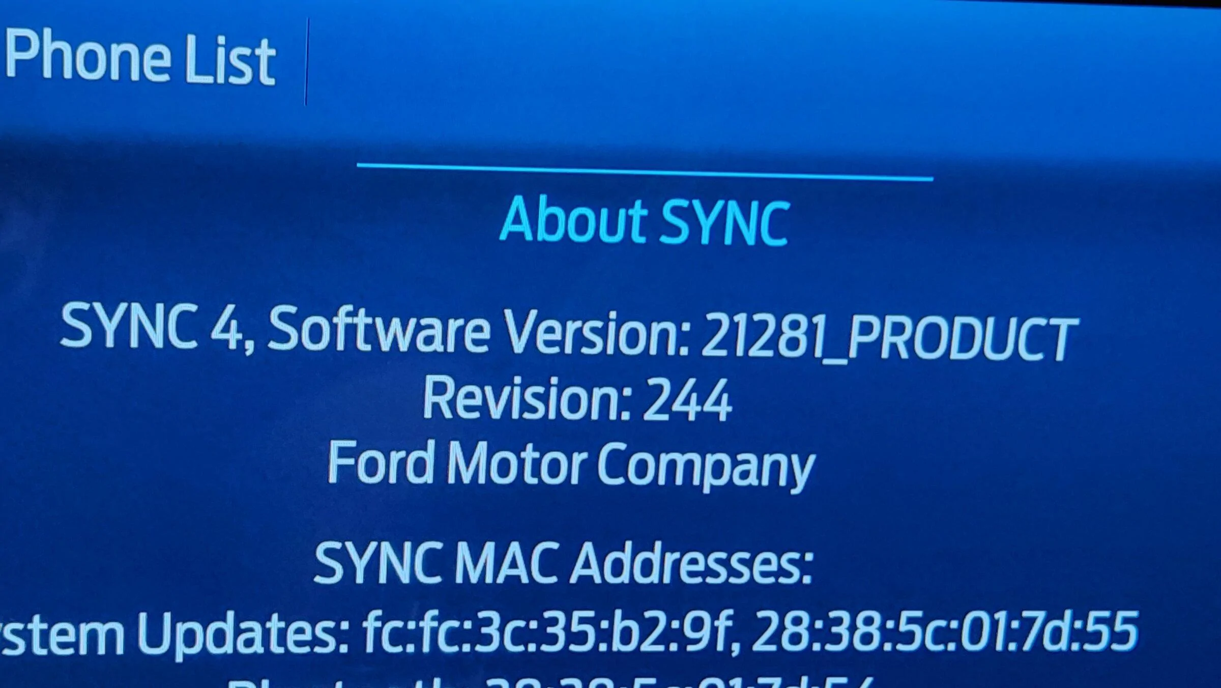

So this is where I am at, picked it up today, updated at the dealer. But it did say bluecruise active when I tried it but the traffic and rain was so bad I gave up and headed back home when I tried it. It was never able to find the lines on the road and traffic was bumper to bumper. I will try next week.

I would be surprised if you have Bluecruise active.
I think your next APIM update will get you to
Ford F-150 Bluecruise OTA Status? 20220422_195650
Then the next one, the one included in the Bluecruise package of updates that include APIM, CCM, IPMA, and I believe IPC or PSCM, will get you Bluecruise and cameras at speed
Which would be
