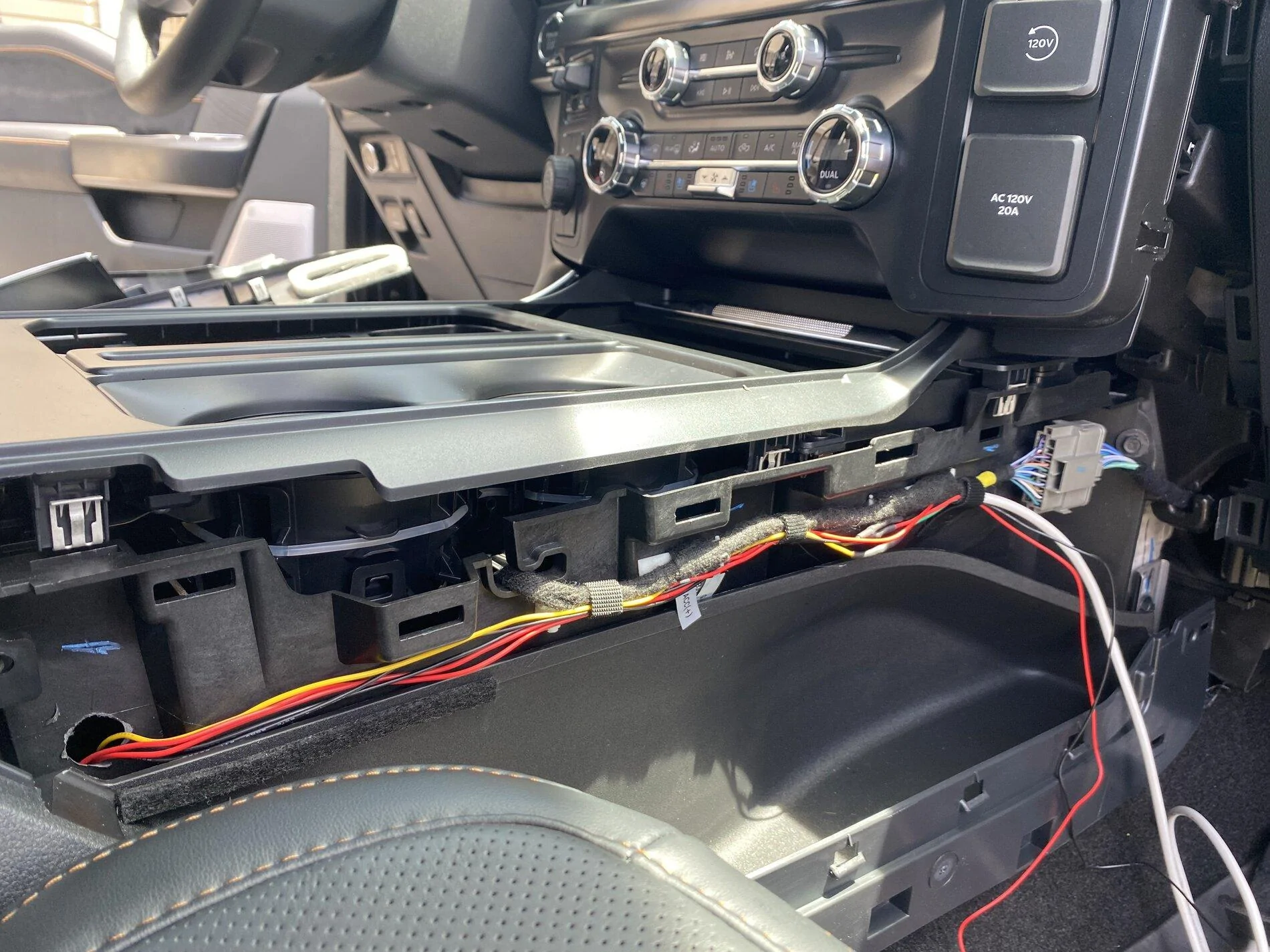

Once we've got the PMP connector inside of the center console storage area, it's time to secure the cable to the existing wiring harness that's hidden behind the passenger trim.
Take it from an IT guy... ALWAYS VELCRO... NEVER ZIP TIES... Seriously... if you don't have a big spool of this stuff, go get some now. You'll thank me in the end... https://amzn.to/3qDE5Rn
You may have also noticed that there's some added cable to the PMP harness. This is because I want the PMP in an easy to reach area, and the harness has a short 2 ft of cable. I used the following cable to extend the power runs and it's fantastic. https://amzn.to/3vRoiPK
I solder all of my connections and then heat shrink them. If you don't have a soldering iron currently I can highly recommend any TS100 based soldering iron which has open source upgradable firmware (GitHub - Ralim/IronOS: Open Source Soldering Iron firmware for Miniware and Pinecil)...

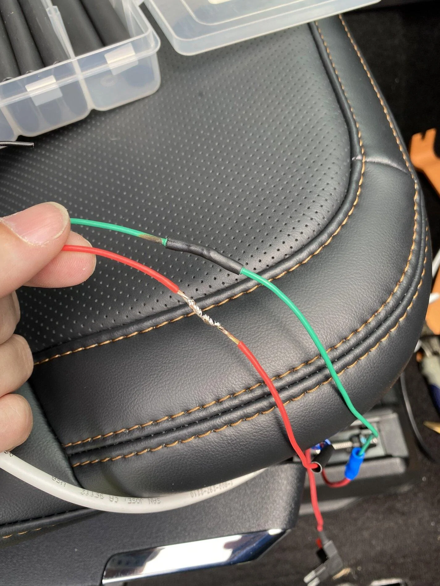

Now it's time to solder the add-a-fuse (micro2) adapters to the extension cable we soldered to the PMP wiring harness.
There are cheap Chinese fuse taps, but for anything electrical like this I much prefer to pay for a brand I know... https://amzn.to/3dk5ySr
I used the following color coding to wire everything up...
NOTE: I had to cut my original setup out of my jeep, the above is just an example of how you should be soldering, and heat shrinking your connections.

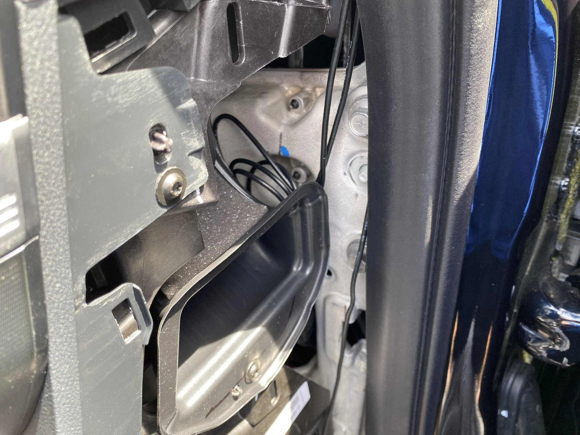

Before we get too far, let's mount our front camera and our rear camera. You'll want to do this first because it's easier to hide the additional bulk cable behind trim pieces as opposed to near the cameras or in the headliner.
Run your cables along the normal places, behind the rear view mirror, the headliner, and the weather stripping on the doors. In order to make it easier for you to get down the passenger door, remove the panel that's hidden behind the passenger door when it's closed.
Plug the dashcam power adapter in to the PMP's receptacle on the harness and bunch it up and secure it to the existing wiring harness, being mindful to make sure it's tight and that it's not going to contact anything and make a noise when you're driving.
At this point I connected the rear dashcam and ran it's cable along the passenger side of the cab. Because I have a sliding rear window, I opted to place the camera as close as I could to the center of the vehicle, while still being able to remove the cable, and the camera from it's mount in the event I needed to replace it for any reason.
I then ran the rear camera's cable to the main unit, then ran the excess down the passenger side A-pillar, and bunched the excess behind the panel we removed originally.
After all this cable running, there should be 3 cables running down the passenger A-pillar, if you take your time, everything will be flat and you won't have any buldges in the door weatherstripping.
We're done working inside of this panel. Go ahead and close her up!
| Blackvue PMP Harness Color | LED 3 wire cable color | Function |
| Black | Black | Ground |
| Red | Red | Accessory Power |
| Yellow | Green | Constant Battery |

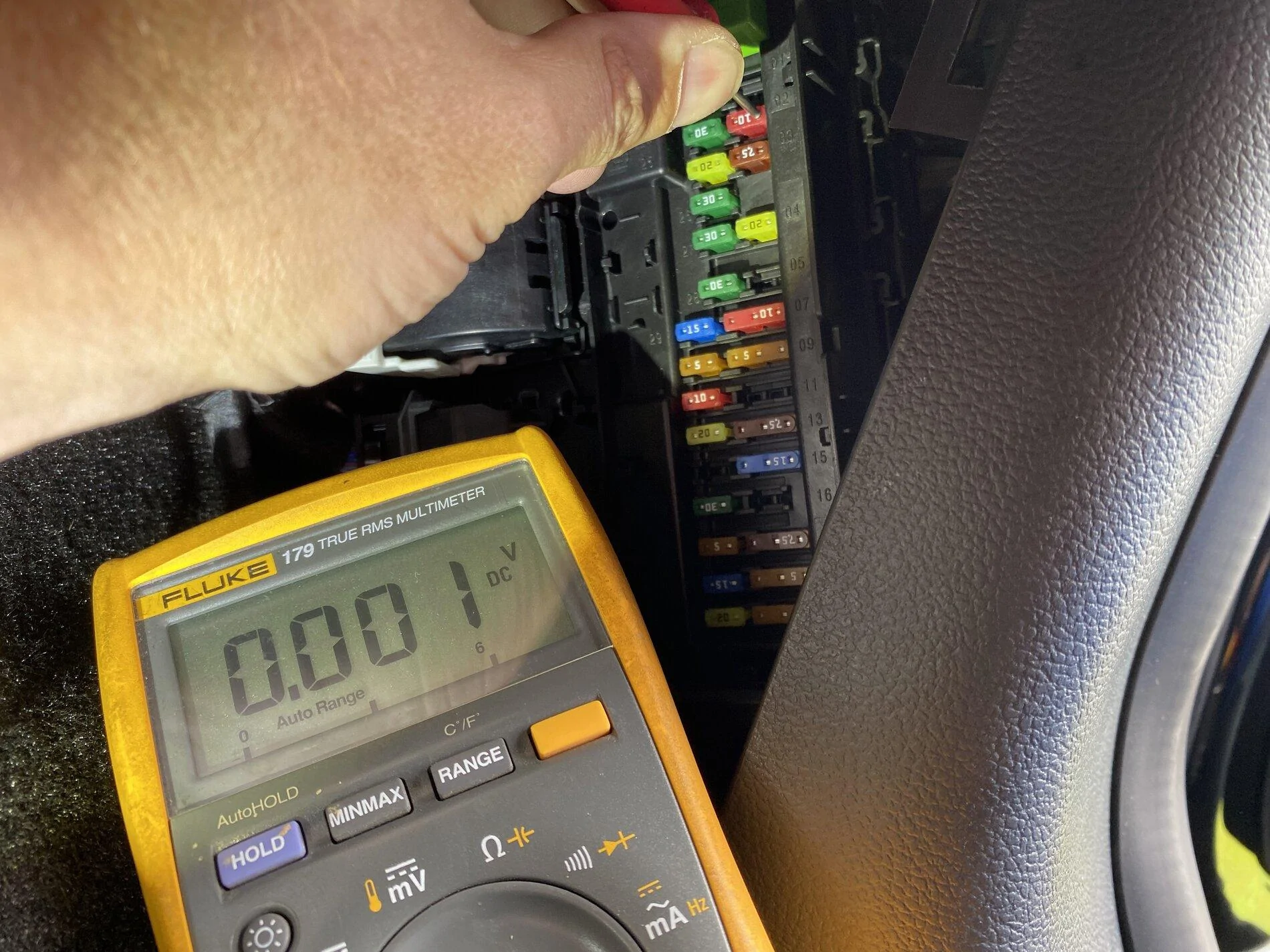

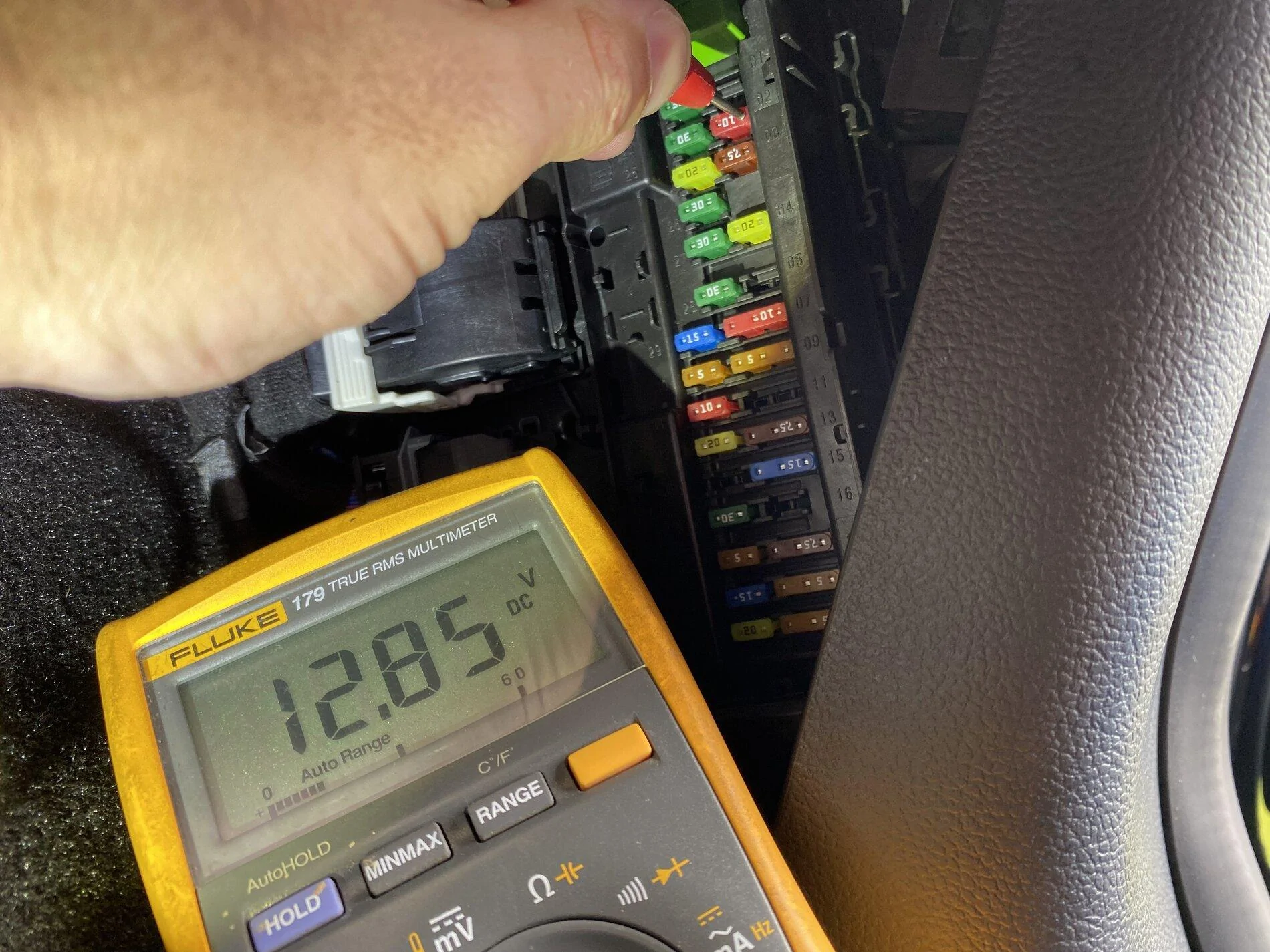

Now it's time to find our fuses... As mentioned before, we need 1 that's powered even when the truck is off, and another that's powered ONLY when the truck is on.
| Fuse Number | BCM Fuse Function | Fuse Amperage | PMP Supply | PMP Harness Wire Color |
| Fuse #2 | Delayed Accessory | 10A | Accessory | Red |
| Fuse #4 | Not Used | 20A | Constant 12v | Yellow |
The below pictures show my testing on the two fuses I've selected for this install.
| FUSE 4 (VEHICLE OFF) |
| FUSE 2 (VEHICLE OFF) |
| FUSE 2 (VEHICLE ON) |
Remove the target fuses, and ensure they are inserted on the BOTTOM (closest to the leads) of your add-a-fuse. The fuse for your camera should be at the TOP of the add-a-fuse (closest to you when inserted).
