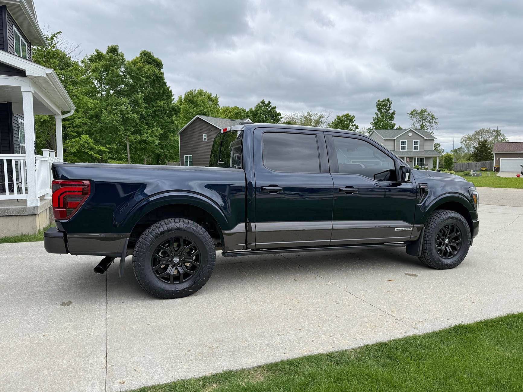

Well got them in! Love the look with reverse level. So far they drive great! I was concerned the +34 offset wouldn’t be enough replacing a 305/45r22 with +20 but it is really nice. Outside edge of rear sits perfectly flush with the fender. Not set back, no poke.

Excellent color!
Can you tell me, are these r18 wheels?
How does it feel after r22 wheels? Is it getting better or worse?

Excellent color!
Yes these are 18’s. The ride is better for sure. The 22’s almost made the truck bouncier if that makes sense. I assume as it absorbed less of the impact and transferred to the suspension. They were also 10lbs heavier per wheel which also makes a difference. Now turn in and cornering is no where near as good, again a byproduct of more sidewall. So far so good though!

Stunning truck! Very tasteful. I am reversed leveled as well, and have my Eibach's turned up ~ 3/4" at the front. Drives absolutely fantastic. I just hauled 1200 lbs of lumber and it squated but did not contact the bump stops. Point is if you want to get some of that sportier feel back then get some good dampers all around (Eibach/Bilstein etc).
Thank you! I like the OEM+ look, 98% of people think that’s the way it came from the factory, but that extra small percent knows!
This has ccd so I can always switch back to sport to firm it up a little. You can just tell at no fault of the suspension, that the tire rolls over a lot more. Not complaining at all, just change in dynamics.

Nice, where did you find black Tremor 18's?

Looks good. Does it have a lift / level? Been looking at raptor or tremor wheels. Like the the look for the 18's
No lift or front level. Actually pulled the rear blocks out to drop the back a little.
Thank you! I have been very happy. The tires do seem to hunt the road more than I was expecting, especially on the highway but over all very happy.
