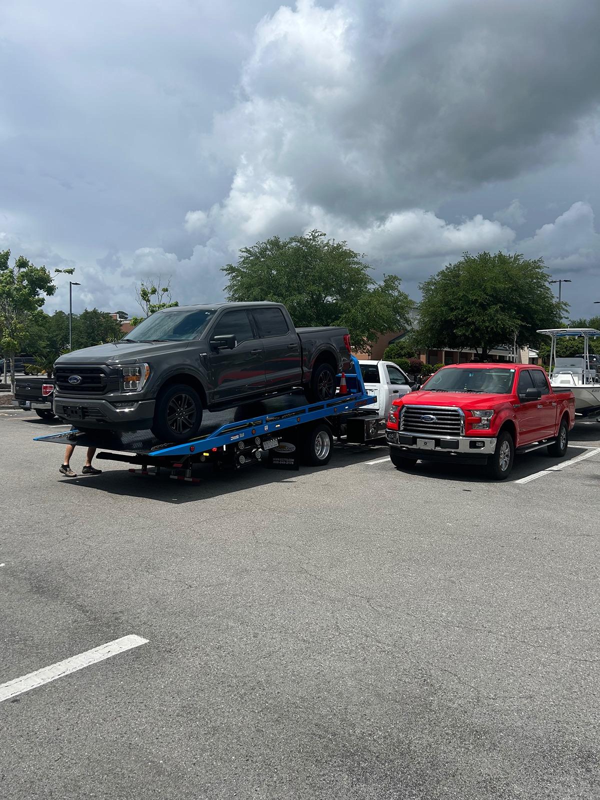

4/12/24: I get an auto sw update specifically for gateway module
- that same day my truck won't start
- I disconnect battery for 20 min reset and it fires right up
- I have an appt for 5/2 to fix recall for wiper blades
- it dies in a parking lot on 5/1 so I have it towed to local Ford dealer
They call me today to tell me the ABS module is shot and the repair is $2400 but can offer no clarity as to what actually happened to the ABS for it to be fried . . . FRIED.
2021 Ford with 42k miles on it so 6k outside warranty
Everyone seems to gloss over the fact that my truck died the same day they pushed the module sw and I called so it's on file.
I have Ford tech team involved but I've never been more infuriated at a vehicle situation in my life. If they hadn't pushed a sw update - you'd be hearing nothing from me but the fact they won't acknowledge it really irritates me.
I had Ford tech team elevate it to next level and will get a call in 24 to 48 hours.
My unqualified advice is turn your auto updates off.
I'll keep you posted - wondering if anyone else has had a bad sw update.
