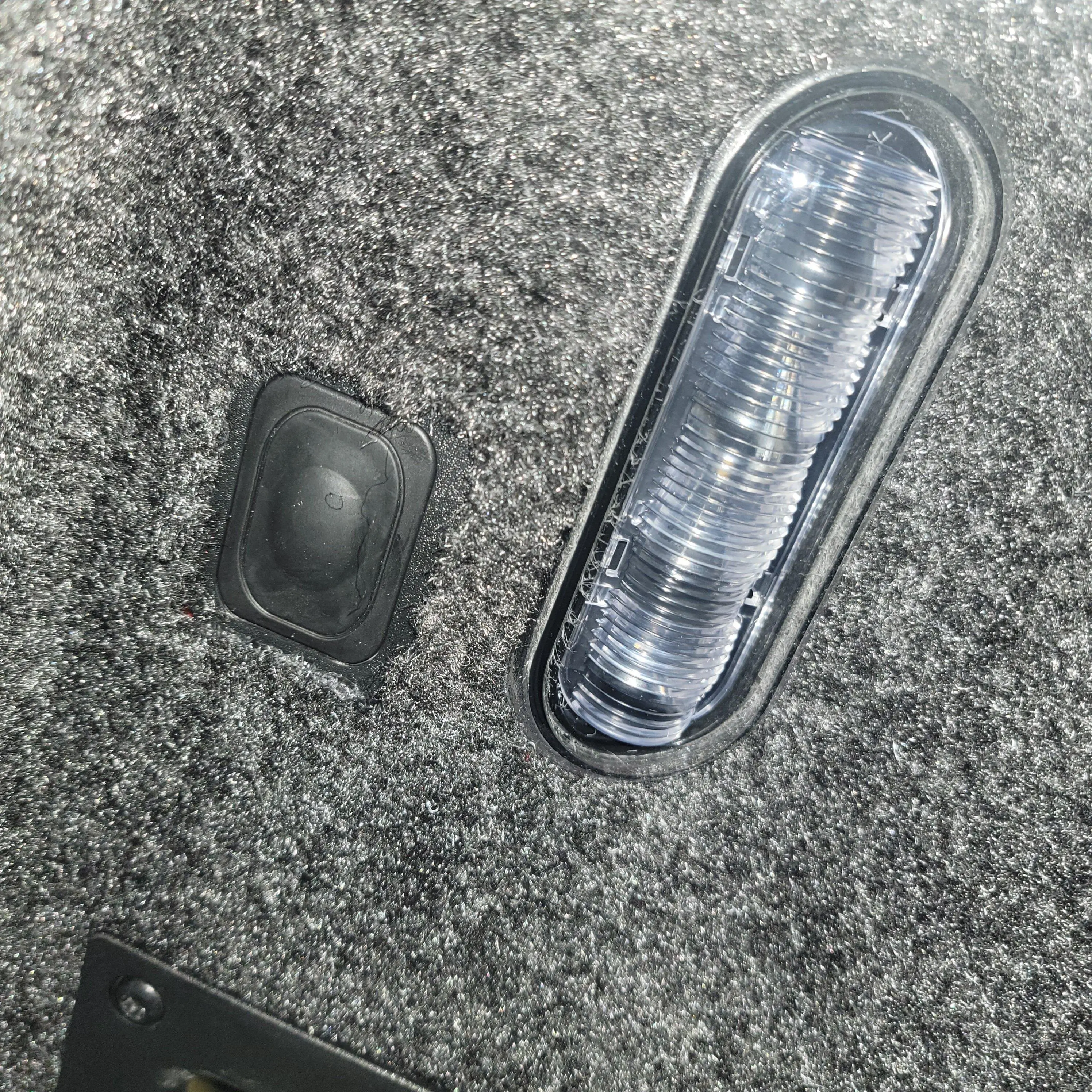

nice. really nice job around the lights. I assume you left enough flaps of carpet to fit under the light... the light clips were able to still grab the bed even with the carpet?

Yes, The light I had to slowly trim the carpet at the top and bottom till it clipped in. The switch was harder since it's tighter to the bed. It clips on the sides and would not snap in untill I cut all the carpet away except at the top and bottom were it just barly covers.

very nice... well worth the effort as it looks awesome
