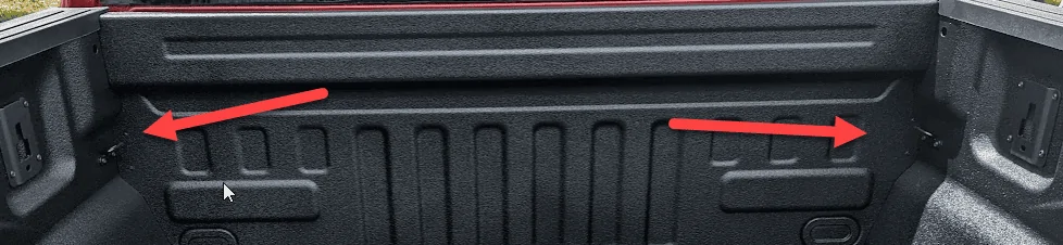

You dont' have the 2 at the end of the bed? It's hard to see them with my black bed liner, but I have 4 (not box link). Two in the front 2 in the back, but the 2 in the back are a bit higher

closer look at the one on the passenger side
Exactly what I have however, would like to have the 2 next to cab mounted lower.

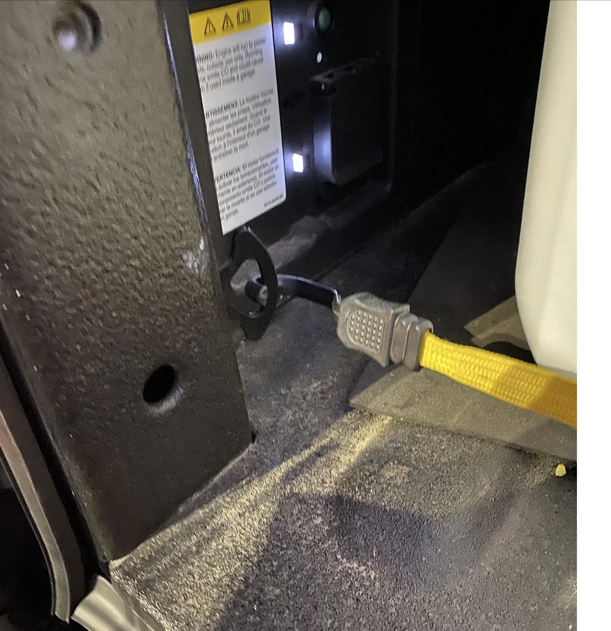

Factory tie downs on my 21 KR, with 6.5 bed , if that makes a difference
Ford F-150 Bed Tie Downs B9040C96-B2A8-44C9-8D0E-2ED81ECD2D88
