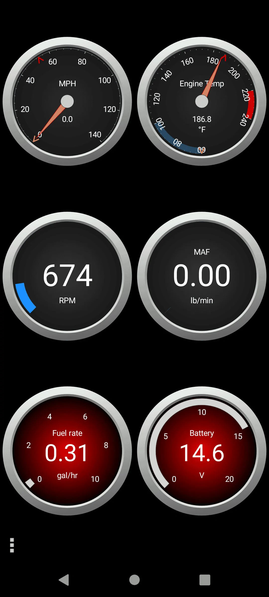

Thanks. I have the adapter and I installed the app. Here is a picture of my SOC (14.6v) in the bottom right. I haven't configured the app yet.
My 2021 Job 1 2.7 EB has always ran at this voltage. I mostly city commute in my truck. Never had battery issues. No idea why some trucks kill the voltage at 13 volts and other run 14.6 volts like mine.
Snakebitten, am I looking at the correct PID?

Your screen is showing battery voltage, you'll need to add another gauge for SOC. I think it's under vehicle specific/ bcm/ soc
