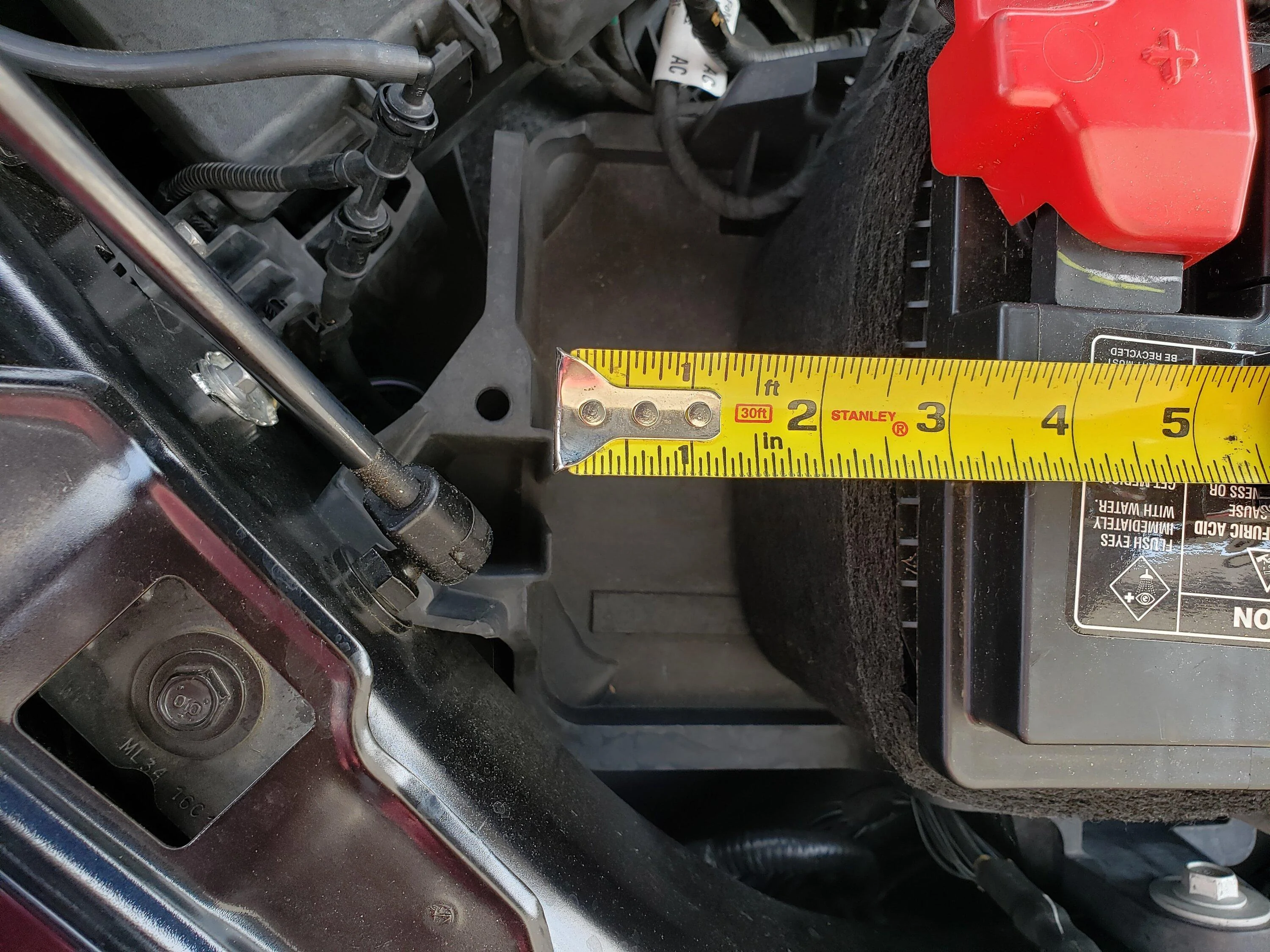

So I took a look under the hood of my truck this afternoon. I must have gotten the most stripped down Lariat they ever made! Lol, no modules in the battery box, the smallest battery they could supply, and not even the small battery under the back seat!
The good news is that I have an additional 3 inches on one side , plus an additional 3/4" on the other side. So I definitely have room to put the H8 under my hood. Although I may have to separate the wrapping on the positive harness slightly to spread the cables far enough.
For comparison, this is what it looks like in a ‘21 Lariat 502a Powerboost. Because there is more than a battery in the battery tray, upgrading from an H7 to an H8 would be tough. There are certainly advantages to the simplicity of your configuration.

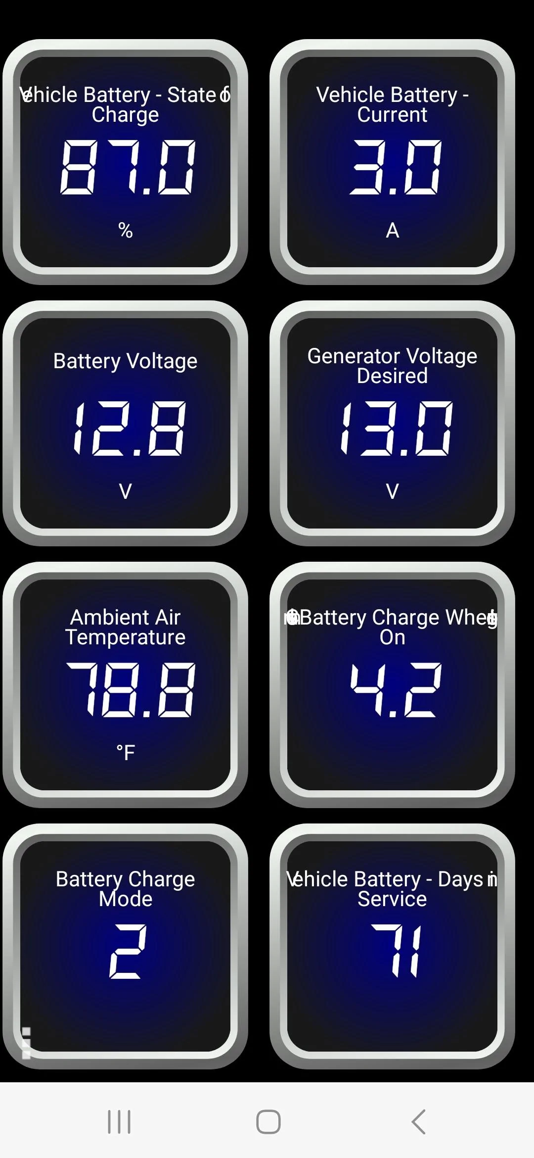

The battery I have when I try to use the reset for SOC it never gets above 75%.
Lot of updates Ford wants 80%. Even when using FDRS. I just overrode it and installed anyway but maybe will be issue for future OTA updates. ?‍♂
I set my SOC level to 90% in forscan, although this didn't help with the first 2 batteries in the truck it seems to have made a difference with the H8 I installed.

Good idea, I'll have to see if I can get SOC display on my app.
