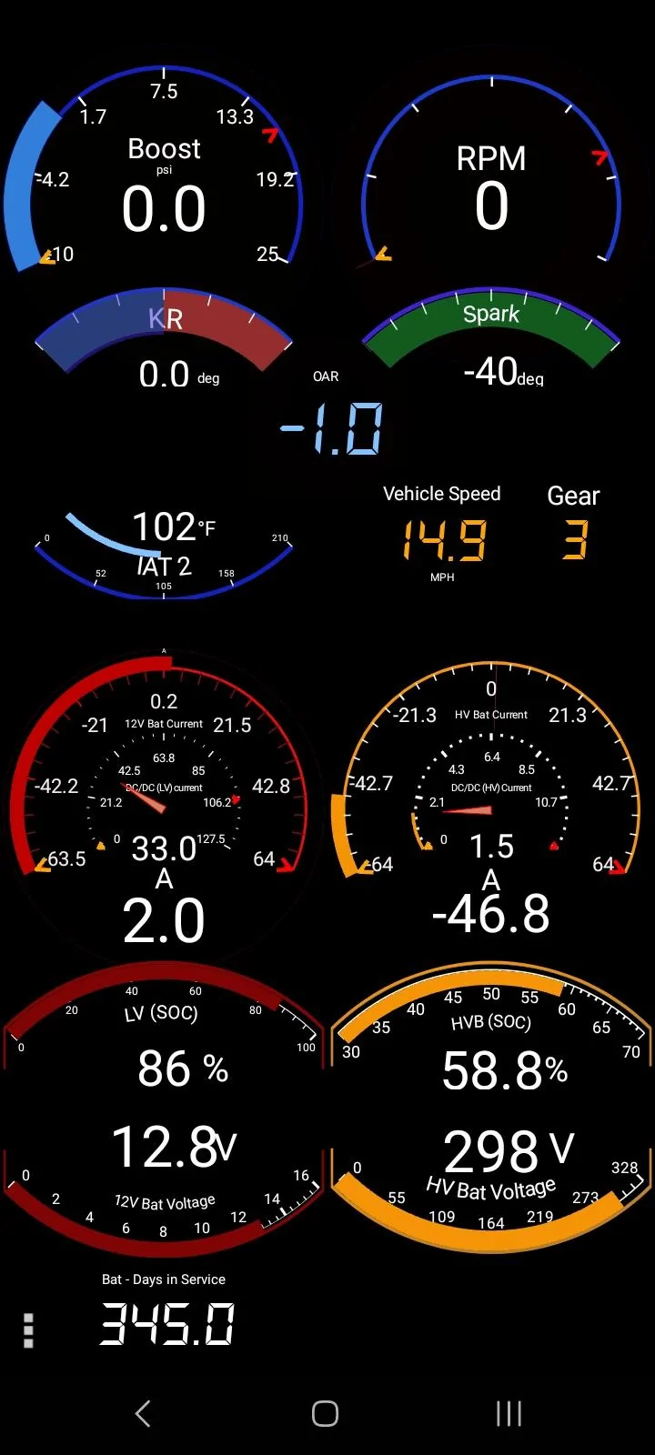

I have my new 2022 F 150 Powerboost and would like to know if there is a gauge option for the battery level. I think it would be nice to have the information as to how much that battery is charged.
OBDLink MX+ adapter
OBDLink app on smartphone
User built "dashboard" with gauges that monitor the PIDs that I desire for the Powerboost.
Top half is ICE related, bottom half is electrification monitoring
Ford F-150 Battery level on a powerboost Screenshot_20230322_091351

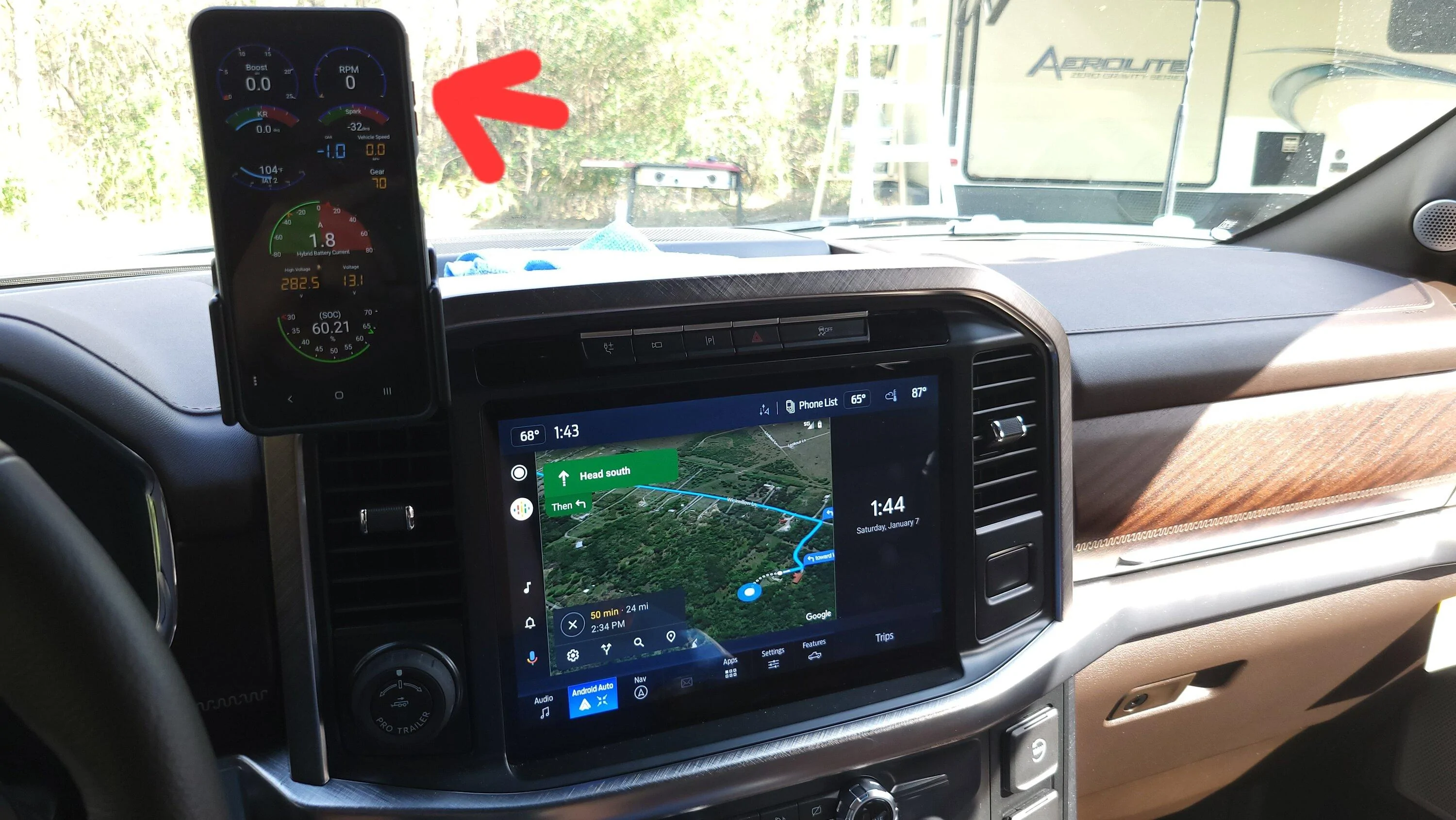

Mounted in a dedicated Sim-less Android phone. (my personal smartphone is not required)
Ford F-150 Battery level on a powerboost 20230117_105555
