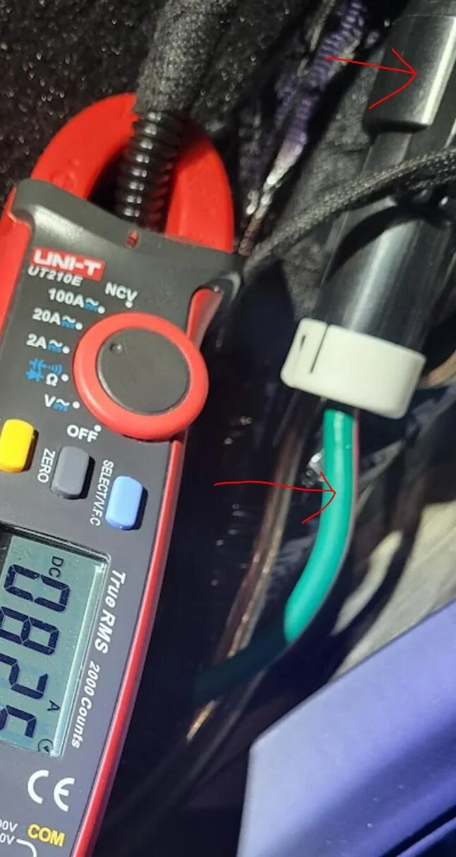

Anyone know where the powerboost battery disconnect is at? I unplugged the main battery under the hood, but the truck is still on.

I'm no authority there, but I don't believe you need to disconnect the HVB for that.
There is another 12v battery under the rear passenger seat that will still provide 12v power, even if the main 12v is disconnected.
You can also disconnect the aux battery in the front passenger kick panel. Green cable w/ red line 4ga cable, pop the red tab and disconnect the cable. Can't miss it.
