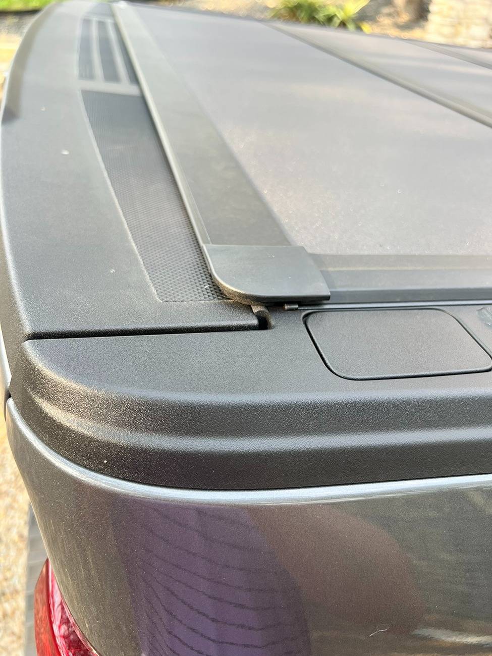

I think you can slide yours back 1/4" or so. As long as the seal was placed on the very edge of the front of the bed you shouldn't have a leak issue up there. For context, here are some pics of how I have mine set. No leaks at the front of the bed. I do get a little bit of water around the tailgate when I go through the car wash but it's not bad.

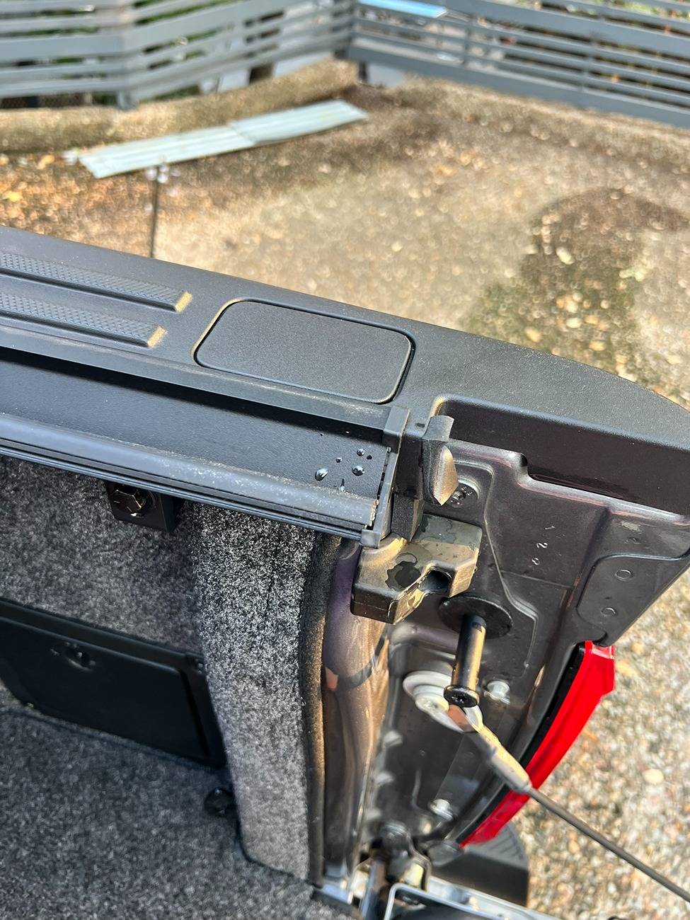

I used this kit from Amazon: https://www.amazon.com/dp/B085896S8R
I put the weather stripping on both outer edges of the tailgate, the exterior of the left side of the PAT "door", and both the inside & outside of the right side of the PAT "door".

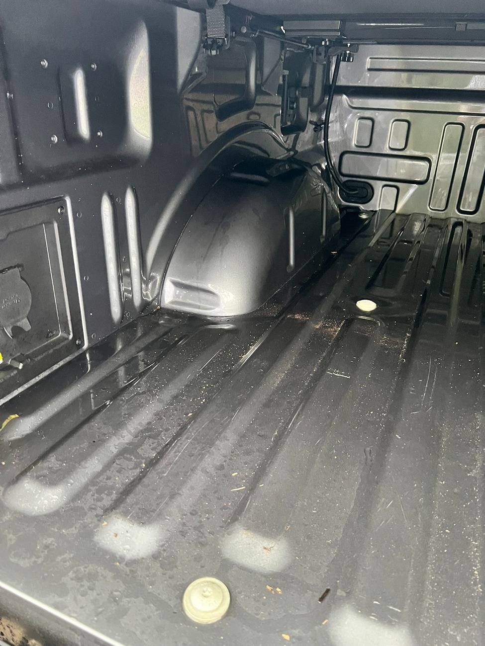

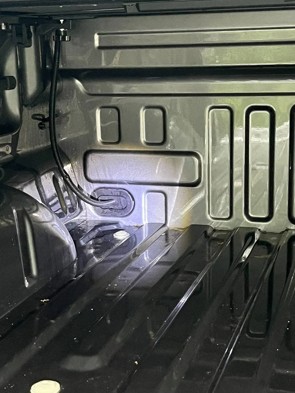

I just finished installing my bedrug the other day. It hasn't rained here in a while. last time it rained, I got water in the bed. I have the BAKFlip MX4. I'm surprised so much water got in over the wheel wells. See images below. I put some foam tape at the front where i found gaps, and some at the rear. I'll see how that does.
I'm about go out and wash the truck. I'll report back how it does.
