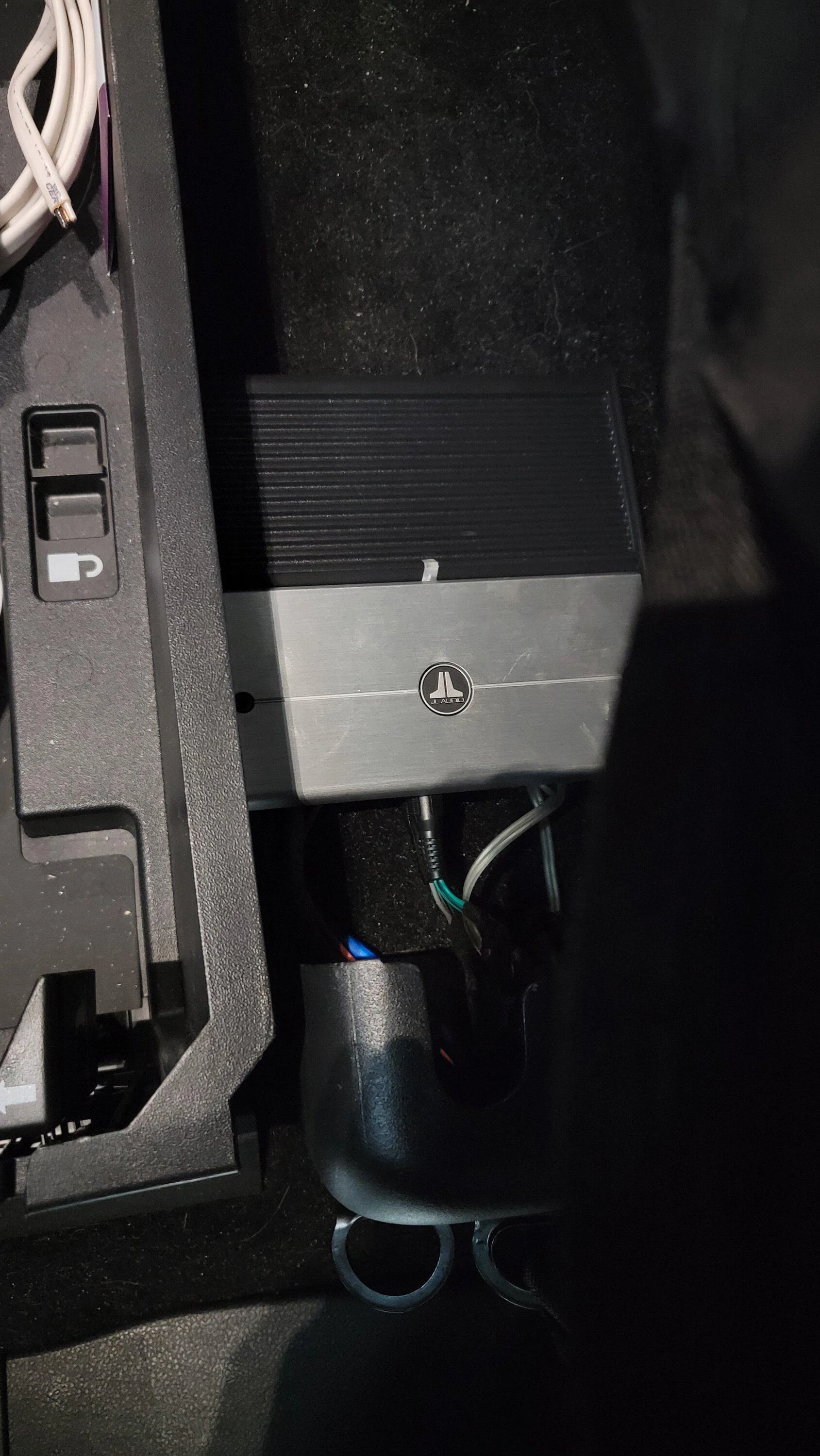

I finally have all the bits and pieces to install the JL amp and 2 6 3/4 Kicker speakers in my rear doors for my B&O Unleashed. (Thank you all)
One more question...... Crutchfield mentions that I'll need to trim the inside of my speaker grills (OEM door grills?) for the speakers to fit?
From the directions, I can tell that there'll be some trim ring tab removal.
Did anybody need to trim the inside of the B&O speaker grill for the rear doors?
Between kids and eclipses, I hope to install this all in the next few days! lol
No need to trim anything on the stock speaker grills when adding the JL C2 650x speakers. They do require an adapter ring, which has some tabs on it that you need to remove.

One more question...... Crutchfield mentions that I'll need to trim the inside of my speaker grills (OEM door grills?) for the speakers to fit.
I'm not familiar with the kickers you are installing. But if it has a tall protrusion from the surface you may need to trim the grill. Crutchfield is about 99.9% on target of everything so if they say something has to be trimmed it probably does. Hopefully they have a video or a walk-through of what and where things need to be trimmed for those speakers.
@rpold150 He bought different speakers than what we used.
