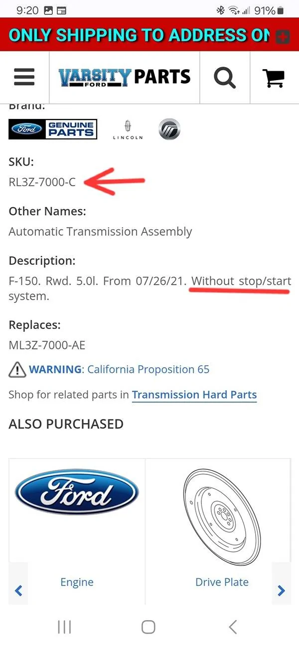

I'm relatively certain the transmission is missing some of the internals required for ASS. Most likely the pump, as a spare part isn't listed for the non ass trucks. If you go to the Ford parts site and look up the complete replacement transmission you'll find 2 part numbers, and in the fitment notes it clearly states for trucks w/ass and the other says for trucks w/o ass.

I don't have a complete parts list of both transmissions, it would be nice to compare the actual differences between the two. All of the wear items look to be the same. So in the case of all rebuild you'll be fine. I'd venture that the biggest differences are in the porting of the valve body and the transmission case itself. They've made so many trucks in both configurations at this point. I doubt there would be a problem in the future obtaining exact replacement parts for either.
