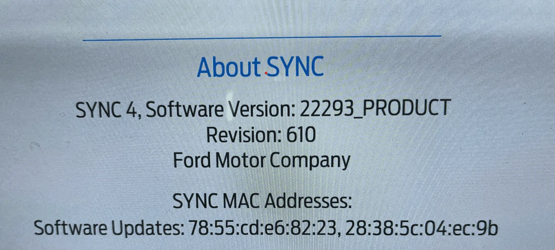

Attached is a screenshot of my sync version. Will that tell me what updates have been installed? if so, where can I find that info for future reference. Ford Pass does not show an update as a dealer did it for me today, at no charge.
My truck is a Job1 2021 Platinum

That's a fully uptodate Sync.
A 2021 at that Sync level is a healthy truck.
I thank you in advance and wish you all a great weekend!!
Fredm2002
Sync 22293 comes with Power Up update 3.5.3. Next week, we will have a thread here showing all Power Up & Priority updates. Normally, you cannot rely on your Sync version to dictate what is the latest power up update you have received, as only an APIM update will change your Sync version. Meaning, you can get several OTA's and your Sync version will remain unchanged.
