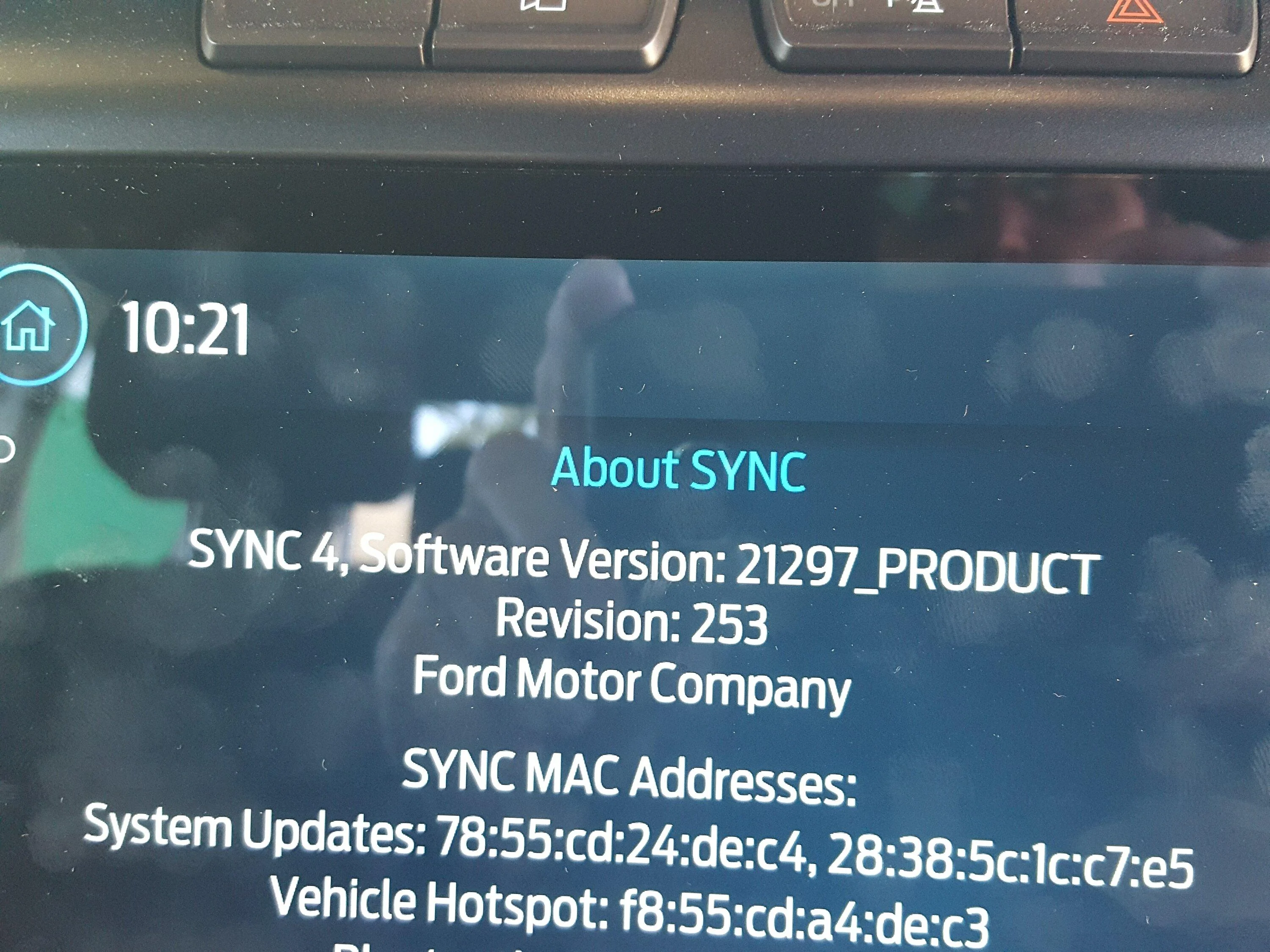

I received the sept 2022 updates and was able to enable the unreal engine stuff, minus the heritage screen
i was looking at a pic i took in may of my sync version then looked at my oct pic of sync version
why are they the same? 1st pic is from MAY 2022, 2nd is from Oct 2022
inst our sync version supposed to change with updates? or am i confused, ...which could also be a possibility

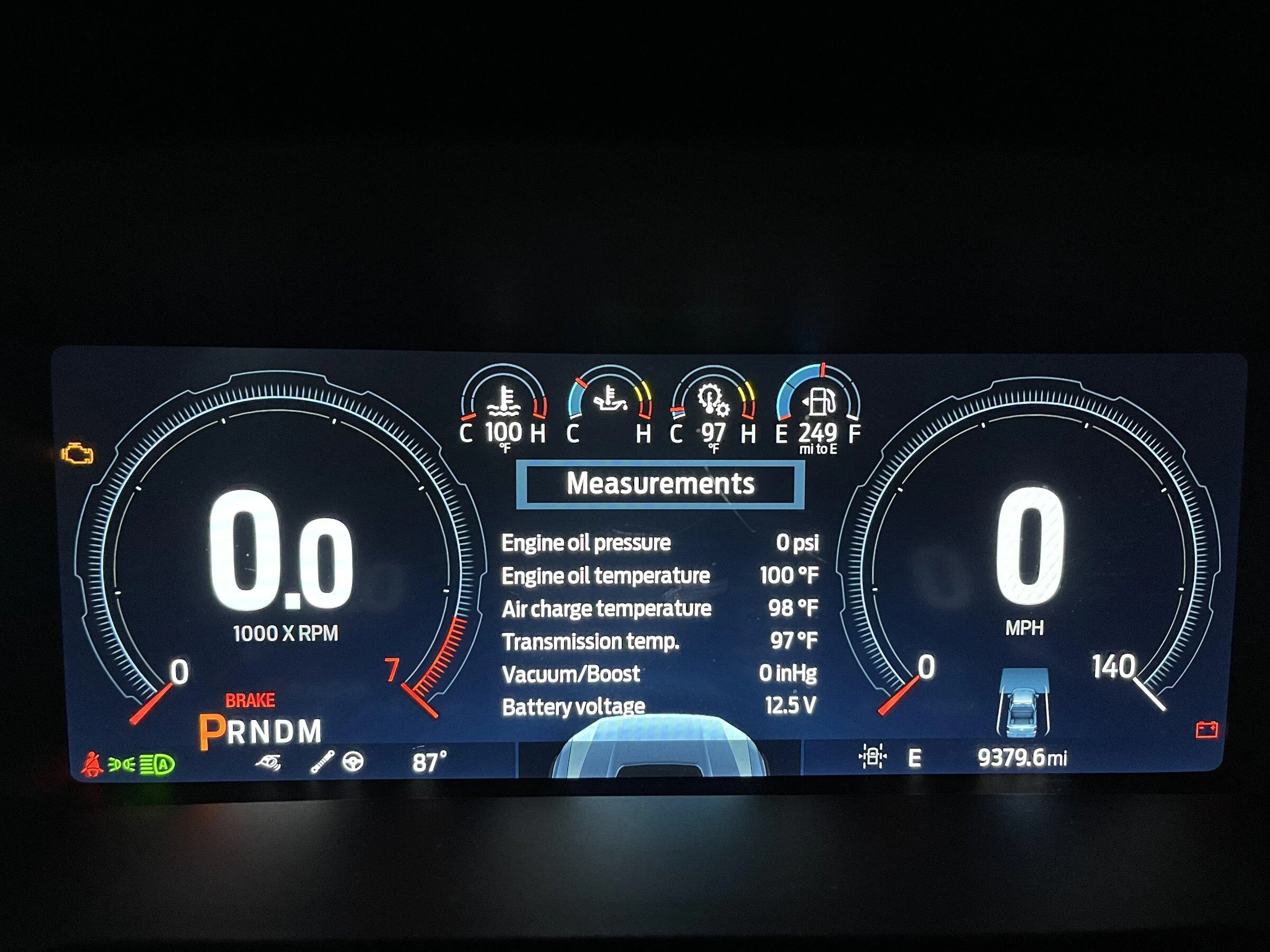

and.....with the new unreal engine,, is it possbible to get the oil temps, and pressures and other neat stuff shown here in the raptor screen

..... with the new unreal engine,, is it possible to get the oil temps, and pressures and other neat stuff shown here in the raptor screen
Methinks the Unreal Theme enable in APIM is unrelated to IPC capabilities, but I'll follow this thread just in case .... ;)
sure, I'd love to see all that Raptor-style info on my Lariat IPC with a FORScan mod :cry:

i can tell you 100% all that information is in there. if you run a data screen in forscan its all there . so one would think it would be an easy thing to get it.///
but i am just a simple tech
@powerboatr ,are you saying that you have gotten 3.5.3?
I don't think you have yet. You'd be at 22228, right?

Wow yeah! I’d love to find a way to add the measurements to the MyView screens! ?
Much more than retrieving the vehicle data values that are doubtless somewhere in the vehicle, the 'trick' is creating the additional menu item and label (e.g. "Measurements") and formatted presentation with labels (e.g. "Engine oil pressure", etc) that you see in the Raptor IPC display.
Changing a few hexadecimal values in FORScan doesn't create all of that formatted presentation, it only enables display of that presentation IF it is already there within the IPC module's capabilities. All such FORScan mods only enable capabilities already present in a module's programming.
Methinks our non-Raptor modules lack that particular batch of internal module programming that creates the display presentation seen in the Raptor, so it's not there for us to enable using FORScan (not for lack of the vehicle data values themselves).
An update from Ford might be able to add to a module's internally programmed capabilities, but that's dealing with things at a much different level than FORScan.

i got the sept 2022 update .
and i have all the cool stuff sans the splash screen heritage.
my ford pass has the details in a message, but the numbers didnt change?
but i dont think 22228 is there
" from ford, this is what shows up at ford owner and on my ford pass update record
so either all the stuff was IN THERE when it got built ..... or something else is in the mixer
2022 Ford F-150
SYNC Current Version
VIN1FTFW1E88NFA11975
SYNC GenerationSYNC 4
SYNC Version4.0.21297

I think Jesse pointed out the Raptor is a different IPC and a fundamental module that's in play is different too.
I "like" having that information, but don't like that it means any hope of a Raptor-style display on a non-Raptor is probably dashed ;) . :( . :cry:

I'm in the same boat (;))
I got the Power-Up 3.5.2 on September 18, 2022 but my SYNC version remained at 4.0.22012 as installed on May 13, 2022 at 6:37AM during my Lariat's build (Per an OASIS "SYNC Service" report I downloaded immediately following my truck's delivery).
I fact, on that OASIS "SYNC Service" printout there's a long list of "Applications" installed during build and first on that list is "Unreal HMI" ( :cool: )
I had no problem with FORScan enabling the Unreal Theme options I wanted (I did not try any new splash screen).
We'll see what SYNC version change Power-Up 3.5.3 brings, whenever that happens ....
