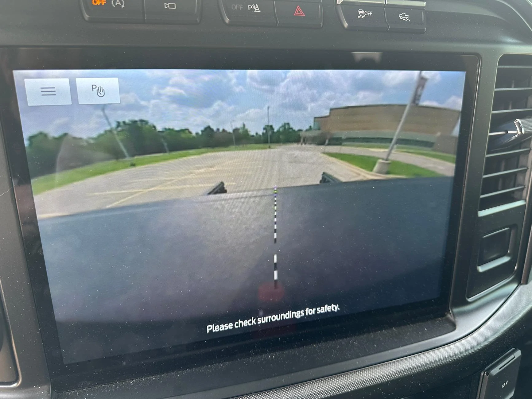

I just got mine installed yesterday as well and was kind of disappointed myself on the quality. To the point I went back to make sure there wasn't a clear protective film over the camera lens. There was not. Haha
Crazy how expensive the part is for the camera quality you get. As @rjinaz said, it will get the job done and come in handy when loaded down.

Thanks to everyone here, I got my OEM camera installed and working today. One thing I would point out is that if you have a fold-up bed cover, like the BackFlip MX, it blocks almost the entire view of the camera when folded up.
