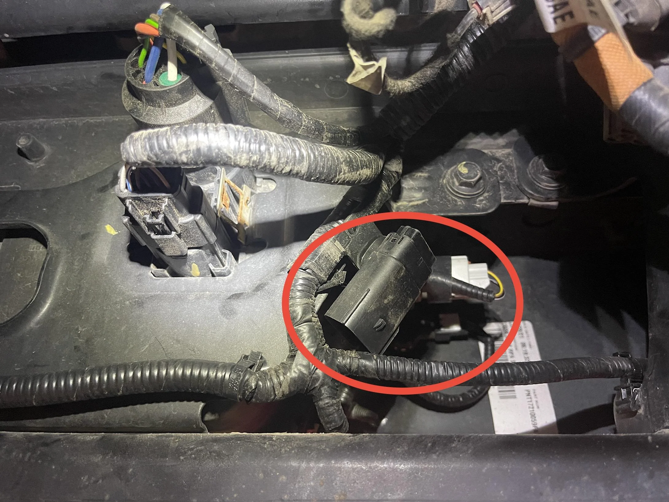

Installed the ML3T-13A576-AKF cord today--Thanks David. The sensors work just fine. I'll be enabling the aux camera/TPMS in forscan soon and checking to see if my camera works on my trailer. The pinout on the main fat cable was the same as the previous plus a bunch more pins. The 12 pin also had the right amount of wires.
Although I know this wasn't the cord that was recommended the one I needed has been sold out for months. My truck was built April 2021. 21 F150 3.5L eco boost Lariat 502A with max tow. This cord came with an extra pig tail labeled 33482-6227 22232 10. I think it might be for later trucks with the tongue scales? Anyone have an idea what this connector might be? Should I tape it up to protect from water?
Ford F-150 Any update on a Trailer TPMS system? IMG_1233
Ford F-150 Any update on a Trailer TPMS system? IMG_1234

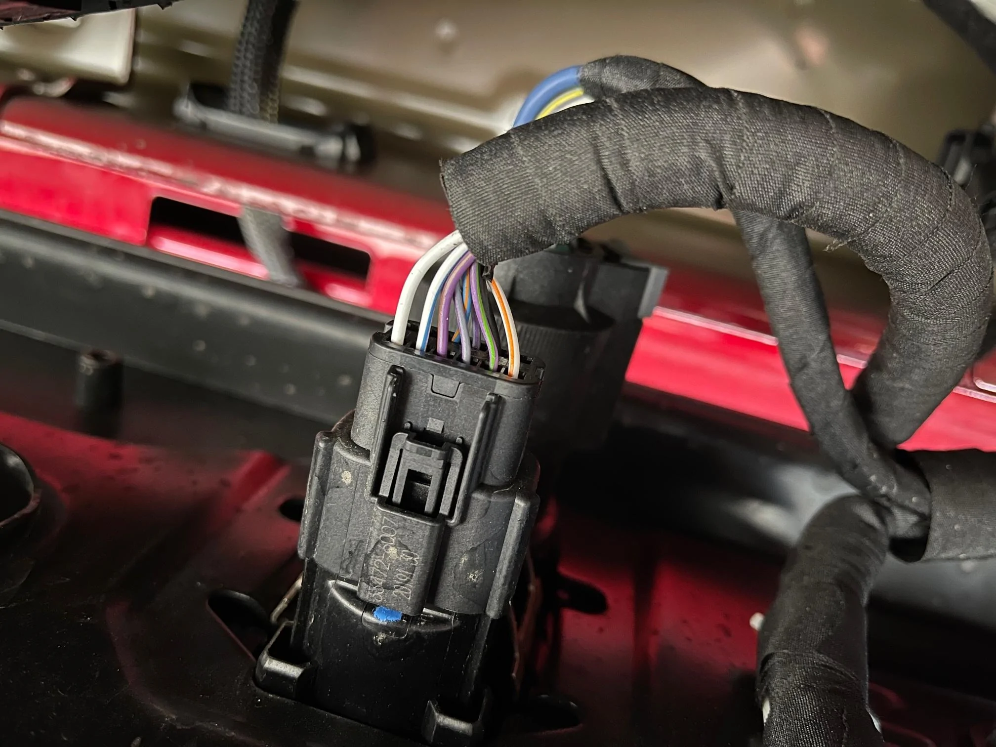

Perhaps of interest / help, see the pics at this post. You're looking to count the wires on "C439" which should be 'stowed' in a 'blind cap' immediately behind the bumper.
Good luck!

From my archive, here's a pic of the 'fully populated' (9 wires, 3 unused pins) C439 by another forum member. In this view C439 is plugged into the '12-pin' bumper socket.
Ford F-150 Any update on a Trailer TPMS system? FULLY POPULATED 12-PIN CONNECTOR

So after crawling under my truck I do have the C439 with 9 wires plugged into a blind cap. So I do not need the new wiring harness correct???
You should be good-to-go with the plug-and-play Ford Accessory Trailer TPMS / Cam kit.
The kit I bought on 6/13/2022 (PN LC3Z1A189A) included the 7+12 pin connector to replace the OE 7+4 pin connector in my bumper. My 'fully-populated 9-wire C439' plugged into the back of that. Everything for the trailer was included. installed it all and Eureka, trailer TPMS with tire temperature and trailer rear cam view all worked as advertised.
