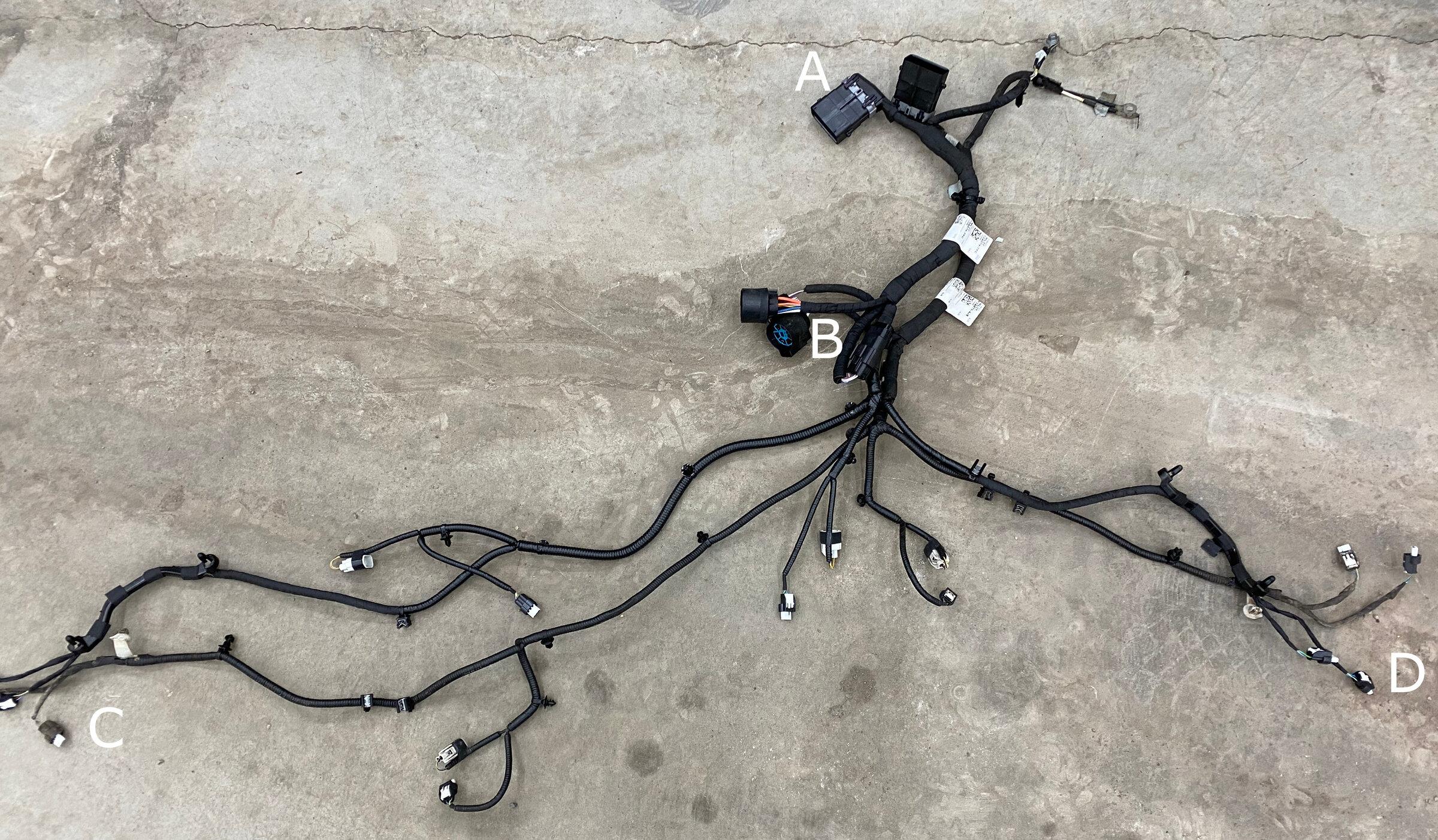

Below is a picture of the ML3Z-13A76-TFA harness lying on top of my old harness. “A” is where the harness connects to the rest of the truck, “B” is the trailer 7 & 12 pin areas, and C&D are the parking sensors at the far ends of the bumper. As you can see the two harnesses are almost identical, except for the far ends near “C” and “D”. It's too bad we have to swap the entire harness when all we need is a few more wires populated from “A” to “B”….all I can think is that some sort of supply chain issue must have forced Ford to not to populate these wires.
Ford F-150 Any update on a Trailer TPMS system? HarnessOverview

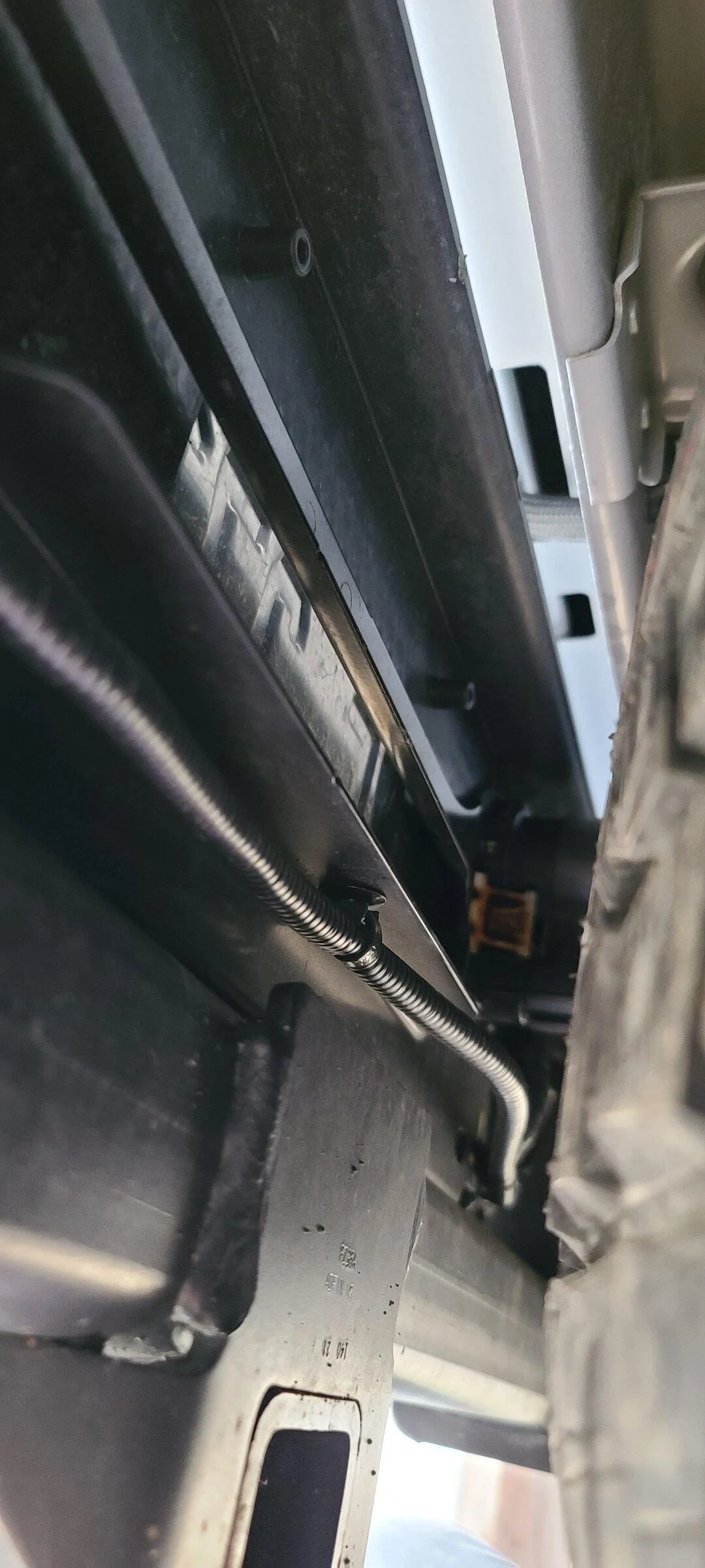

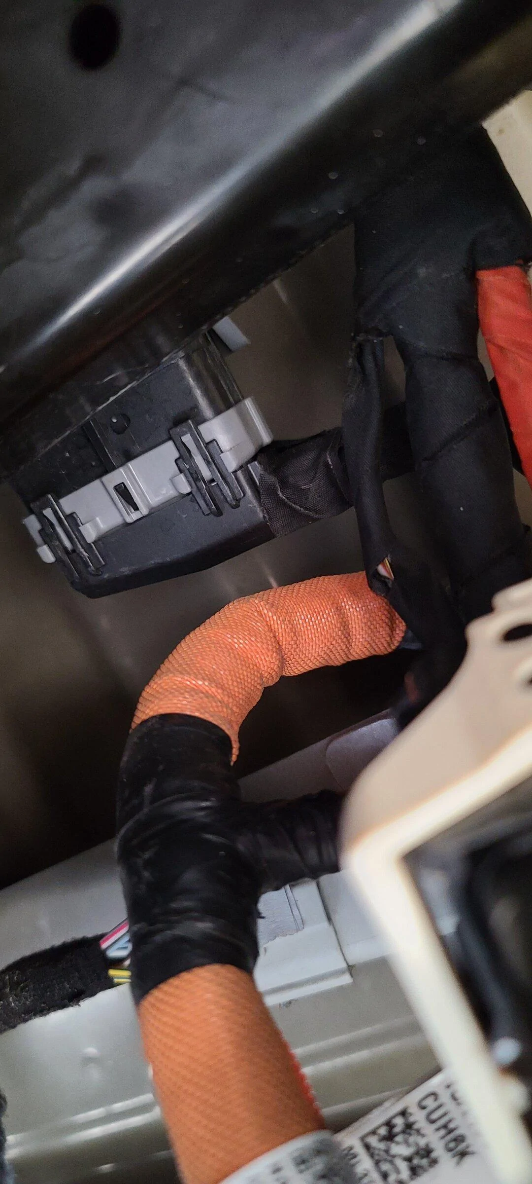

GChurch’s description is quite comprehensive so I will just add a few photos. This photo is looking towards the trailer hitch with the spare removed. It gives an overall sense of where I spent most of the time, with the letters labeled the same as the harness. On my truck there is a lot of other harnesses nearby (I believe the Orange is related to ProPower, as well as power tailgate, etc). The hardest part was squeezing the big end “A” past this stuff, but slowly and carefully can be done without needing to disassemble anything else.
Ford F-150 Any update on a Trailer TPMS system? InstallOvervi

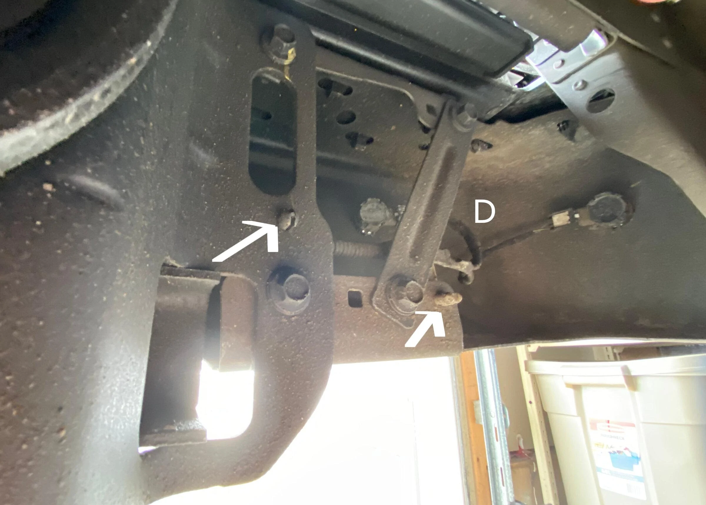

Here’s a quick picture of the D end, where the outer parking sensors connect, and the arrows are where the push-pins are incorrect on the dual exhaust harness….an easy location to get to.
Ford F-150 Any update on a Trailer TPMS system? DEndCloseU

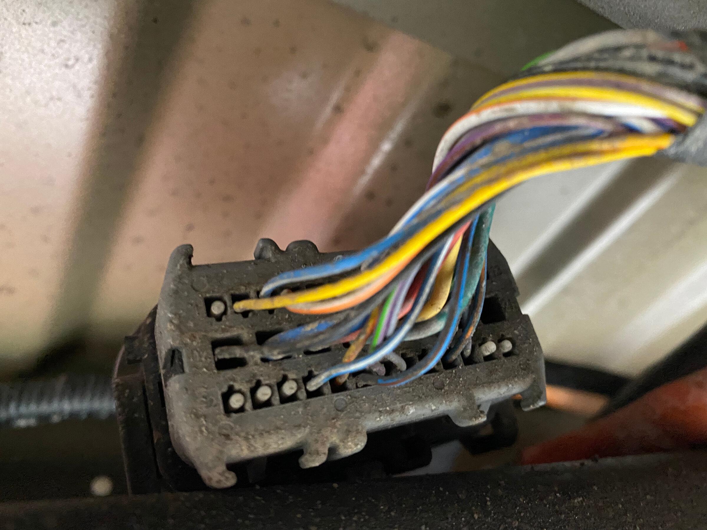

One worry I had was that some of the upstream wiring going to the cab might not be there. To address this, one thing I did before I started removing anything was to get up close to the other side of the big connector (upstream side of “A”) to see how well it was populated and compared it to the pins in GChurch’s post. Below is what mine looks like, and as you can see it has most of the pins populated. You could drop your spare and have a look to see before ordering a harness….if you see quite a few less wires populated, the bumper harness alone may not do what you want for your truck.
Ford F-150 Any update on a Trailer TPMS system? TruckSide
