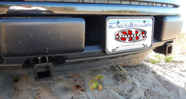

Has anyone seen a swap for the front tow hook to make it a hitch receiver? Googling shows me a guy who made one years ago but that seems like a dead end now.
Looked like this:
Ford F-150 Any product to convert front tow hook to hitch receiver? 108d1443545130-tow-hook-front-end-hitch-hook-hitch

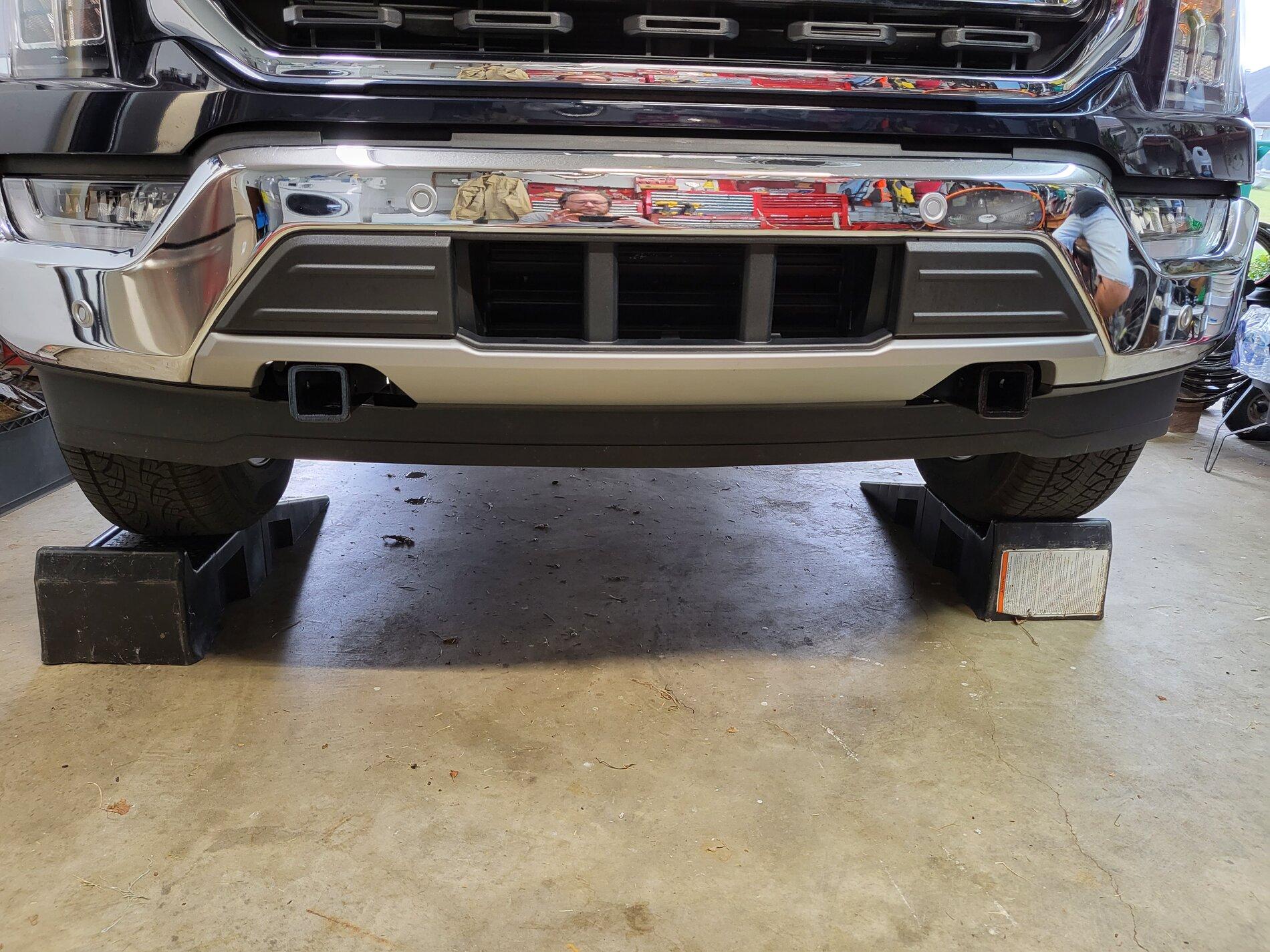

Okay. Here it is. A huge thanks to my neighbor, @NEWT32, for all of the help. We had a blast doing this. He was just as excited as I was ?
First, a couple things.
1. The tow rings are easy to remove. Two bolts each. But, the bolts are attached to each other inside the frame, but loose and move around. If you take them both out at once, they move on you. You can get them back in place. Grab a flashlight, magnet, and screwdriver. Have patience!
2. The rear bolt is between two pieces of plastic and annoying. The front plastic is on with clips. We left it alone. The rear one comes off with three screws on each end. Take that off. But, maybe mark it with the receivers first. I cut the passenger side on the truck. Measured it after to cut the drivers side. It didn't line up. So. It went back on with a little force and bent plastic.
Ford F-150 Any product to convert front tow hook to hitch receiver? 20211010_194416
Remove the tow hooks and rubber piece around them. Only one bolt is required to be removed. It slides over the other loosened bolt.
Ford F-150 Any product to convert front tow hook to hitch receiver? 20211010_205749
I used the recievers I linked above. That length actually butts up against a bracket further back.
Half inch holes on one side for the bolts and inch holes on the opposite side for the socket.
Ford F-150 Any product to convert front tow hook to hitch receiver? 20211010_193122
Ford F-150 Any product to convert front tow hook to hitch receiver? 20211010_193130
Center of half inch hole is 4 inches from the back. Center of front hole is 3 inches from center of back hole.
We drilled the half inch hole on a drill press and went all the way through the back side. Then a one inch bit to enlarge the top side hole.
It takes some maneuvering to bolt it on. Once you get one bolt started, crank it in a bit. You can then spin it back and forth to get the second nut (remember, they are connected) inside the frame lined up.
Ford F-150 Any product to convert front tow hook to hitch receiver? 20211010_194744
Ford F-150 Any product to convert front tow hook to hitch receiver? 20211011_095334
We had to shave a bit off the top of the reciever on the winch mount to clear the bolts to get it in far enough for the pin.
Ford F-150 Any product to convert front tow hook to hitch receiver? 20211010_205818
Due to the bumper trim, the pin is difficult to get in and out. But, it is doable. The left pin will not go in, but the right one will.
Ford F-150 Any product to convert front tow hook to hitch receiver? 20211011_094536
We have a possible plan to turn my locking pins and shorten them. I'd love to keep my Factor55 Hitchlinks in there. I'll report back how that goes.
The Factor55s fit in without modification.
Let me know if there are any questions. I am sure I left out something important :ROFLMAO:

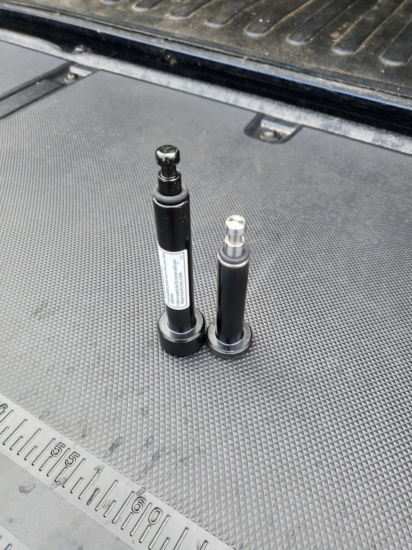

I have these locking hitch pins
https://www.amazon.com/dp/B07Y7YSR11
We shortened two of them and inch and recut them for the lock. We also cut the butt end down by about half.
Ford F-150 Any product to convert front tow hook to hitch receiver? 20211024_150047
Ford F-150 Any product to convert front tow hook to hitch receiver? 20211024_150104
The pins go in easily now. But, the lock does not. We'll be taking a rototool to the lower trim shortly.

And, we have it!
New pins cut down an inch like the first set. Then, the lock is recut to match the new ones.
Ford F-150 Any product to convert front tow hook to hitch receiver? 20211107_154752
The pins fit inside out.
Ford F-150 Any product to convert front tow hook to hitch receiver? 20211107_154909
With the lock attaching from the outside and the key pointing up/down/front/back.
Ford F-150 Any product to convert front tow hook to hitch receiver? 20211107_154917
And, the completed project from the front.
Ford F-150 Any product to convert front tow hook to hitch receiver? 20211107_154858
