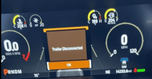

Just completed another camping trip with the 2021 Platinum 4x4 PB. Towed our 2023 E-Pro 20FBS TT (3740#s) and while using tow mode we got 10.6 MPG. Had strong headwinds towing the trailer outbound, we left right after a cold front came through Florida so we had NW winds the entire trip out. We stayed at St. Andrews State Park near Panama City FL. Before this trip I adjusted my WDH and shifted more weight from the rear to front axles and that made a big difference in the high winds. Had very little sway. Didn't use the PPOB this trip since we had full hookups. Still having the "trailer disconnect" warning after stopping for gas. Seems like everytime I stop and start the truck up it doesn't see the trailer. Have to turn off the engine, disconnect the trailer and start up the truck and plug in the trailer. PITA.

For the trailer disconnect issue, try putting some conductive grease on the 7-pin connector. I had the same issue, but that cleared it up.
Thanks, I have already order it and applied some to the connectors. I have trip scheduled for March and going to test it then... Thanks for the info..
For the record, the grease used on electrical connections is not conductive. What it does is prevent oxidation of the electrical contacts when exposed to moisture so you get a good electrical connection.

I got both contact cleaner and dielectric grease.
