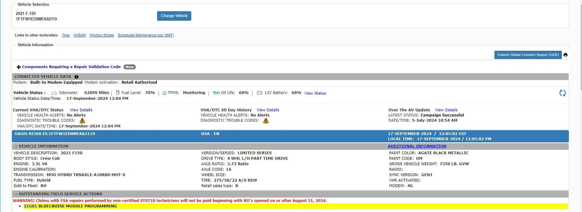

Post or send me the VIN. I can check if the campaign is open for your truck.

VIN:1FTFW1ED8MFA82119
It's there and it's open. Your truck qualifies. If after they do the updates, BC still doesn't work, then get yourself a FORScan adapter and get back to me.
