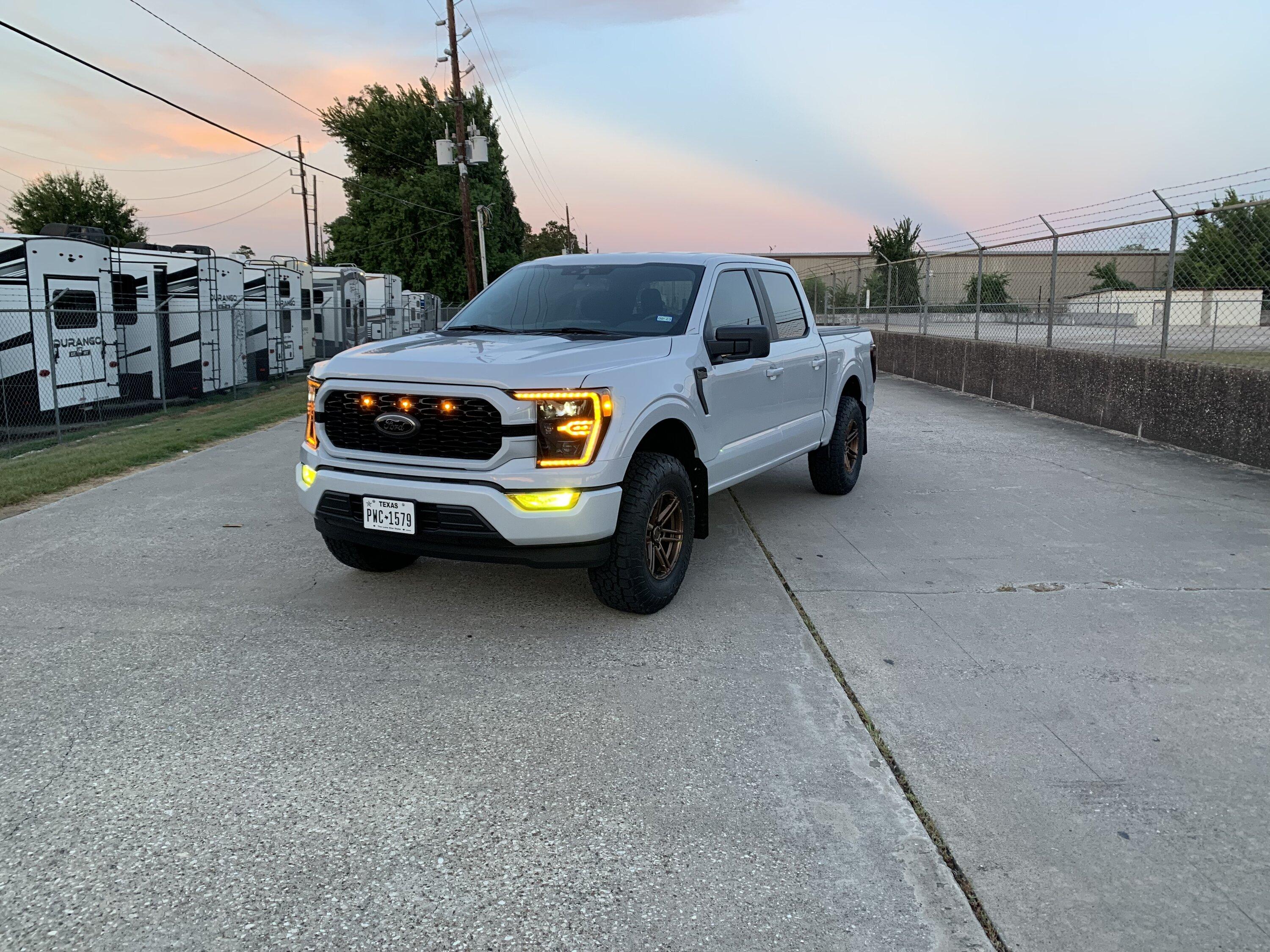

Drls worked perfect on the way to work this morning.
Ford F-150 AlphaRex LUXX Headlights AC300088-16DA-46E8-A50B-1B709E167730
To my knowledge they go half brightness when low beam is on, I think it is now full brightness. The drls do seem a little less bright than the morimotos we have installed on the f250. But I think I fixed the problem!

How did you turn headlights off during the day?

yes, how did you turn off the headlights? I bet you are NOT in “auto” headlight mode and are driving with parking lights on. This is why the DRL’s would be at about half power…..so this may be why you were assuming a problem with DRL brightness. With my last truck Yukon SUV, the DRL’s were bright as hell, but when I put on parking lights theDRL’s actually got about 50% dimmer. Anyhow, how did you get the headlamps to turn off while in “automatic” mode?

You go to your sync screen!
Settings
Ford F-150 AlphaRex LUXX Headlights {filename}
Vehicle
Scroll down to lights, click lights
tap the drl slider to turn then off
That is what I changed in settings so that in auto mode there was no low beam just full brightness drl’s!

Ok, I will do that. I hadn’t because I assumed that the DRL’s wouldn’t turn on if I turned off the automatic mode. I didn’t know the DRL’s would turn on whenever the truck is on whether auto mode is on OR off! I will give it a whirl! Thanks.

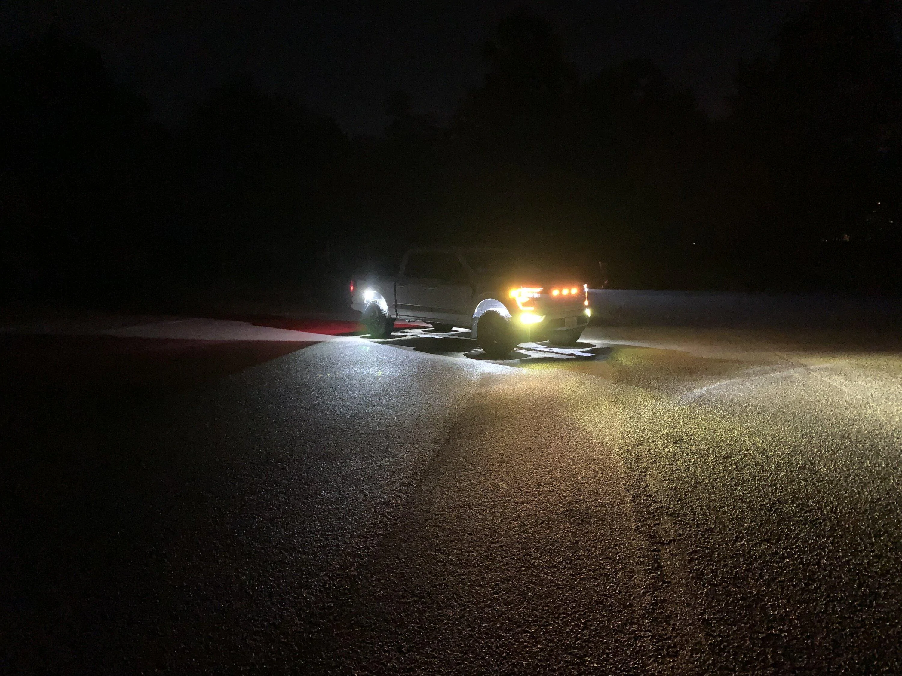

At this point, I would see what the morimoto’s end up looking like and possibly the AlphaRex novas. I would think that they are going to be pretty expensive though. I would recommend the AlphaRex headlights off of my experience they have been great so far!
