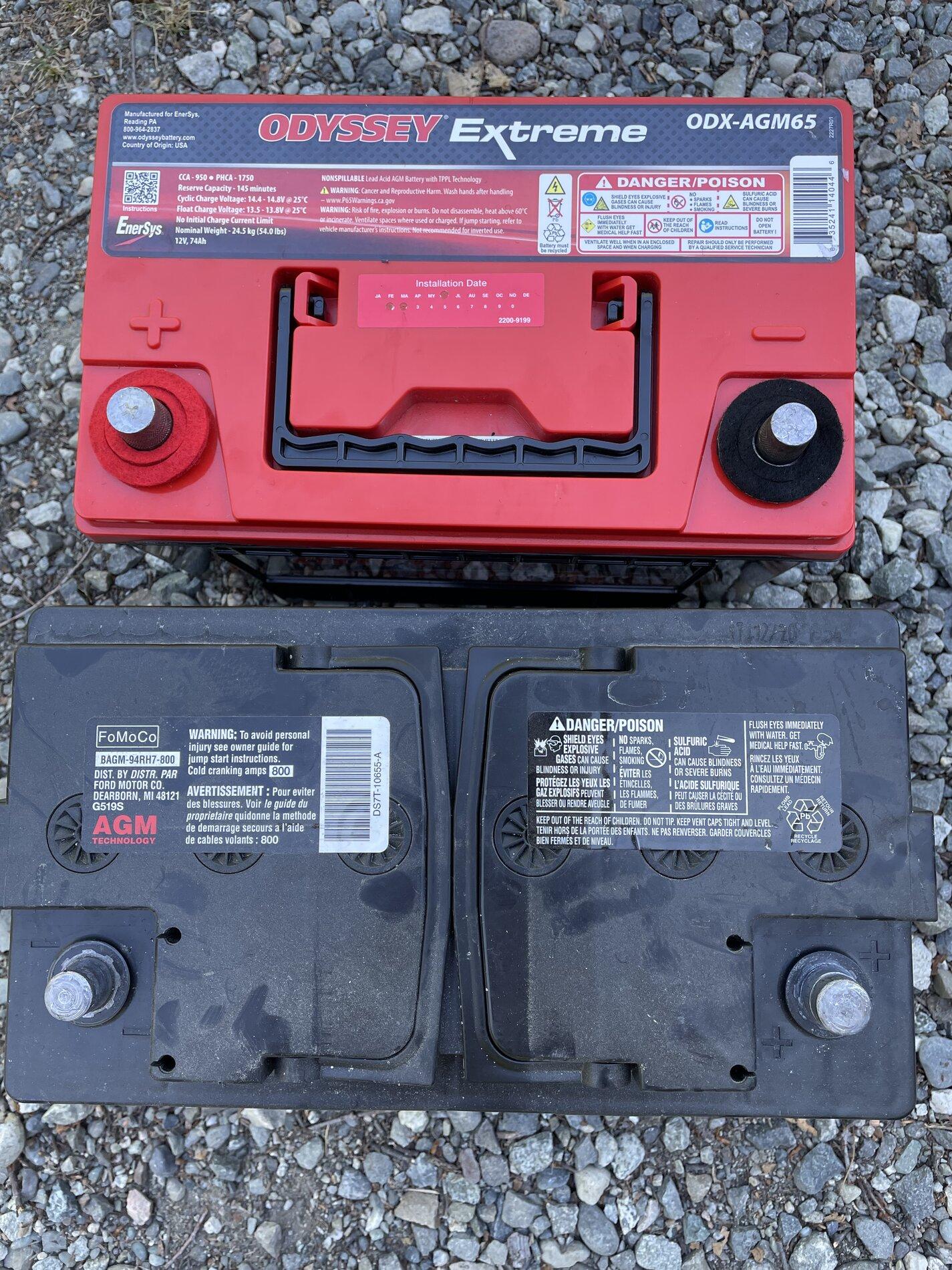

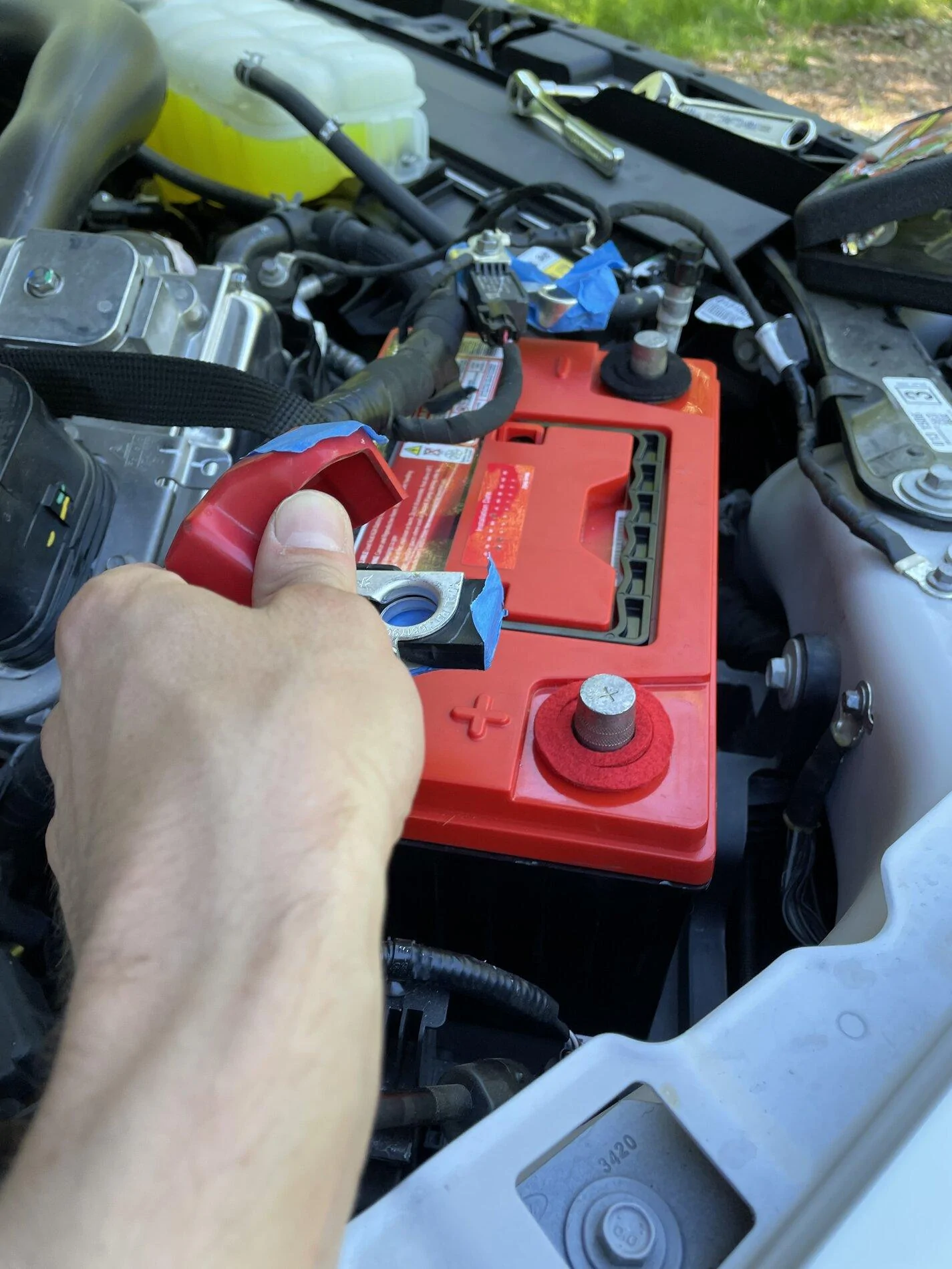

I know this is a bit old but I was over zealous wanting to get a badass battery because of early low voltage issues I had with this truck.
only at 3050 miles and have a misfire cylinder 2 P0302 that won’t clear and the Ford shop is almost 2 months out.
I convinced myself if I get a badass battery I’ll get rid of some of
These seemingly nuisance CEL I’m getting.
Long story short.
Odyssey Extreme 65 terminals are opposite and the F150 harness is so tight I cannot get it to fit.
Im just doing parking lot tooling for now but I’m thinking at this point it’s a sign I should just return the battery tomorrow.
I bought one of those cigarette lighter plugs that tells you battery voltage and right before I bought the battery my OEM was barely 12.5VDC after a decent drive definitely getting into RPMS.
Since my sh!t show of a battery swap I have the OEM battery back in and was noticing 14.1VDC on my drive and 12.8VDC when I parked for a bit.
The original is probably fine but I really like the idea of peace of mind and that badass odyssey battery.
Anyone install one of these?

Using the Odyssey website to search for 2020 F150, this pops up:
https://www.odysseybattery.com/products/odp-agm94r-h7-l4-battery-94r-850/
You can also rig up something like this:
Though for a brand new truck it's kind of silly, I really wish that they stopped making the OEM leads barely long enough to reach, since sometimes you have to trim them shorter after a while to eliminate corroded copper wire.

Dudes!
The kid yesterday gave me a what Ford was.
I just went to return and was given the correct model.
Amen. Now to satisfy my cause I wanna itch.

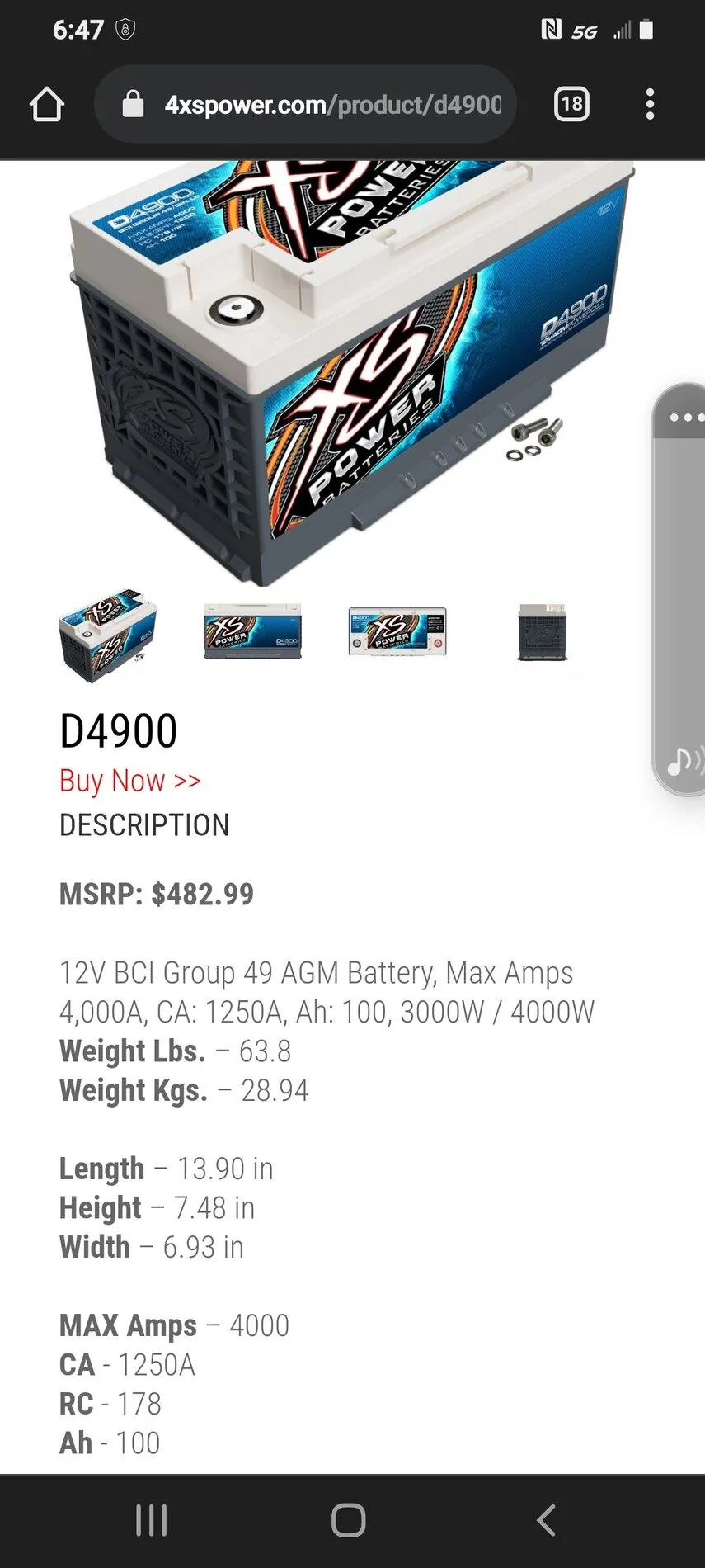

Ordered this on fir myself should get here tomorrow
Damn that seems expensive, do you have a big stereo or just worried about the stock one? How's it working out?
