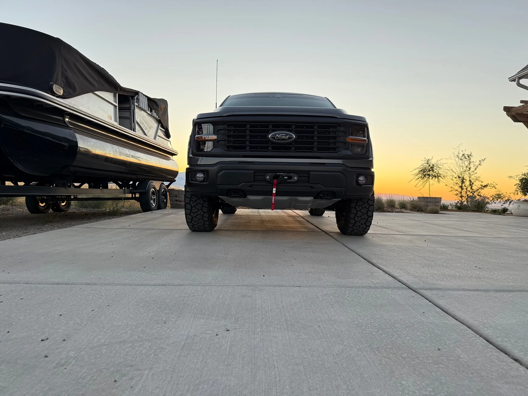

Howdy all! My truck didn’t come with fog lights for the factory and I wanted to add some. I decided I’d just get some SAE rigid 360 fogs and come up with a way to mount them. But I was hoping to just install a OEM wiring harness and replace the OEM headlight switch for one that has a fog light switch.
Hooked up everything, and changed what’s needed in forscan and they don’t work.
I’m wondering if my truck didn’t come with a relay or a fuse that I need to get them to work?
Would love some help on this!

Update: luckily my local dealership had a OEM fog in-stock. Went and bought it just to trouble shoot. Plugged it in and the thing turned on just fine. I figured out the polarity on my H11 to deutsch adapters were reversed, or the polarity on the H11 plugs were reversed. Either way swapped the pins around and the rigids are working now!
