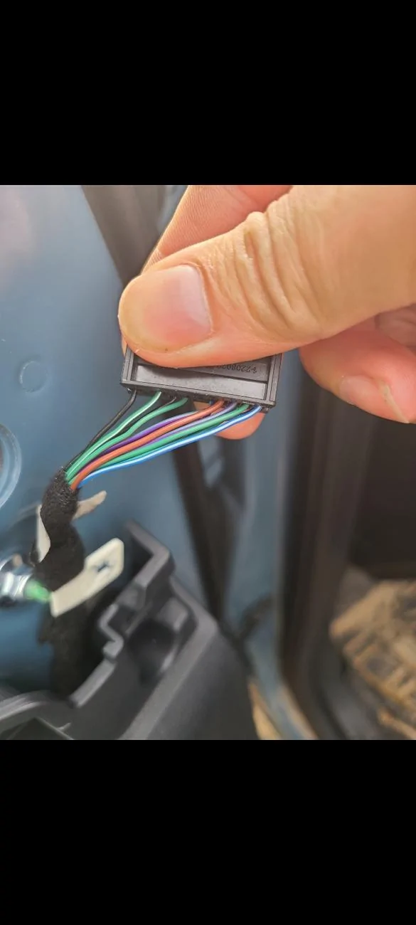

So apparently I'm not smart enough to find and read the wiring diagram. Lol. Does anyone on top of their head know the wire colors I need. Here's my plug

Did they send you mirrors with puddle lights in them?
Don't need to be chasing wires if the mirrors don't have the lights. They seem to only put in what you order from looking at website and leave out the rest of features.

The puddle light wiring as well as turn signal was there on the connector in my 21 xl, but had to be activated in forscan to send any voltage.

I'd sent boost auto a pic of my plug and they said I had wiring for turn signals. They didn't say anything about puddle lamps. I didn't ask either. Lol. I'll prolly start off by emailing them again asking if I have the wiring for puddle lamps.
