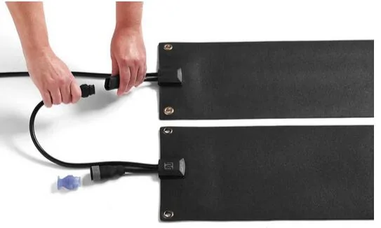

And Donzo!
Ford F-150 Adding factory rear heated seats to a 24 XLT wiring mats
$90 buckaroos, plug and unplug as needed... ?
