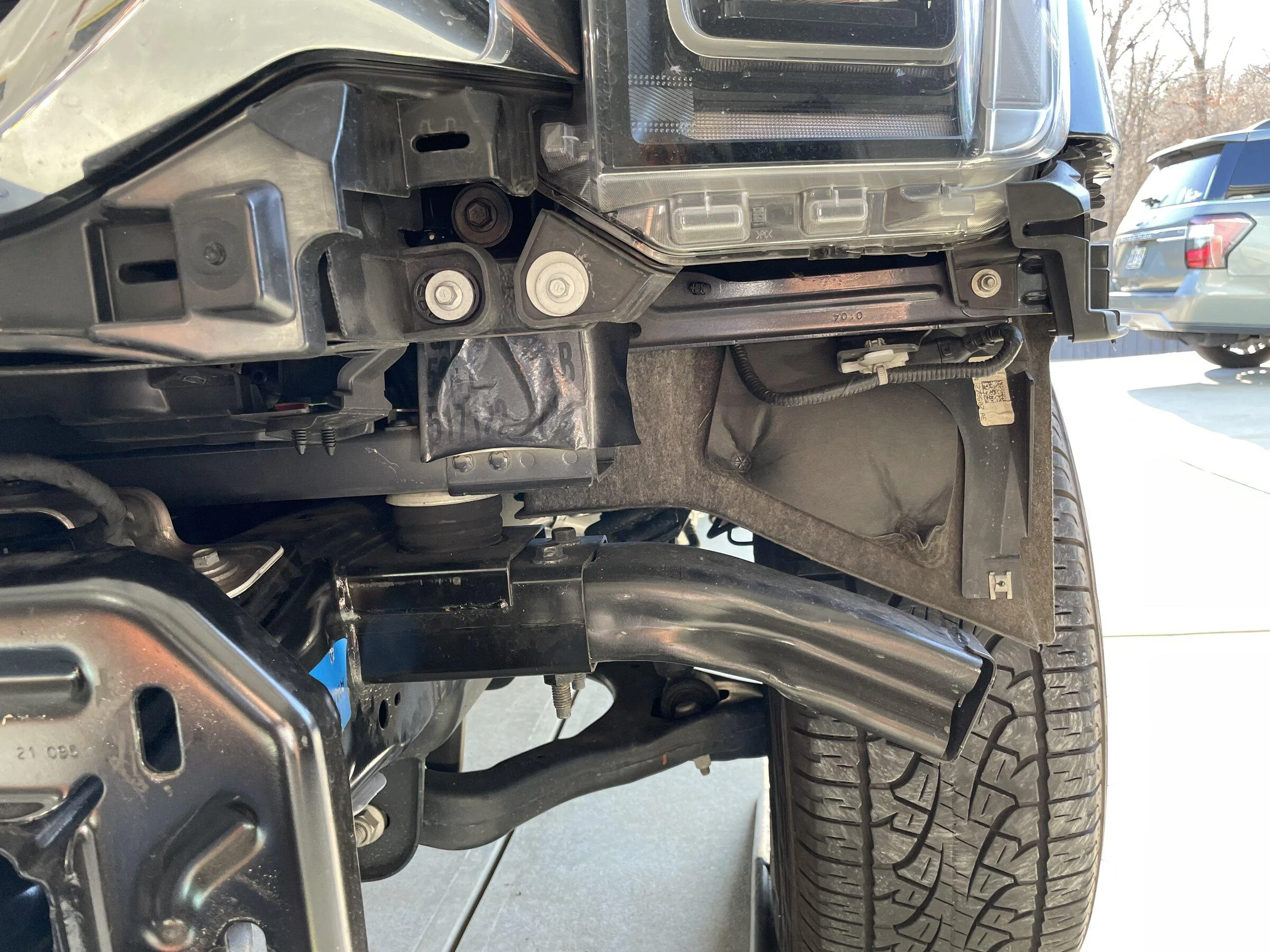

They are for the Intersection assist that comes with co pilot360 assist 2.0
I have a 2021 King Ranch with 601A, which includes the Ford Copilot 360 Assist 2.0, and can confirm that my truck does not have the front BLISS sensors. The attached picture shows that i have the front BLISS bracket but i dont have the actual sensor.
Reading this post, i was curious what they are for. I recently added the four front proximity sensors and have been wondering what i need to update to get the truck to recognize them.
My 501A is exactly the same like yours, wired for the front bliss sensors but no sensor.
