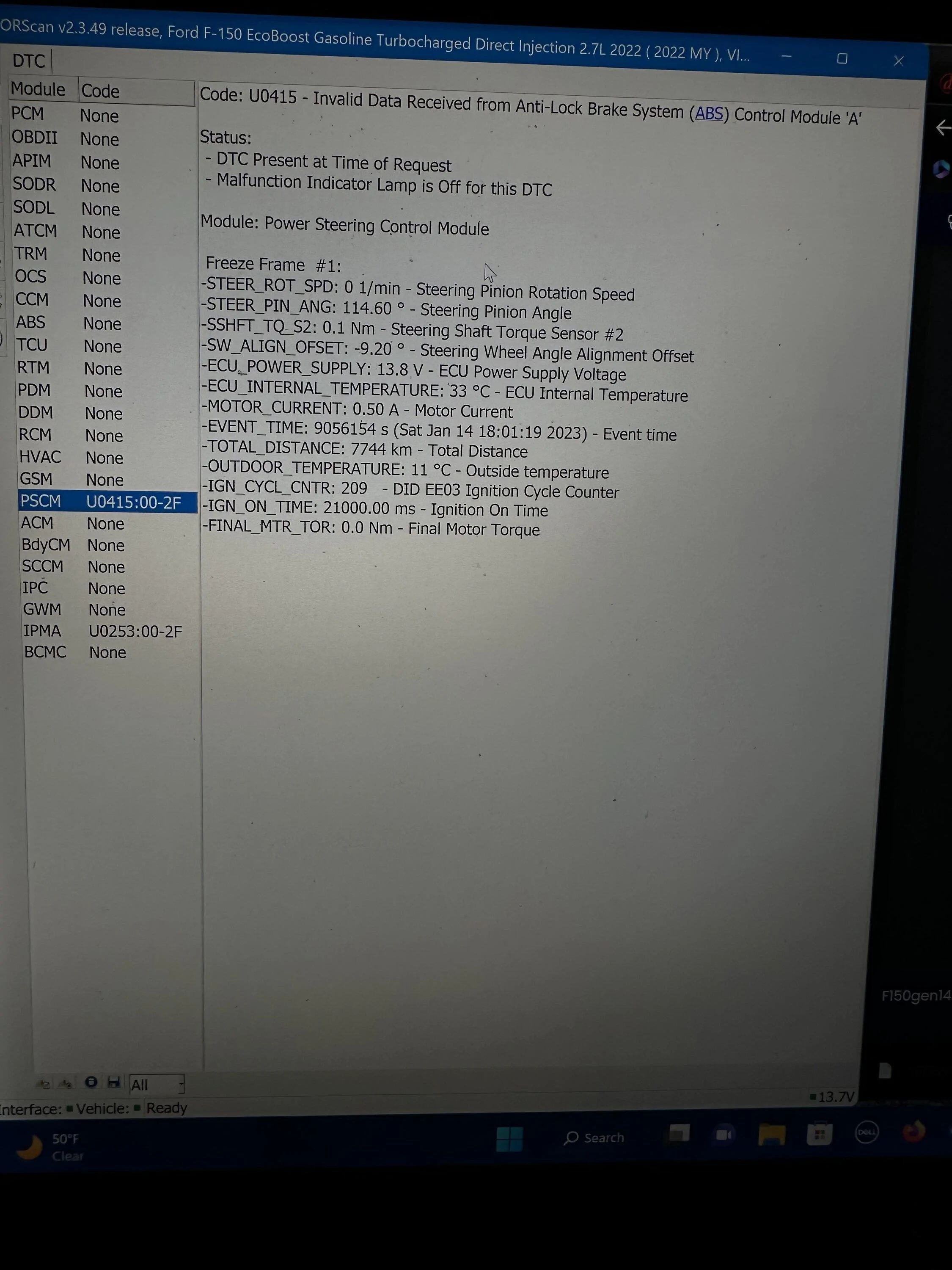

Took a few hours of trial and error but I finally got it working! Couldn’t be happier.
I do have a DTC in the PSCM for invalid data from ABS. Everything is working, truck comes to a stop behind other vehicles and even had to stop suddenly to avoid an idiot that couldn’t stay in his lane so not sure what the DTC is about or what I should do to fix it.
Reset the DTC counter. They'll pop up when the modules go offline.

This was after resetting DTCs. The only 2 I have that keep coming back is that one and one for the IPMA for communication loss with APIM which I assume is because I don’t have Nav.

Yea that IPMA code is unavoidable. I'm assuming you've already performed a module reset on the ABS and PSCM?

Ah, no I haven’t. I’ll try that tomorrow.
Plan is to add nav back so TSR works. Just happy to have co pilot back.
