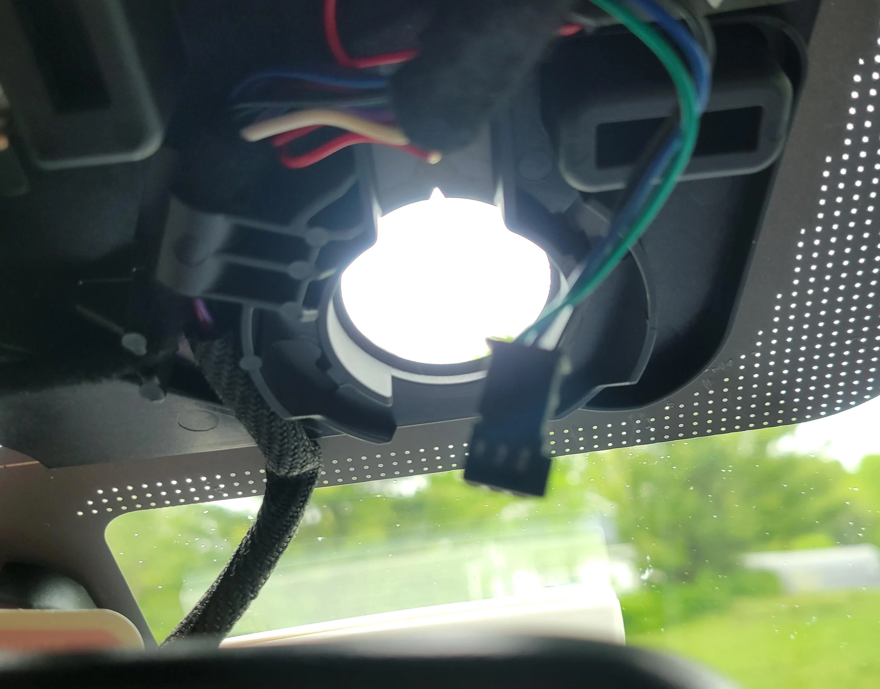

So I decided to pop the cover above the rear view this morning and found three wires that go to a dummy plug. My guess is that these are for the rain sensor.

I added it in my 22 501 lariat. Power was hot to the dummy plug. Added the sensor and a couple for scan changes.
Please suggest the Forscan changes if you can remember them :)
