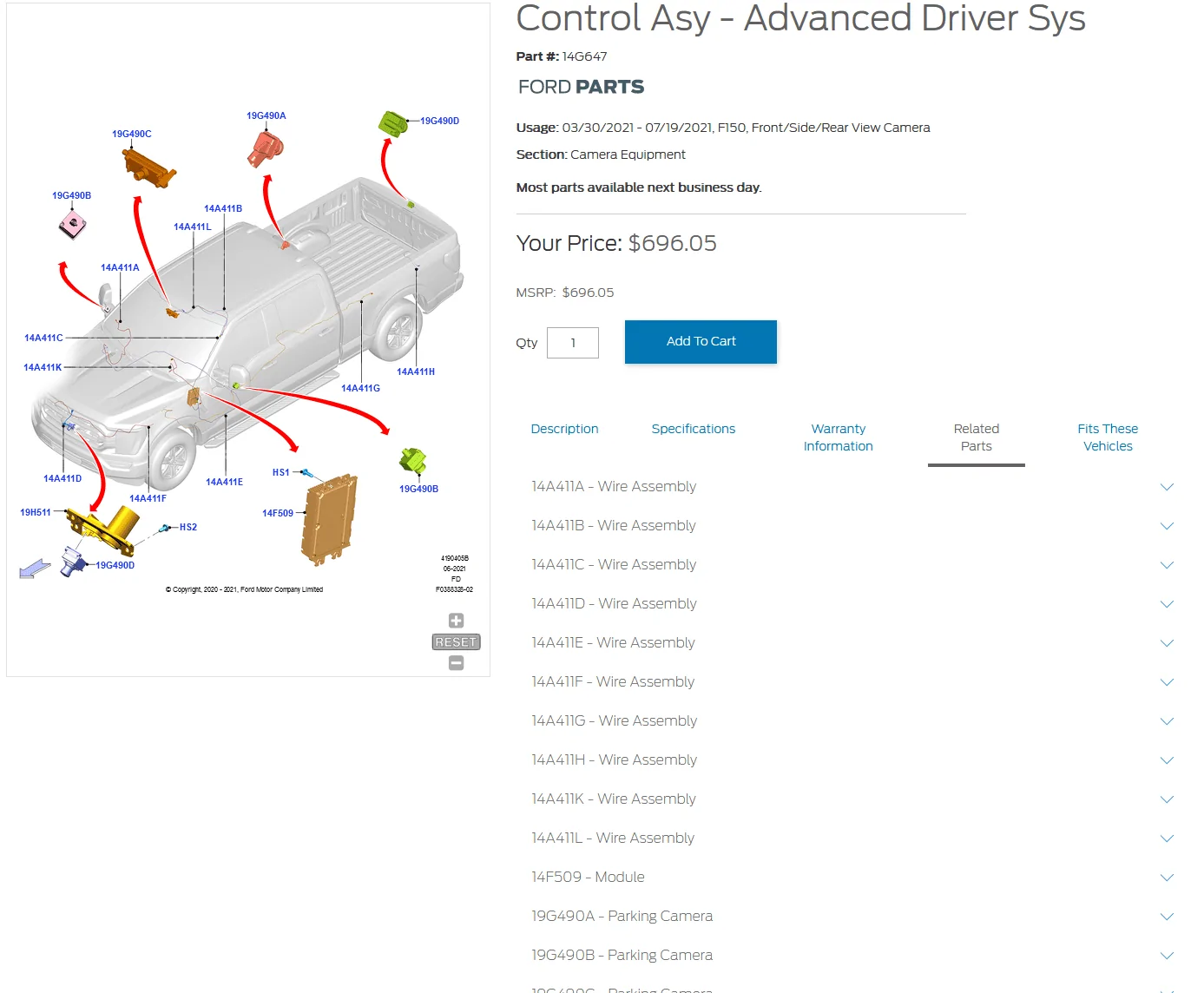

I was wondering if I am pointed in the right direction, I located a set of tow mirrors with cameras, for what I understand I will need the front cam, wiring harnesses and module for the 360 cam? I am guessing 14G647 is the module, I am finding a bunch of different versions of this module with different letters on the end ( ML3Z-14G647-A,B,C...etc..) any idea what the last letter means? and if this is the module, I would like to take on this project if I can find the parts. Any help is appreciated.

IPMA depends on build Date. If you have a job 1 or 2 or a 22.
I THINK you can use a JOB 1 in any but that hasnt been verified 100% I have done it but not with a 360 cam IPMA only the rear cam IPMA.
The Cargo cam is only available with the brake light.
Ill give some parts but I have no responsibility of the accuracy. These are what I used in MY truck.
IPMA ML3Z-14G490-J
FRONT CAMERA - ML3Z-19G490-C
FRONT CAM HOUSING(PLASTIC) - ML3Z-19H511-A
HARDWARE - W506962S450
SIDE CAMS -I BOUGHT MIRRORS. I THINK YOU COULD PIECE TOGETHER THE PARTS AND TRY TO INSTALL IN YOUR MIRRORS I DONT KNOW. IF YOU WANT MIRRORS THE PART NUMEBRS DEPEND ON WHAT YOU WANT. LARIAT OR XLT I DECIDED AT THE TIME TO ADD POWER FOLD.
CARGO CAM - ML3Z-13A613-E
SIDE CAM COAX - ML3Z10E929DBA X 2
GREEN COAX ASSEMBLY - ML3Z10E929CAA (FOR SIDE CAMS AND FRONT)
FORD LOGO FRONT CAM - BLACK PLASTIC - ML3Z8213F (DOUBLE CHECK)
WASHER HOSE FOR FRONT CAM - ML3Z17A605B
WASHER HOSE FOR FRONT CAM 2 - ML3Z17A605C
WASHER NOZZEL FOR FRONT CAM - HC3Z-17603-B
NOZZEL CAP - ML3Z-17C526-A (BLACK PLASTIC)
FRONT CAM JUMPER - ML3Z10E929CCA (FRONT CAM IS PREWIRED TO THE GRILL. THIS JUMPER IS FROM THE IPMA TO THE UNDERHOOD CONNECTOR)
Please do not message me asking me if I am sure. The main reason I have not posted this is because of the messages I have received after privately trying to help.
I can help only so much. I dont mind helping but asking me to give you a money back guarantee is beyond ridiculous.
360 IPMA is REQUIRED for adding Adaptive Cruise.
I can help some with as build and such but the main issue with the ipma if you buy new IT WILL HAVE to be PMI. Also after the install a 360 and lane keeping cam calibration IS REQUIRED. Lane keeping calibration can be done in forscan the 360 cam calibration can only be done in FDRS.
