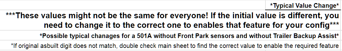

Did you actually go through each change in the sheet, look up your asbuilt then change it to the corresponding one to add that specific feature? Or did you just go down the sheet and change everything to my suggested possible changes? Since you have tow tech and most likely trailer backup assist, your values will be different and need to change them accordingly how your truck is spec'd.

That is you problem then, those are possible suggested changes only. You need to modify them for the specific build of your truck. Set everything back to factory as built, then utilize the main forscan sheet as well. See how your truck was built then change the values to include the new bolded features on the ACC sheet.

The sheet is in my sig below. You might ask on the main forscan thread, there might be someone close to you that could help you out. Share/send me your VIN and I could look up the asbuilt then send you what changes you need to make. If all else fails, I could remote in and help you out that way.
