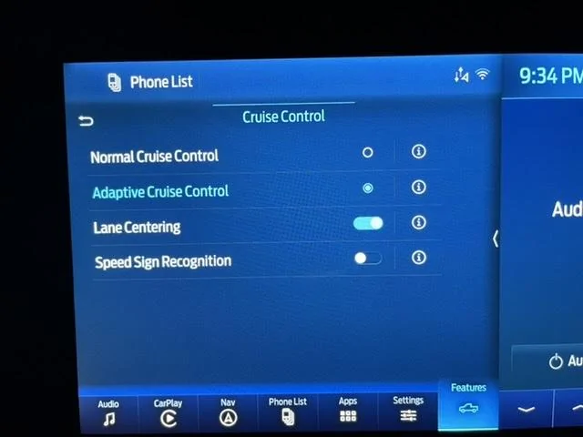

When I have a heavy load my front camera gives errors.
My question is how can I get just normal cruse to work?

There should be a setting on the sync screen menus under "Vehicle" and then "Cruise Control" I think where you can turn off adaptive cruise control and just use normal instead.
I looked and didn't see where there were any settings to turn off adapted cruise.

I was wrong. It is under Driver Assist and then Cruise Control.
