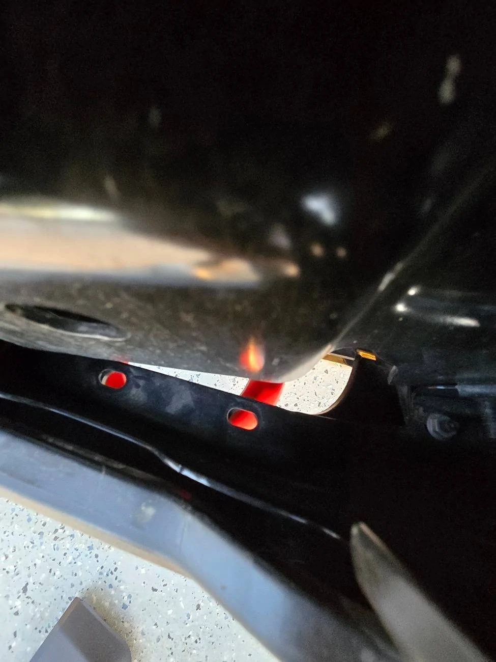

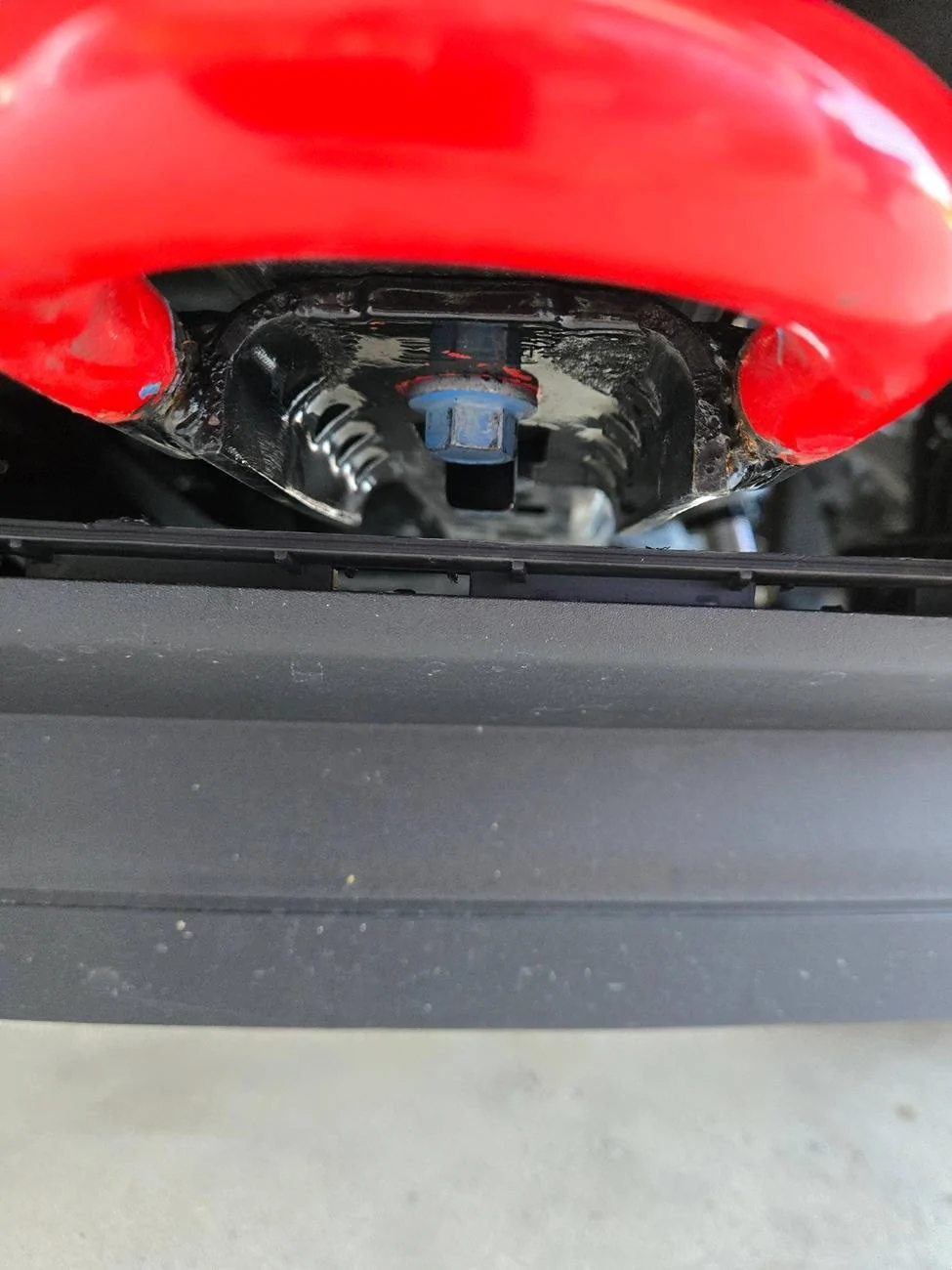

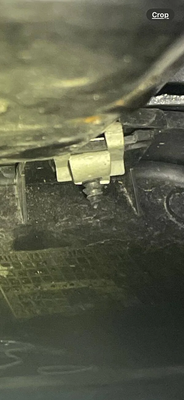

Yes, you remove the top panel that is on the bumper. They pop off easily with a plastic trim piece remover. A butter knife works too. Once removed, you can see the two small screws that hold the lower cap were the hooks go. FYI the stock hooks will need to be modified (cut and welded) to make them fit the 2WD lower valence. See pics below.

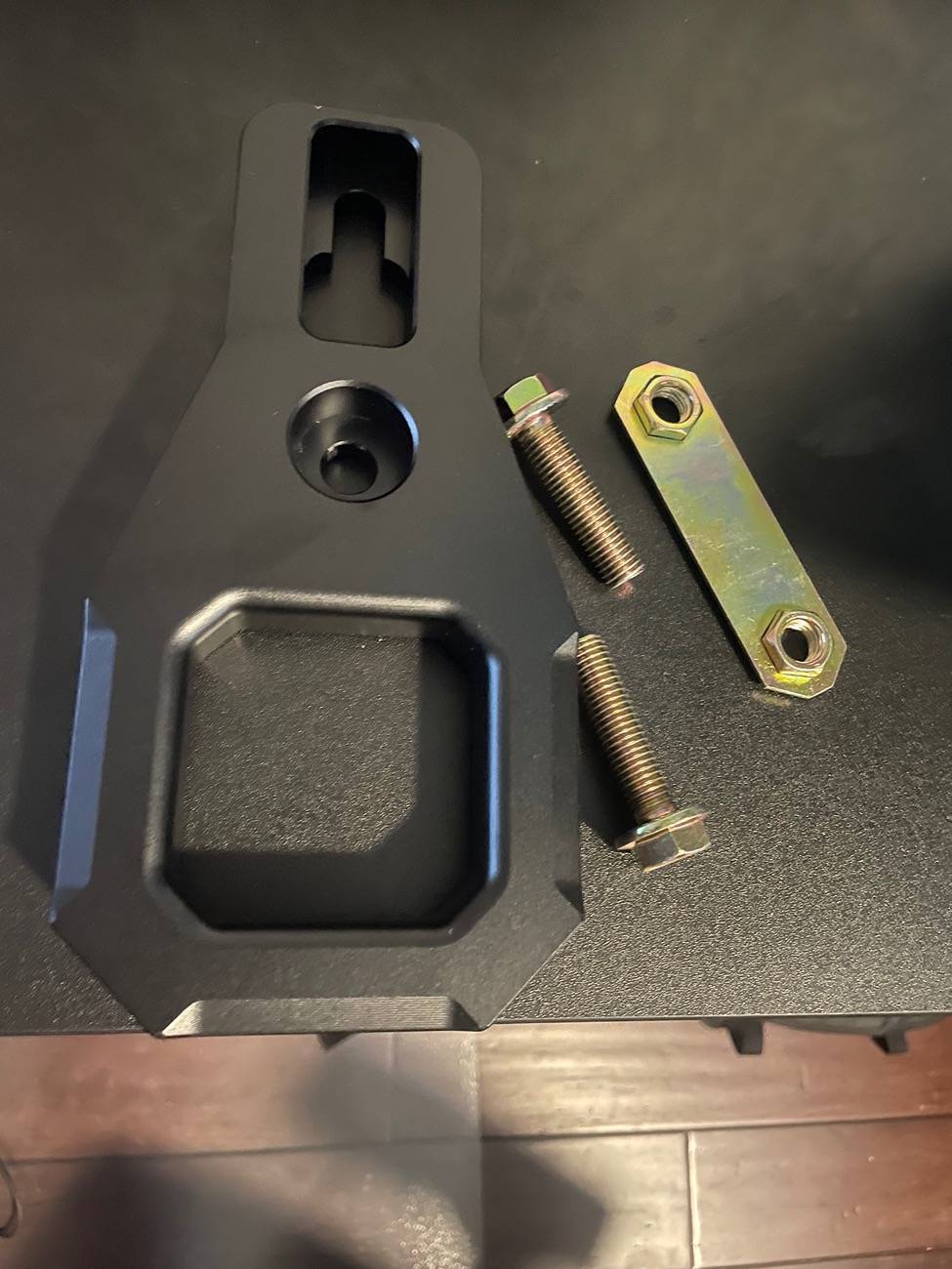

That makes so much more sense. I really appreciate it. I think I’m going to try a flat billet hook instead of the other ones and see if that works. Like on the raptor. I will report back once I try it. Thank you

Hey man, thanks again, that worked! Got another question though lol, did you have to remove the lower valence to install those hooks? I have flat billet tow hooks that’ll fit the 2wd but I can’t fit the socket wrench in with them
It's a pain, but can be done with ratcheting open en wrench.
