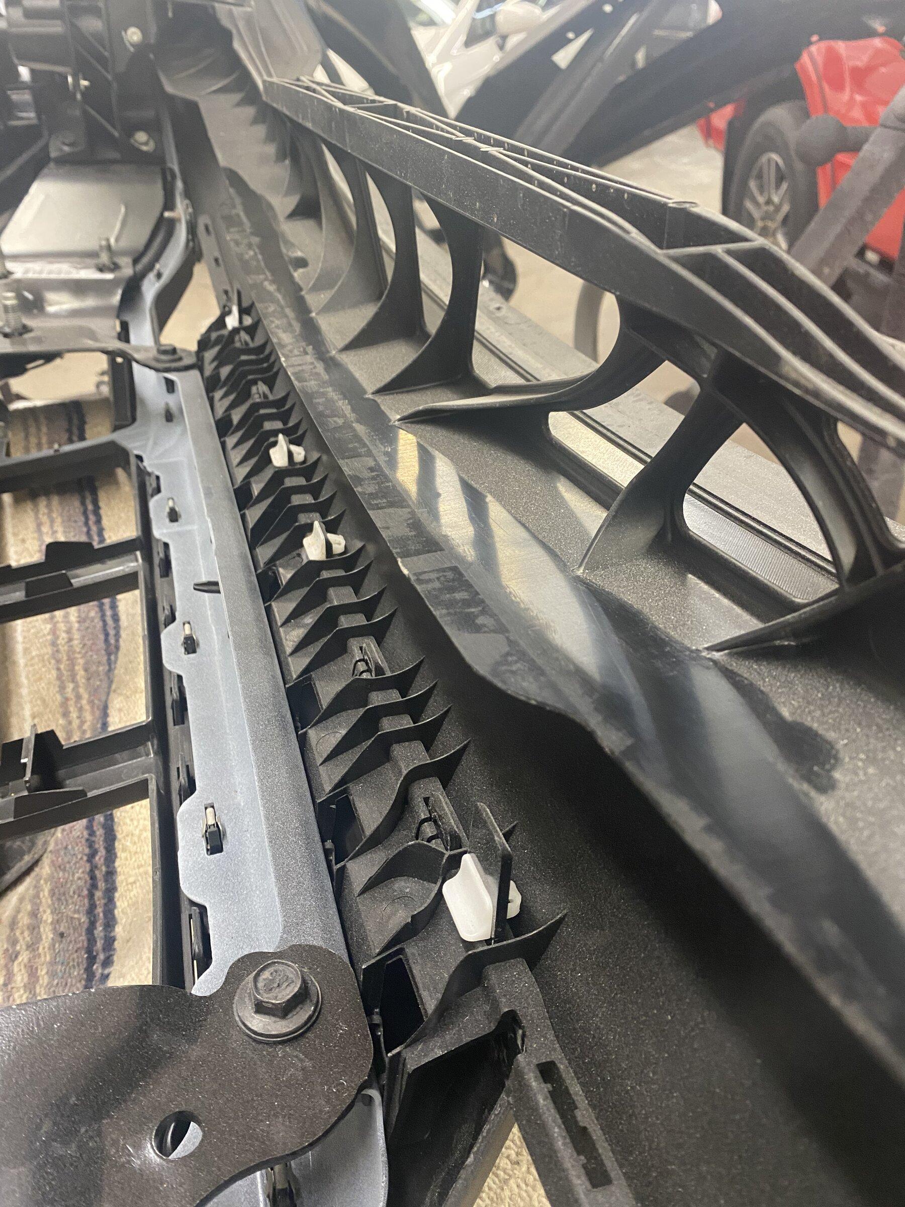

For anyone curious about an update for the lower air dam. Ford already has one. First picture is the old air dam that gets stuck. Second air dam is a replacement we received from Ford as this truck was in a collision. Notice the added length to the top.

I’ll have to go check mine. Just to close the loop on my original question… I took mine in and the dealer replaced it no questions asked. Hasn’t hung up again since but now I’m curious if I have this ‘updated’ part or not.
