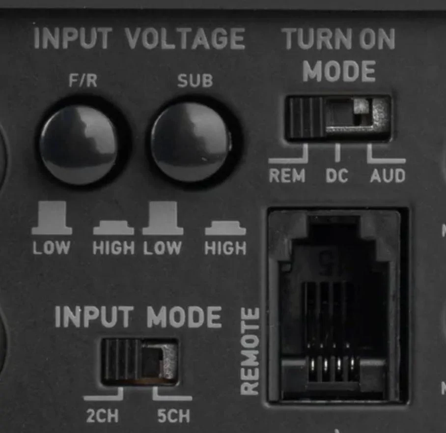

Just realized your picture is showing the V2 and I have the V1, but I still should be ok since it can also take up to 6V input.
No... It's not about voltage, it's about the type of signal (Single ended vs balanced differential). Looking at the V1, you will need a LOC to convert the signal.
