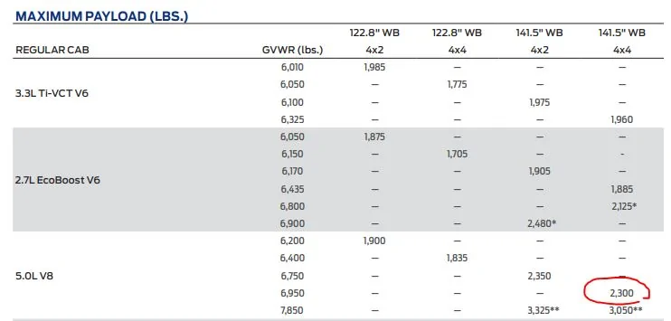

I've been thinking about my overland build and if my math is correct, I will have about #1500 of full-time payload (including driver) for the build. I couldn't find a maximum payload for MY2024 specific to each trim levels, but the technical spec sheet for MY2021 says that the RCLB 4x4 has a maximum payload of #2300. Essentially, my full-time payload will be about 70% of the maximum payload capacity. It would be nice to have HDPP to increase the payload capacity but MY24 doesn't offer that option and I'm not sure if I can find a used one with the exact cab/bed size and options that I want. I would like to hear firsthand experiences from those who have carried this much full-time payload in their trucks.
Every truck has a different max payload depending on what options are ordered.
You will never find max payload for a specific model, since it does not exists.
You need to wait and look at your door sticker when you get the truck.
There is a payload post here somewhere. Of all the stickers posted, i do not recall seeing thr same value, even on same model truck.
Fyi- i do not recal seeing anyone with a payload ar 2300 lbs...... must were under 1800. That is "dry". Before mods and people.
Mine is 1789. 22 RCSNB 4x4. 1500 of everyday payload is a lot.

Thank you all very much for your inputs.
This is the max payload info I found on MY2021 tech spec sheet.
Ford F-150 Acceptable weight for full-time payload? MY21 F150 Payload
I know these numbers are probably based on bare minimum options. But MY24 XL trim doesn't really offer a lot of options to add anyway, so my guess is I can get as close as #2300.

Assuming you wish to respect maximum approved truck capacity, table found on tech spec sheet is unreliable. Correct payload is on the door jamb sticker, and ultimately by substracting the weighed vehicle figure from the maximum GVWR. Generally speaking, when this is not exceeded, a pickup truck will behave well when loaded. Over time, suspension components will likely wear a bit faster compared to driving unloaded.

Well, with a lift and 35's, there is zero chance your payload will be 2300#. Your door sticker will be useless.
And 15mpg may be pushing it.
I have yet to see a 21 and up 5.0 F150 with a max payload of 2300#. And with a lift and 35's, you will be no where near.
24s come with more standard features. I'd be surprised if a 4x w/ no options can reach 2klbs payload. W/ full time camper the 250 will be a better fit. Not sure why you'd think the 150 would do better mileage given all of your variables are going to be close to the same.
