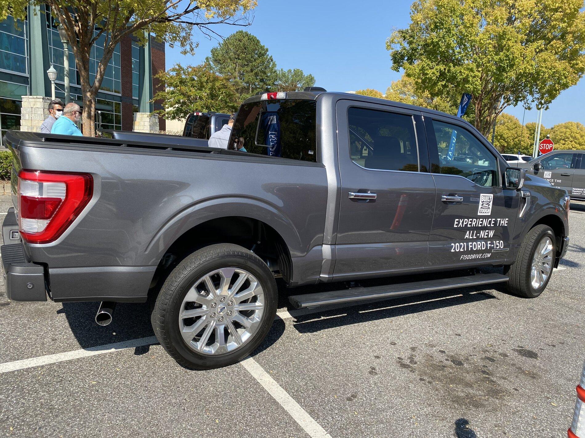

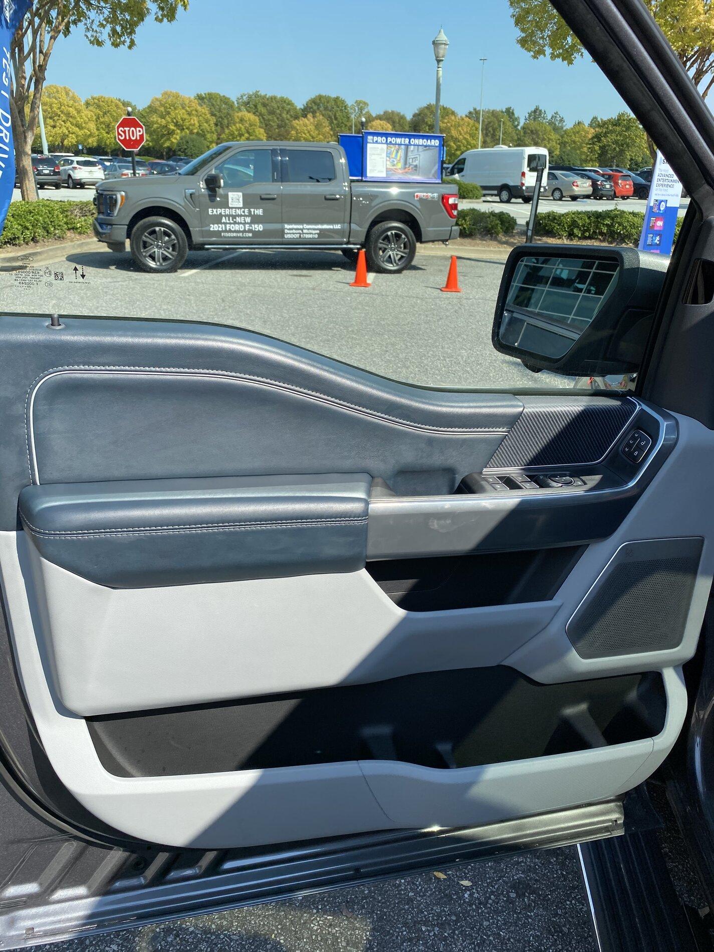

Just got back from test drive, here is the payload sticker of a carbonized gray limited.
