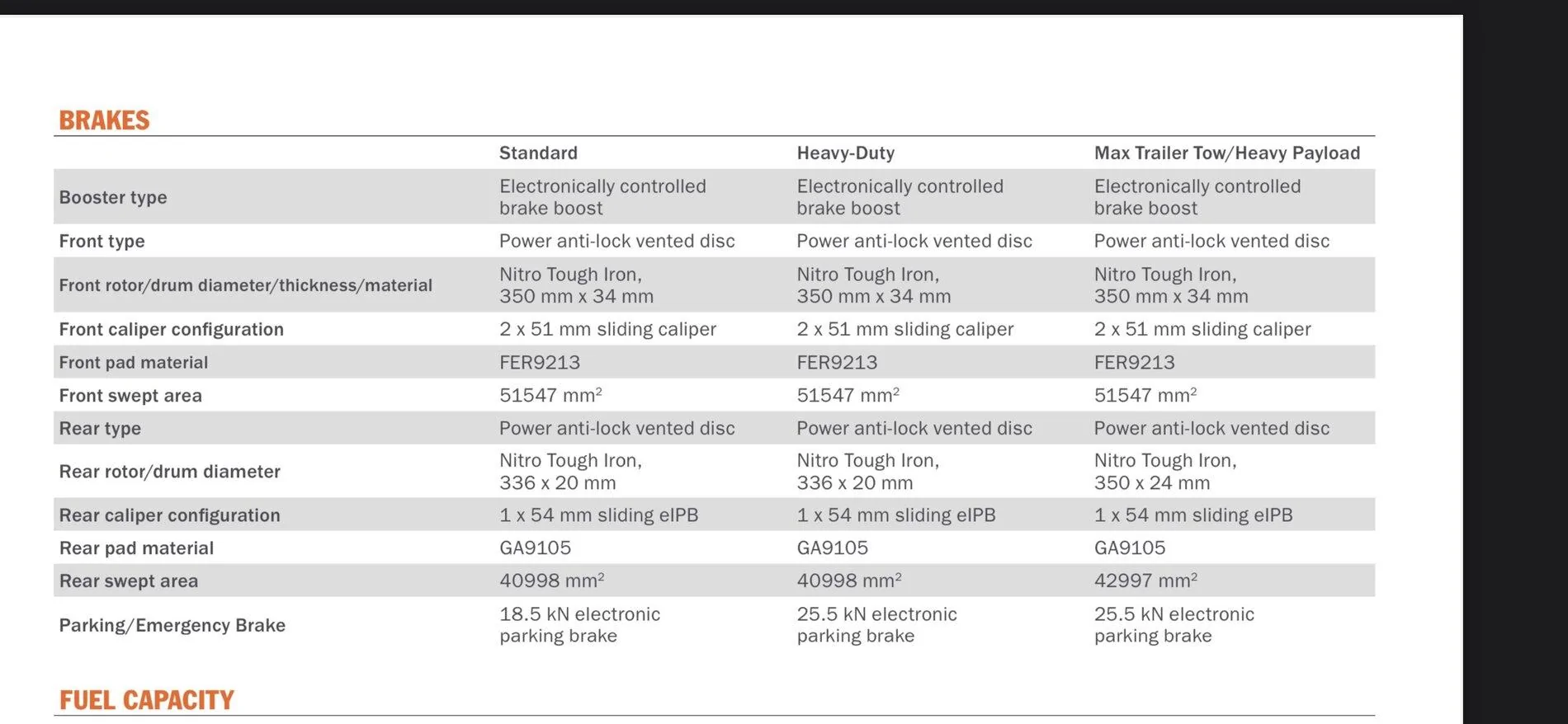

Rubicon, just wanted to be sure I’m interpreting it correctly. I think it is confirmed that the Max Tow Package will have larger rear brakes 336mm (13.2”) versus 350mm (13.8”) according to the technical specs.
Hopefully that’s correct. I want those bigger brakes!
Ever have a bunch of ideas/facts in your head and just puke them out...that was my post. LOL!
Thanks for pointing out the brake upgrade. I have been through the specs and somehow just missed that. Interesing that they don't call it out on the B&P tool.
Your Lincoln buyer is accustomed to a more well-appointed vehicle. Ford has failed twice to market a Lincoln truck, so the Limited bridges that gap and gives Lincoln customers a truck option. If you want some luxury, but also a rough and tumble towing monster, Platinum is your truck. That's my take...
