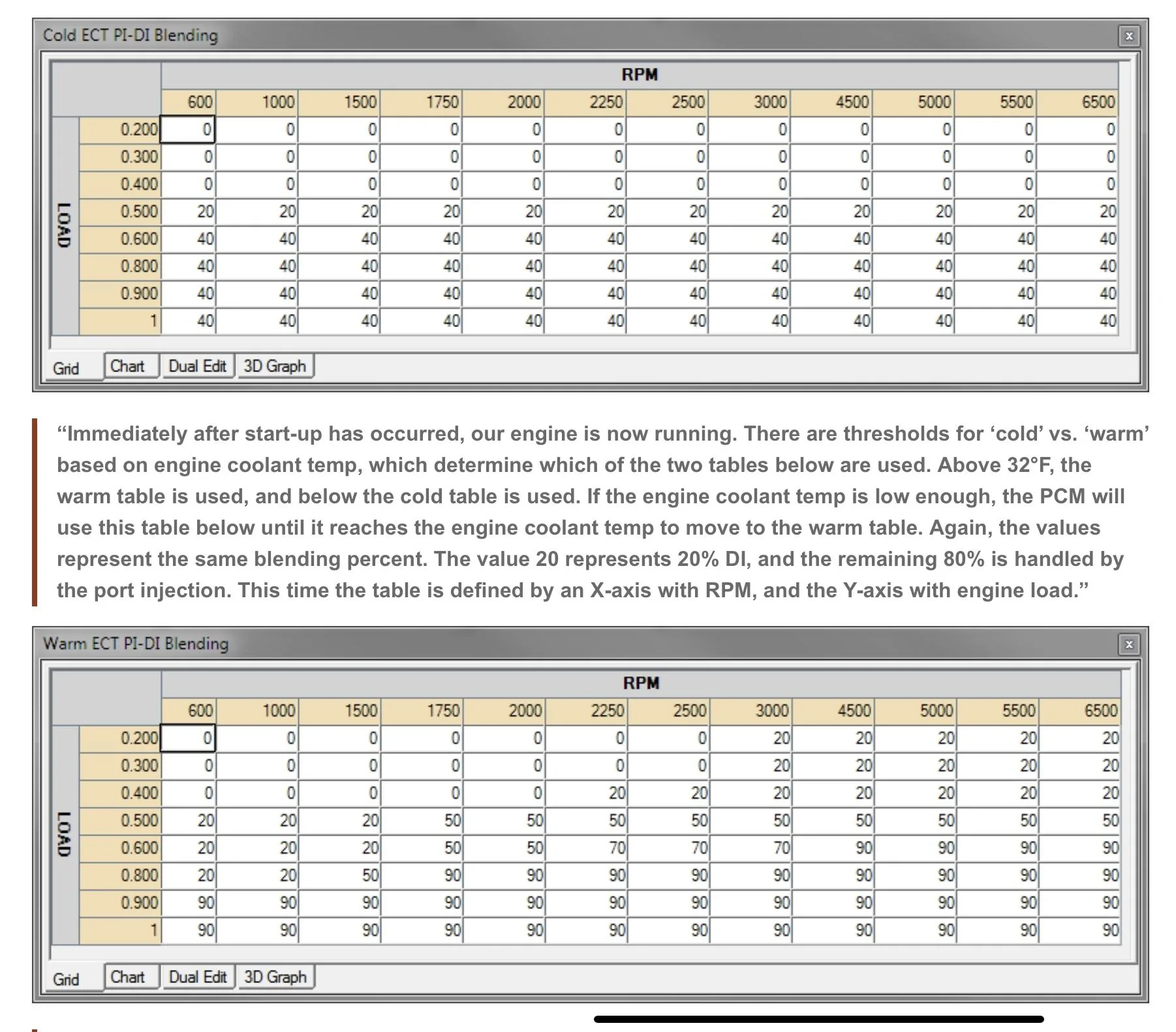

Info I have read from Ford says that the port injectors are there only to keep the valves clean and that they at most contribute 10% of fuel flow into the cylinder. Yes, the direct injectors are capable of injecting fuel at peak cylinder pressure. When someone in this discussion answers how these direct injectors are in fact used in the cylinders we will have an answer. It just doesn't make sense that Ford would go to the expense and complexity of the GDI, followed by adding the port injectors to keep valves clean, unless they were using it to change the thermodynamic cycle inherent in the engine.
Look at the pi-di tables a few comments above and you have the answer to that question. The information that you read regarding port injectors was wrong, or the interpretation of it was incorrect.
Everyone, look closely at the warm pi-di table, there are two very important points here:
1. If you go ¾ throttle from idle, 80% of your fuel is coming from PORT injection.
2. Over the entire table, there is NEVER any less than 10% Port injection.
There are many things we can glean from this. Some are:
1. An intake stroke will ALWAYS have some fuel present for the compression stroke. 10% is NOT an insignificant amount.
2. Your best intake valve/port cleaning happens at low revs, low load. Your 10R80 will let you do this.
3. At HIGH load (WOT, towing etc.), the 5.0 di system does not provide all necessary fuel to make the torque demanded at that time. We then get a LEAN mix of port-injected fuel being compressed before the di finally serves us a charge. It's that lean situation which makes anything lower than 87 too difficult for the PCM to retard.
Upshot: if you want to lug around town, or tow heavy, or go ¾ WOT to get to the next red light, your fuel economy will SUCK, but your intakes will be clean ?
