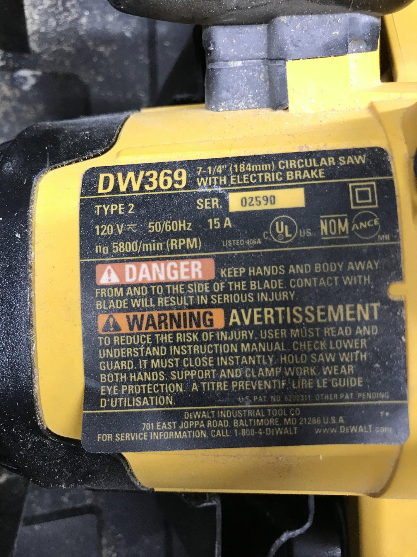

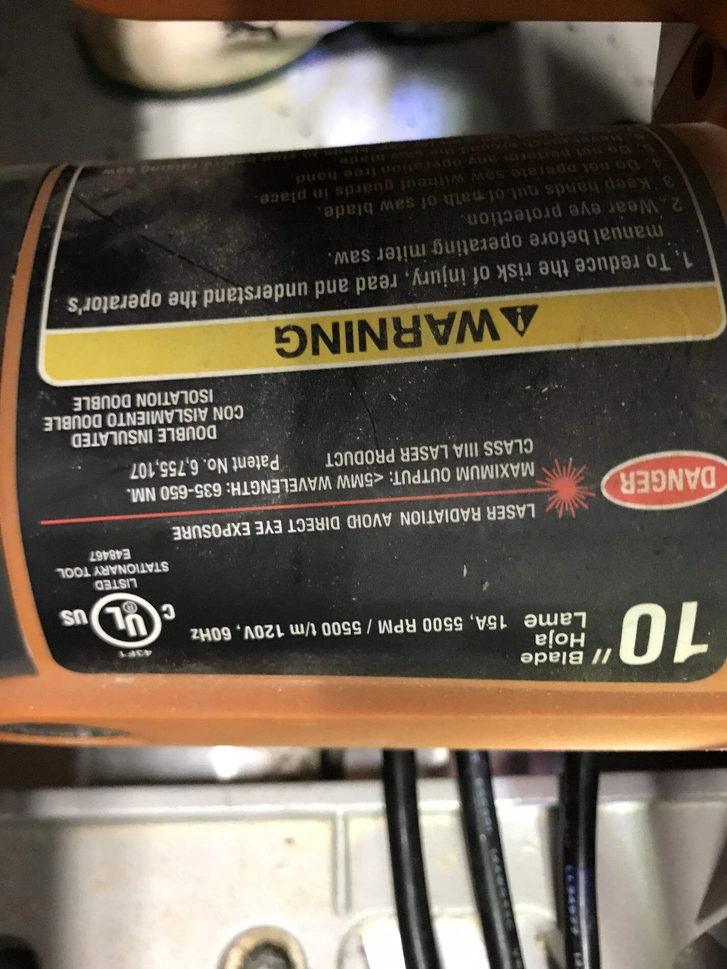

I’m afraid ‘greyhound’ might be correct, perhaps my Dewalt circular saw and Ridgid Miter saw are just too old. They’re both 15a saws but I do not know what their initial draw is. Nor do I remember how old they are. Photos of each are below.

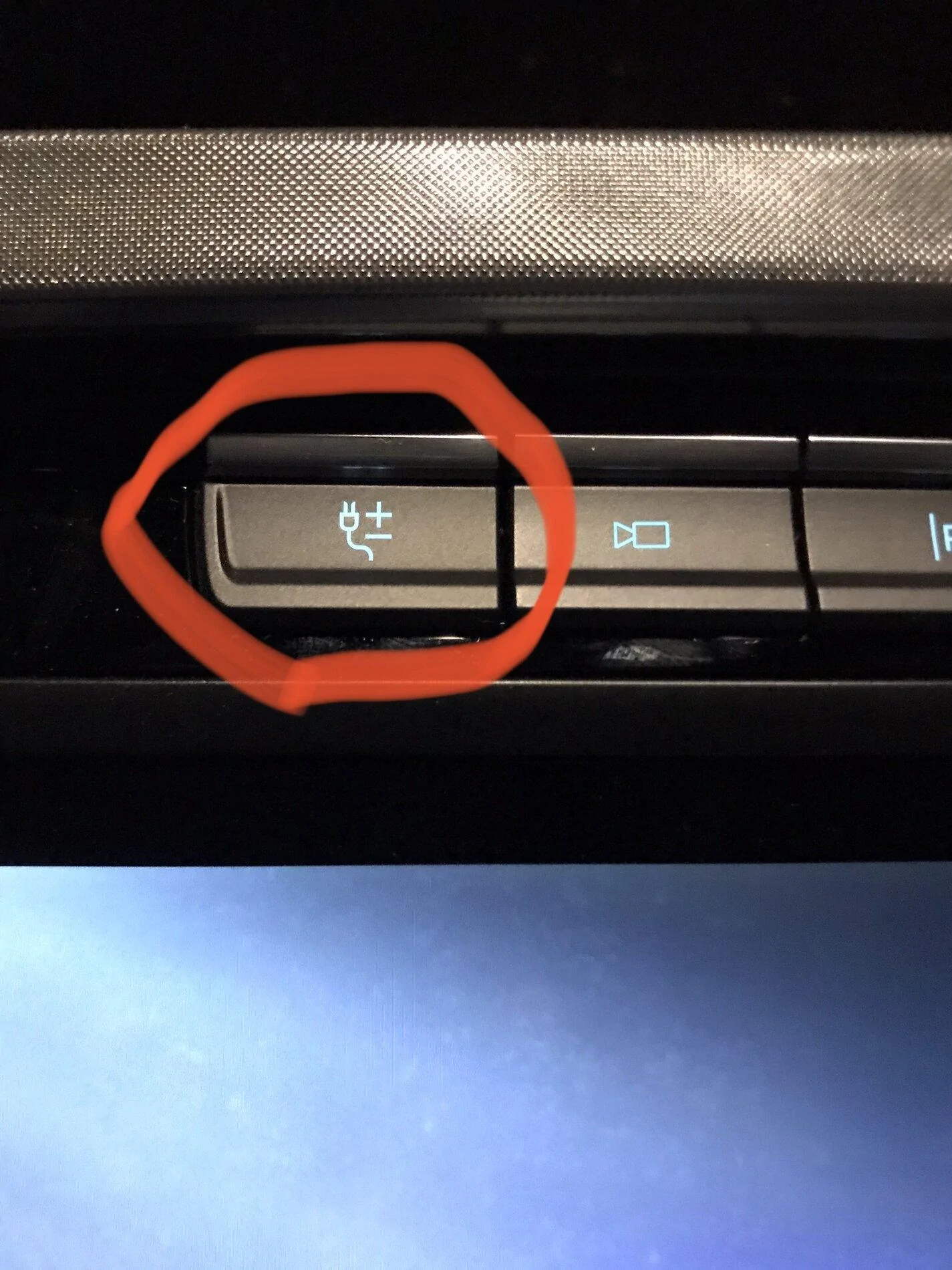

I can also confirm that pressing the button at the top of the dash is exactly the same as turning on the generator from the center screen.
