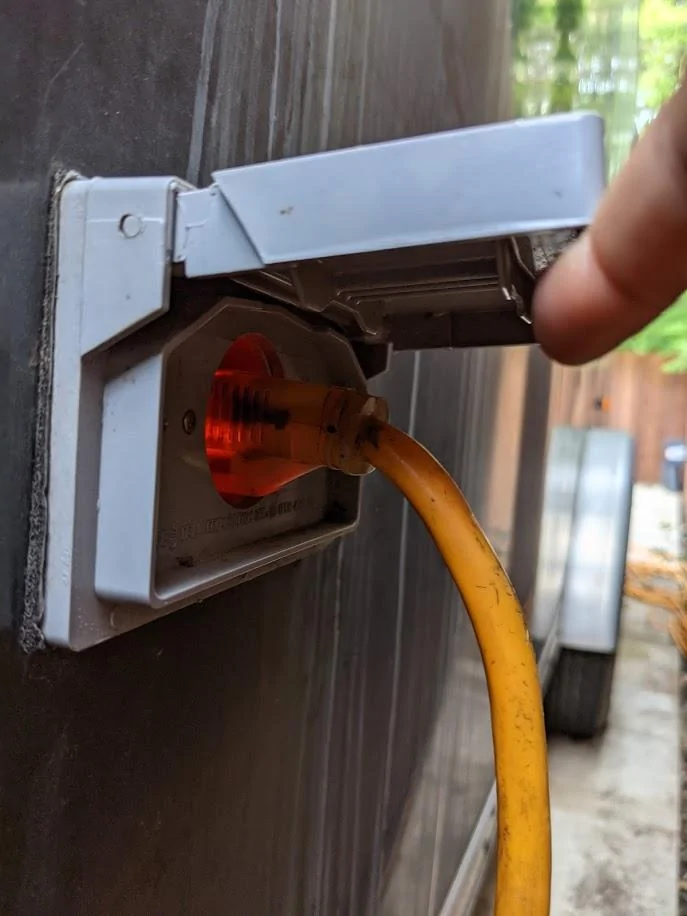

Here is the shore power input to my trailer.

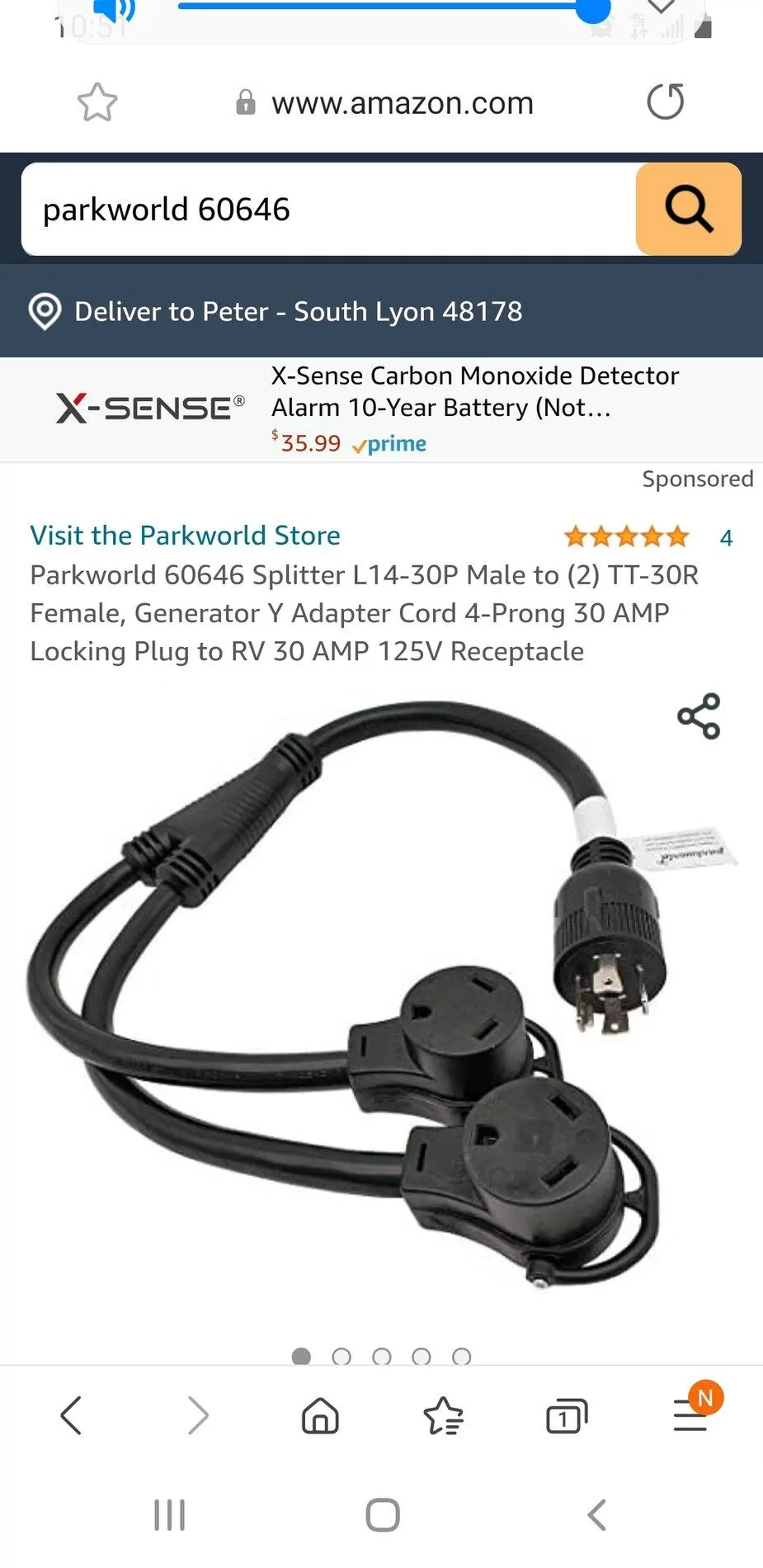

This is the cord I purchased. I just got home from a 3 day music festival in Mi. I powered my camper. It has a 15,000 btu a/c, a small mini fridge, the rv fridge, 3 fans in a tent and sound system for the campsite. My Powerboost ran this continuously from Thursday afternoon to Monday morning on about 5/8 tank of fuel. This is what I bought the truck for and it did not disappoint.
Pete
Ford F-150 Exactly what cord do I need to use the 7.2kw generator?? Screenshot_20210326-105151_Samsung Internet
Pete
That one appears to no longer be on Amazon. I grabbed a single 30TT dog bone, but then I saws this one In your post. This would be useful when boondocking with others.

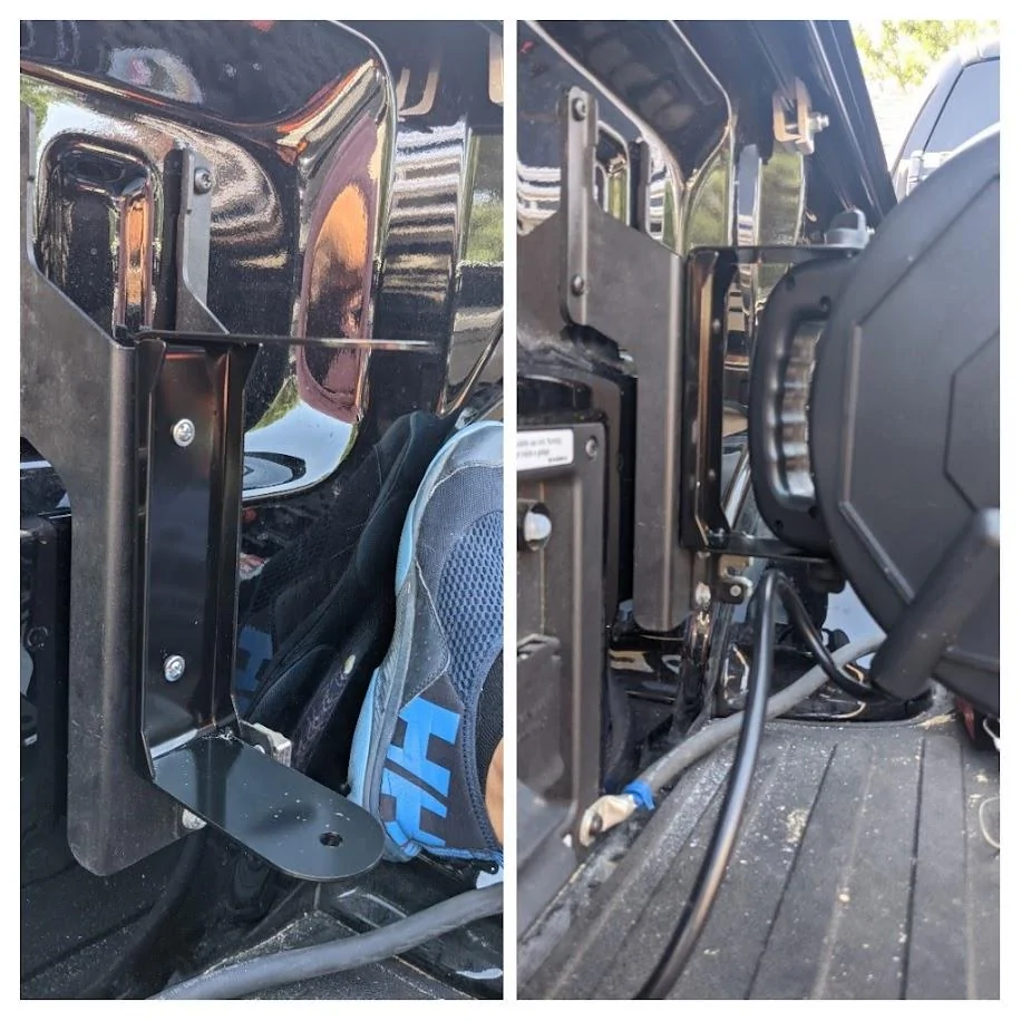

  2. I then use the 120V right below the 240 to power my tire warmers. I use this cord reel mounted to the truck for quick extension and stowaway. The 240 and 120 right below it seem to be on the opposite banks and so I don't have any issues tripping breakers.
    Ford F-150 Exactly what cord do I need to use the 7.2kw generator?? 20210725_101334-COLLAGE
Ford F-150 Exactly what cord do I need to use the 7.2kw generator?? PXL_20210725_144123433

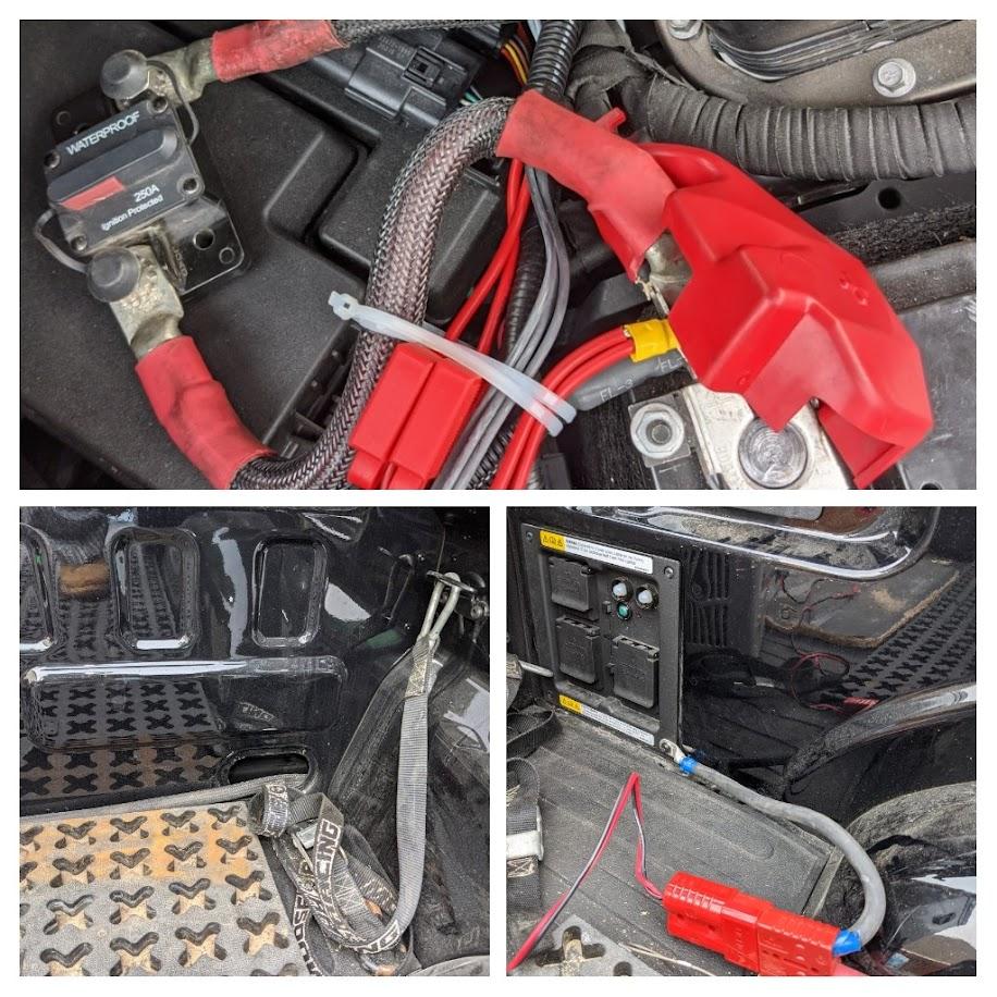

Oh, I also have an Edgestar compressor fridge wired direct to battery under the hood and grounded at the power outlets with anderson connectors.
Ford F-150 Exactly what cord do I need to use the 7.2kw generator?? 20210716_074003-COLLAGE
Ford F-150 Exactly what cord do I need to use the 7.2kw generator?? PXL_20210717_012628721
