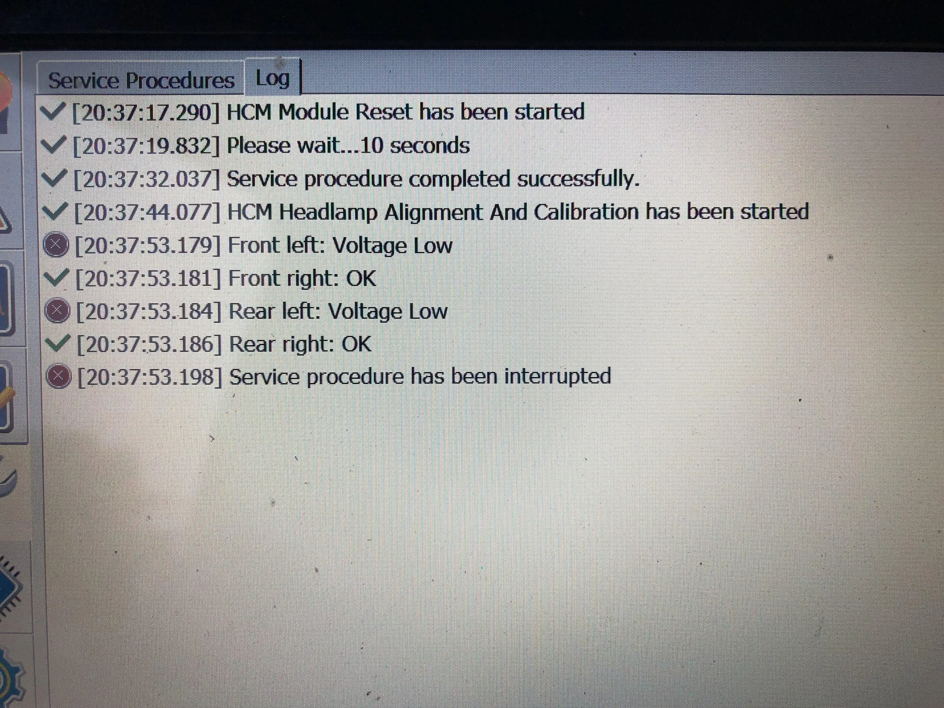

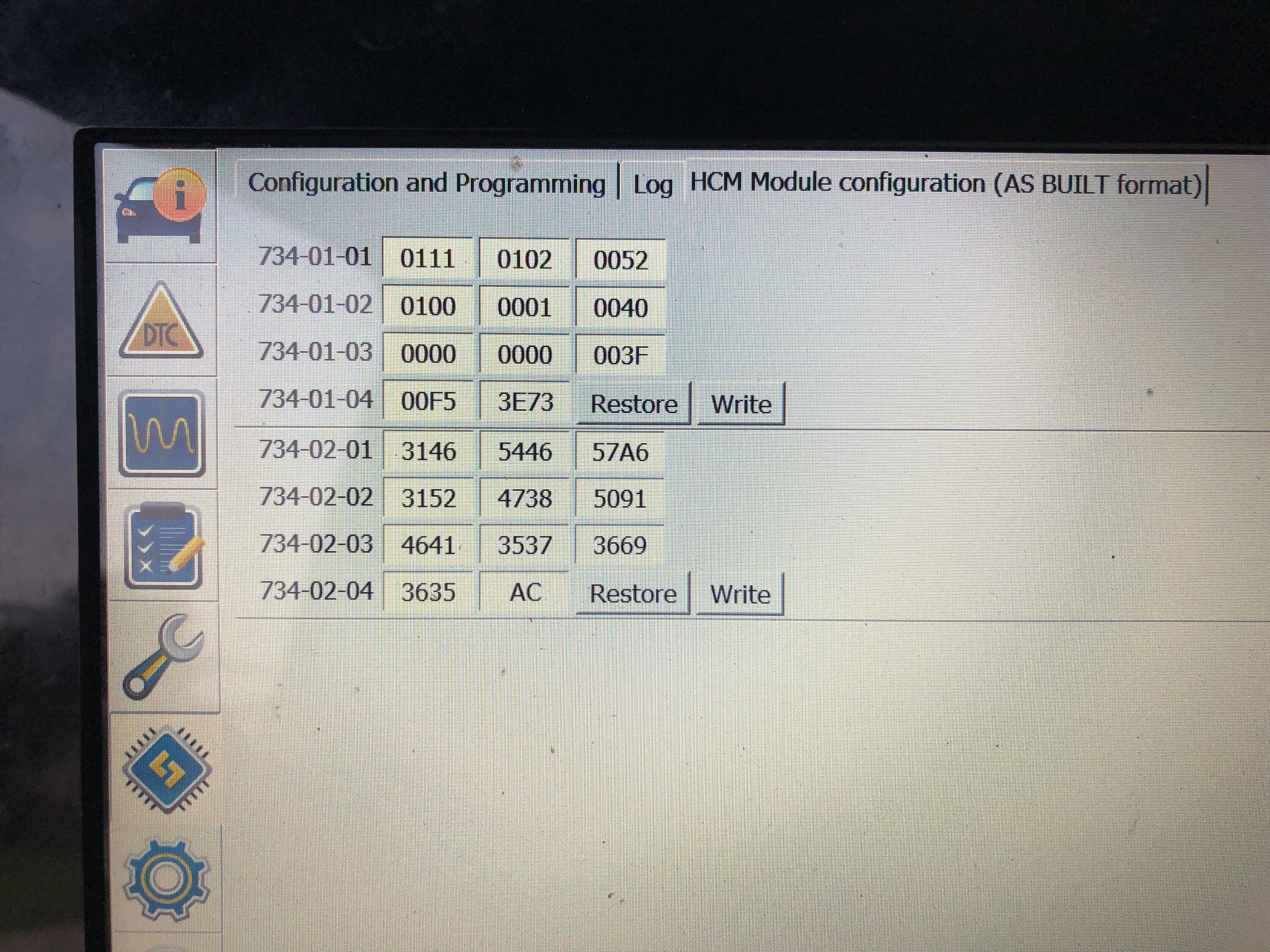

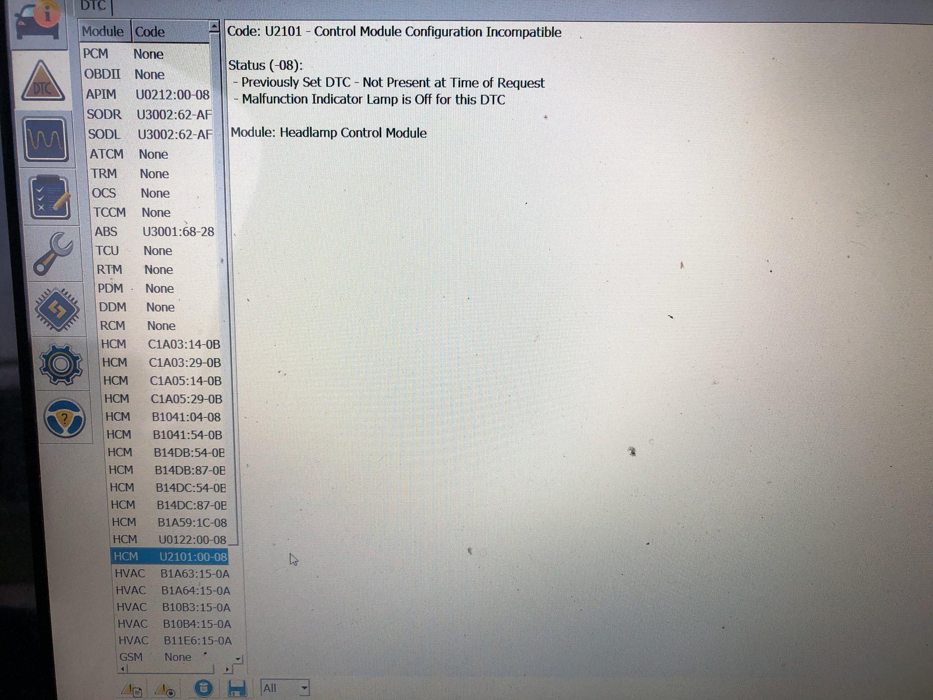

What changes do you do to the the Hcm if you don’t have level sensor or vdm.
You have to just run it with the as build as if you do have the leveling sensors or youll get a incompatible config DTC.
