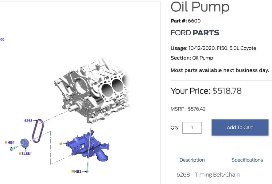

5.0 oil pump belt

Sadly, since this is the first year, only time and experience will tell.
One of the things with belts is that on most maintenance schedules, there’s both a mileage recommendation and a time recommendation, with replacement at whichever comes first. Chains are pretty much usually good for the life of the engine.
If you check the Fordtechmakuloco channel on YouTube, he describes pretty well how Ford plays fast and loose with their maintenance schedules. So don’t be surprised if you need to spend several hours if you do it yourself, or over a grand if you trust a shop to do it; when the time comes to change some belt that provides an imperceptible advantage in the short term. Pretty much every EPA mileage improvement in the last decade has been at the expense of owners and if you factor in the shorter lifespan of modern vehicles along with the added maintenance costs, along with the inefficiencies that go along with those factors, I have little doubt that more oil is being burned in the long run chasing all these new problems for the sake of satisfying a test that doesn’t recognize the real world. Kind of like the early low water usage toilets that used half the water but had to be flushed three to four times as much. It’s the law of unintended consequences.
Ford isn’t alone with this trend, other manufacturers are guilty of exaggerating their maintenance costs at the expense of longevity. Things like ‘sealed’ transmissions with ‘lifetime’ fluids, direct injection that cokes up the intake valves, cylinder deactivation that spontaneously deactivates the entire engine under 100K miles, and other concepts that are either a step backward longevity wise or simply not ready for prime time.
About the only real benefit of the newest generation of trucks is improved safety and performance.

Now I want to know why did they stop hanging oil pumps on the crankshaft?
Chains wear and stretch, belts stretch and break. While a belt may be reinforced with Kevlar, that will merely increase its resistance to stress, not necessarily make it last longer. Materials have a certain shelf life and are degraded by heat. A metal chain is much less susceptible to these factors, and in a crank mounted situation, the crank will outlast the pump.
Driving the pump straight off the crank is easy but also problematic for high RPM engines like the Coyote V8.
I can only imagine that the belt was a choice due to the fact that they are chasing every last HP and MPG out of the naturally aspirated V8.
It’s also Ford, so we know that they laboriously pinched every dime that went into building the new design; so if they saved a few bucks going with a belt over a chain in addition to improving performance, it’s an easy choice!

And if you want to see what your 5.0 oil pump belt looks like in action...

Every NHRA pro stock is running a belt drive oil pump, every cup car today at Martinsville runs a belt driven oil pump.
so it’s not like it’s new technology. I ran one for years, along with the belt driven timing Gear. I would have no concerns with the belt making 100,000 miles.
I think the key difference is that an NHRA engine has a drastically different maintenance and inspection schedule than the best maintained truck on this site. At 10 years, the entire vehicle is only worth 20 belt inspections/replacements. The old Nordberg Radials were amazing radial 2-stroke engines with a complex gear system rather than a conventional master rod. As a result, they required regular inspection. The issue was that the effort to inspect the crank gears was nearly as onerous as replacing the entire setup. Alcoa, a major user, eventually adopted the policy of simply never inspecting and just running the engines to failure and then replacing the crank gearing when it blew. That situation was arguably better because 1) those engines were in huge generator halls and losing one generator was a tiny and expected headache and 2) that failure didn't normally do more damage than bending a valve stem. The BIO setup strands you wherever you were when it hit and it's going to wipe out the motor when it fails.
So yes, NHRA and racing in general would be a great use case for a BIO timing or oiling system, but I'm not sure that recommends it for daily drivers.
