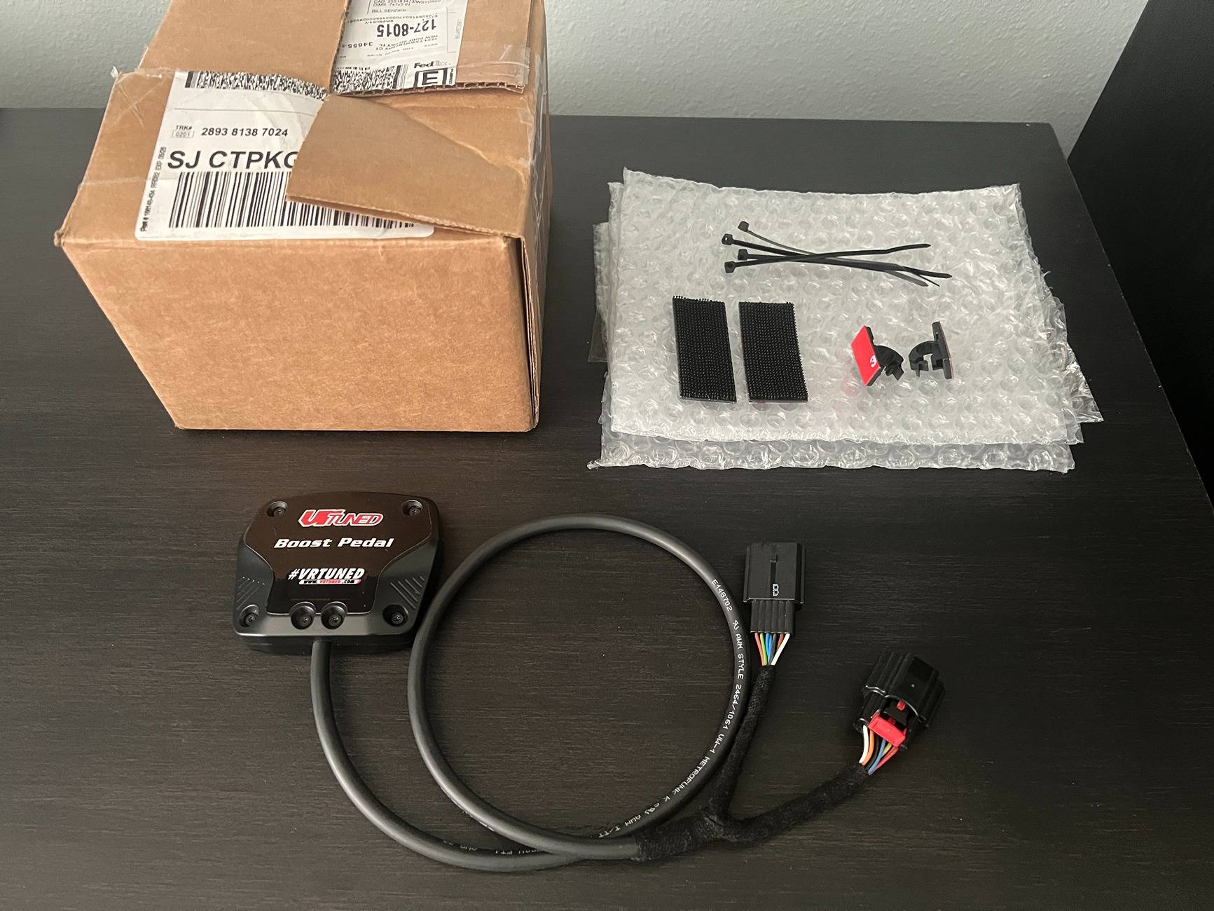

I also installed the VR tuned throttle response controller. It really improves the factory pedal delay/throttle response. The two together really change the performance and driving experience. It uses the same Pro tuning app. You can add it under the same profile and switch between both products fine tuning, and when you put it in eco, sport or race modes, both will sync up together. I'm still impressed with how much extra power / faster acceleration I'm getting from the Stillen tuner. It's night and day difference when I switch it from no tuning to race mode.

I just transferred my JB4 from a 2023 2.7 to my new 2025 PB. I assume this is basically the same piggy back tuner here. I was just happy I didn't have to buy a new one. I've also got the pedal commander throttle responder controller.
I believe this is the best setup until an actual tune is release...if ever. Doesn't look good for any 2024+ F-150 models.
Putting a pedal pusher on the PB is antithetical to the platform.
Tell us you don't understand the platform without telling us you don't understand the platform.
To each their own.
I had the pedal commander on my previous 2.7 EB. It works just fine on the PB as well. I like being able to control the pedal sensitivity. I did drive it for a few hundred miles before putting it on and it's definitely better stock that the 2.7 was. For whatever reason, I felt like I had to mash the pedal to get any decent acceleration out of the 2.7. Maybe it was just me... I already had it so might as well use it again!
