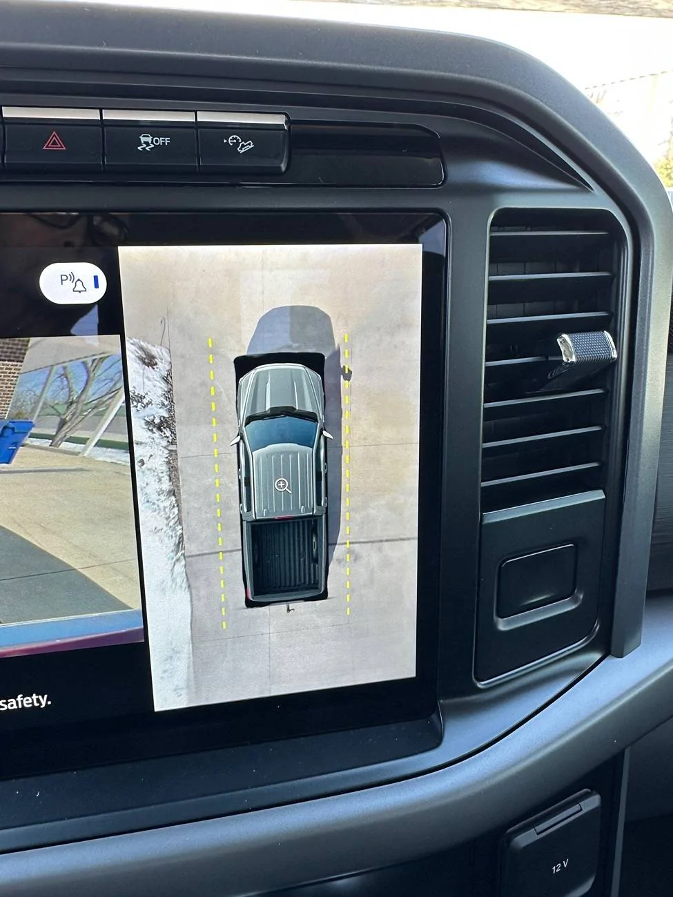

It’s been really cold here so I haven’t driven my truck since I changed out the mirrors. Today I took it out and my 360° isn’t working on the front of the truck??? Here’s a picture of my information system.

24 truck w/ 21-23 cams in them I take it? Need 24+ cams

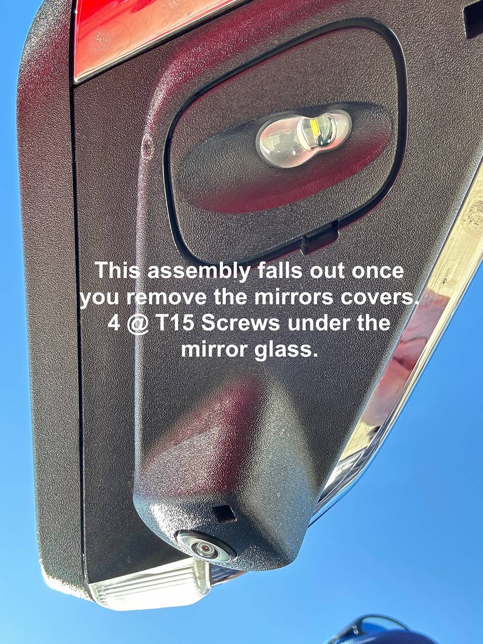

After watching several U Tube videos I removed the mirror glasses and removed the cameras. FYI All you need to do is pull on the glass and it will snap out. You can get pretty aggressive with them. Then using a T15 bit remove the outer mirror covers. The camera and puddle light assembly will just fall away from the mirrors.
Ford F-150 360 wonky after adding power mirrors phonto
I I took the whole assembly and exchanged them with my original mirror's assemblies. I read someone removed just the camera and replaced only the cameras. That involves two T10 screws and undoing the coaxial cable from the cameras.
I checked the part numbers on the Cameras, but they had the same numbers as the cameras on the folding mirrors I replaced.:crazy:
After reassembling everything:
Ford F-150 360 wonky after adding power mirrors IMG_6292
