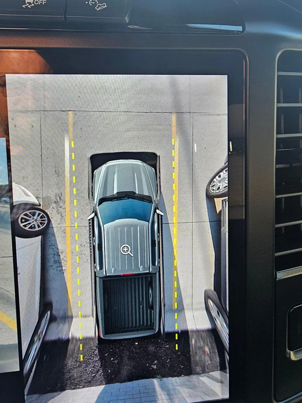

After installing Tow Mirrors I had my 360 cameras re-calibrated. I'm being told this is normal. Is the view of the parking lot lines normal? This is my third truck with 360, and I don't remember seeing blurry parking lot lines like this.

My 2022 PB XLT is in the shop (imagine that) but I can confirm that I also have the yellow dotted lines when in 360 camera view.

Nope, I do not suffer the circled artifacts (mis-alignment of painted lines and color-fade) with my system, used daily for entering parking spaces.

Yeah it was better when I installed the tow mirrors than it is now. I don't ever remember seeing this with any of my trucks.

Looks to me like the 'mosaic' (piecing-together) of front cam and mirror cam images is messed-up (front cam too narrow and / or mirror cams too wide). That'd drive me nuts.

It is.

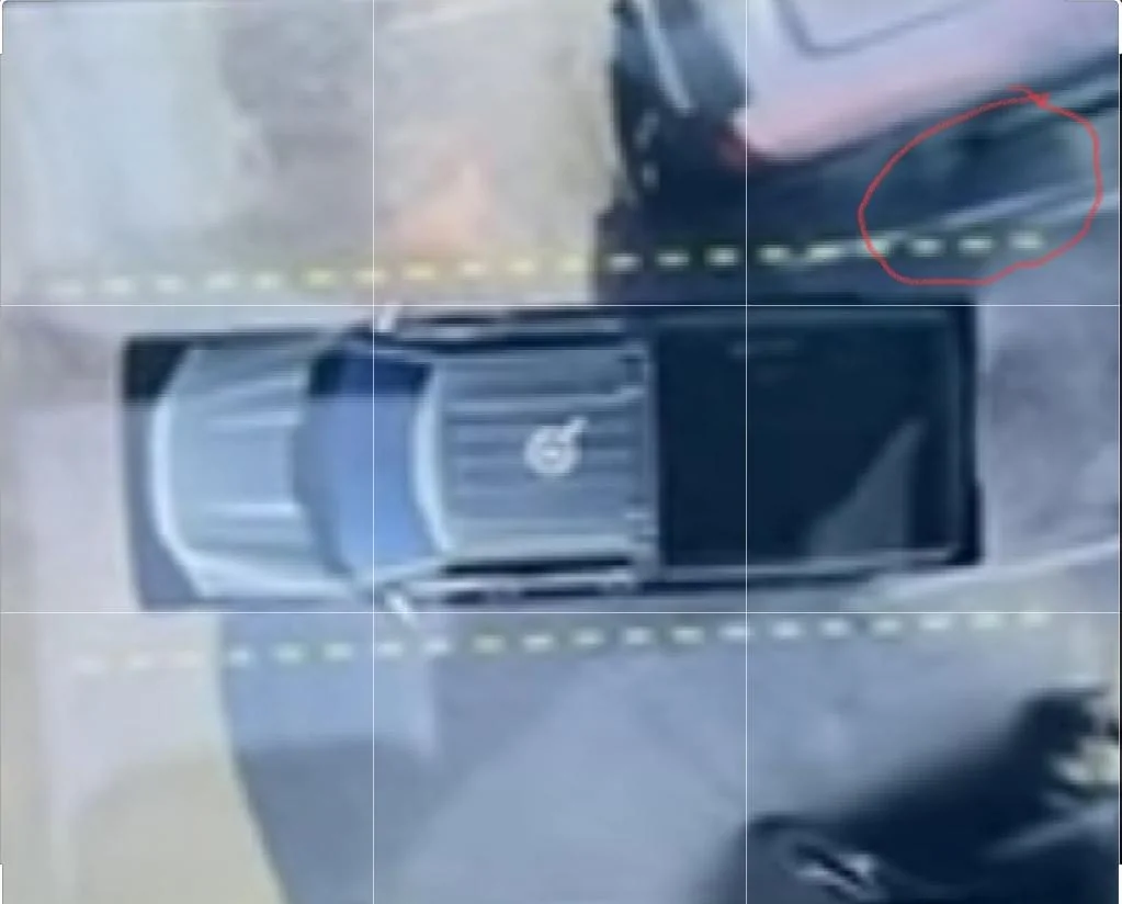

I just left the dealership. Yes so the right screen when it comes to parking lot lines will distort a little bit when backing into a spot. On a extremely sunny day the lines are reflecting and that was part of the problem with the previous pic. The contrast between the parking lot lines and the actual parking lot surface has a lot to do with it.
So don't believe everything you see on the internet. This does not mean you need a 360 calibration.

Mine is the same way. Is there a way to calibrate them through Forscan.
